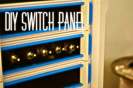

Step 1: Prepare Your Drive Bay Cover
In this step, you'll have to mark out 5 even spaces to have the same face plate as mine as I am going to have 5 switches: (PC Power, Fan1, Fan2, Fan3, Fan4).
At this point, if your cover is a mesh like the one I am using, it may be useful to just count the tiny circles (however tedious it may be) as it will give you precision. The centre of my mesh was marked out with two tiny tabs to hold in a piece of foam, so it was easy to get the middle.. I then counted 33 holes from the centre on each side but because of the mesh's jigsaw pattern, I ended up doing both holes 12 circles away from each other (instead of the 11 that it should have been).
Now that you've marked out the places that you need to drill, you'll have to go online and find the drill bit that is needed for your toggle switch. After a little bit of searching, I found that my toggle switch needed a drill bit size of 1/4" or 0.25".
Step 2: Drill & Insert
Now that you've marked out the spaces required and have found the drill bit needed, it's time to drill out the holes. WARNING: REMEMBER TO DRILL WITH THE MESH ON TOP OF A FLAT PIECE OF WOOD, IF YOU DON'T THEN THE HOLE WILL BEND OUTWARDS.
Now that you've drilled everything, you'll need to go get your switches and push them into the holes and line them up so that the switch will be straight, remember: not all switches will be lined up with the base for the switch.
