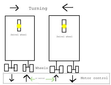

Had to make special adapter plates to connect the wheel assemblies to the cart. Originally I used clear plastic, but those broke too easily. Wood worked much better, but not as pretty. Attached a third generic card wheel.

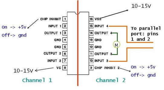

Step 4: Control
Made a special wiring hardness to connect the parallel port with the
control electronics. Now I need to start testing the electronics for the motor control. Hoping the h-bridge can take the current. If not, I think I have a IC that will. Worst case scenarios is to do it the old fashion way with transistors. After that, everything should fall into place.
https://www.instructables.com/id/Mini-parallel-port-break-out-cable/
https://www.instructables.com/id/No-solder-parallel-port-break-out/

Step 5: Powertrain
Code to control the motors has already been tested ( using parcon.c)
and is working. Using a hardwired connection, already tested client/server socket programming to communicate with and control the unit. That should be way more efficient and possibly more secure than using a web server per se..
Powered wheels came from two Tonka RC cars that I dissected.

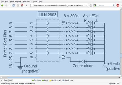

While true% ' set or reset values ' input sensor values ' Other jobs ' Do what is needed based on input values. wend Part I. Set or reset values. Part II Get sensor values. Reading the Input pins
The command to read from ports in qbasic is INP. The address you need to read from is the address of the parallel port (usually 378h) + 1; so the usual address is 379h. As i mentioned before, the pins used for input are 10-13 and 15. Reading the different pins is little harder than writing to the ports, as you have to mask out the pins your not interested in. When you read the port, the first 3 bits returned are not used. For example, the qbasic code below would read pin 12 (out of paper). When this port is high, "Out of paper / pin 12 toggled" will be displayed: data = inp(&h379) IF (data and 32) = 32 then print "Out of paper / pin 12 high" The table below list the pin input pin number, its normal purpose, and the number required to read it (eg 32 was used in the above example): Pin Number Normal Purpose Number to read 10 Ackowledge 64 11 High when not Busy 128 12 High when out of paper 32 13 High when printer online 16 15 High when no error 8
If you understand binary, you should immediately see where these numbers are coming from, and why they are used to mask out all of the other pins we aren't trying to read. The simplest thing you can use to test this is to just connect a switch between an input pin and a ground pin (18-25). For example, if you connect a switch between pins 15 and 20, you could use the following code to monitor when the switch is pushed: start: res = INP(&H379) CLS IF (res AND 8) = 8 THEN PRINT "Button pushed" ELSE PRINT "Button NOT pushed" FOR delay = 1 TO 500: NEXT delay GOTO start I know this code is a little messy, and will flicker, but it's written for clarity. The same code can be used to monitor the other four input lines by changing to the '8' to another number from the table. Part III Other jobs. Part IV We can use programs such as parcon to set values at the parallel port for such jpbs as controlling the power train. see also: https://www.instructables.com/id/Mini-parallel-por... https://www.instructables.com/id/Mini-parallel-por...
Portcontrol is a nice program for reading data and writing data to the ports available at:

The software is now installed to /usr/local/sbin/ directory Using lptout
The user has to have the root previledges to have access to the ports for the program to run. For this reason the the program is installed with SUID ROOT settings, meaning that every time the program is run it is automatically run at root previledges no matter who runs it. This program is designed to access LPT1 parallel port at I/O address 0x378 (normal address for parallel port integrated to motherboard)
For example command /usr/local/sbin/lptout 0xFF will turn all data pins in LPT1 port to high state (1). Command /usr/local/sbin/lptout 0x00 will turn all data pins to to low state (0).
