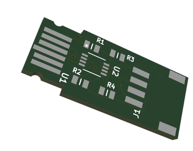

Introduction: PCB Adapter: LEGO Bricks to Grove Sensors
This guide will walk you through the steps and materials needed to fabricate a PCB that can connect your LEGO Brick to Grove Sensors to expand the possibilities of your projects!
Step 1: Order PCB
Find and use the grove_gerb zipped folder that contains the gerber files for this PCB in this Github repository to download and order the printed circuit boards. Ensure the thickness is 1.6mm when ordering.
Step 2: Laser Cut Acrylic
Use the grove_laser dxf file in this Github repository to laser cut the second layer of the adapter. Ensure the acrylic is 1/16in (~1.6mm).
Step 3: Super Glue PCB & Acrylic
Use superglue to glue the final laser cut acrylic you obtained in step 2 to the PCB. Ensure they are properly lined up, otherwise it will not fit in the LEGO Brick. This should make the thickness 3.2mm, which is the needed thickness for the LEGO Brick's socket.
Step 4: Solder PCB
Due to the small size of the electrical components that need to be soldered, solder paste allows for the most ease.
Place solder paste on the pads on the PCB and place the components on the PCB (ensure the chip is oriented so the 2A text on top of it is on the side closest to the Grove connector) Using the heat gun, heat up the solder paste to solder all components on the PCB.
Step 5: Connect PCB & LEGO Brick
Connect the adapter PCB to Port A in the LEGO Brick, and attach the Grove sensor to the PCB, as depicted in the photo.
