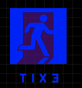

Step 3: Designing PCB Art
Understand the structure of PCB, then you can start designing PCB Art. I used the free software EasyEDA, which is free to use, just run in the browser, and if needed, there is an offline desktop application.
I drew an exit sign, do you know what layer combination I used
