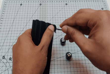

Step 3: Rubber Feet Assembly
Attachment of rubber feet at corners of the frame

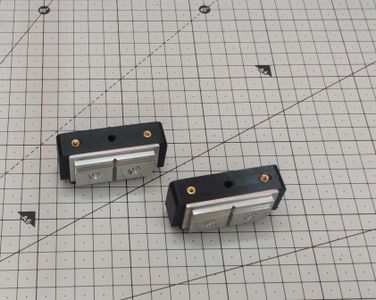

Step 4: Jaw Assembly - Brass Inserts
Brass Inserts assembly with a soldering iron heated to 200+ degree Celsius

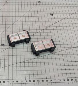

Step 5: Jaw Assembly - PCB Holder
Assembly of PCB holder with M3 x 10 mm bolts to both the Jaw
PCB holder used here is machined in aluminum, this part also can be 3D printed (For best results. 100% infill and High quality recommended)

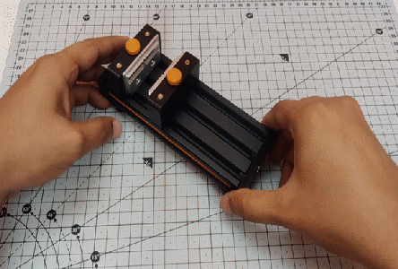

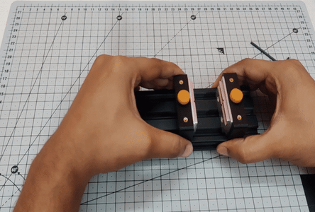

Step 6: Frame and Jaw Assembly
Add M4 x 30 mm through the jaw from top to T-NUT
Fasten 1 or 2 thread of the T-Nut to the M4 x 30 mm bolt in the Jaw before assembling into the frame
Align the T-Nut with other 2 guides and slide inside the slots of the frame
Add the Knobs to the hex head and fasten a bit to secure the T-Nut
Step 7: End Cap & Strip Assembly
You could use self tapping screw or tap the hole in the frame (M5) for best results
Slide in the slider 3D printed parts
Secure the end cap with M5 x 10 mm bolt to the frame
Add the end caps to both the sides to prevent the jaws sliding out of the frames
Step 8: In Action
