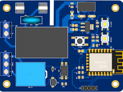

In this article you will learn how to create a circuit capable of activating various devices in your home via the internet. Below we have an image of the electronic board that we will make available for you to transform your home into a smart home. Download now the project files
Let's get started and learn how each circuit block on this electronic board works.

From this circuit, the electronic design of the printed circuit board below was developed.
1 / 2
Using this electronic board, you can develop countless applications and connect your home to the internet.
