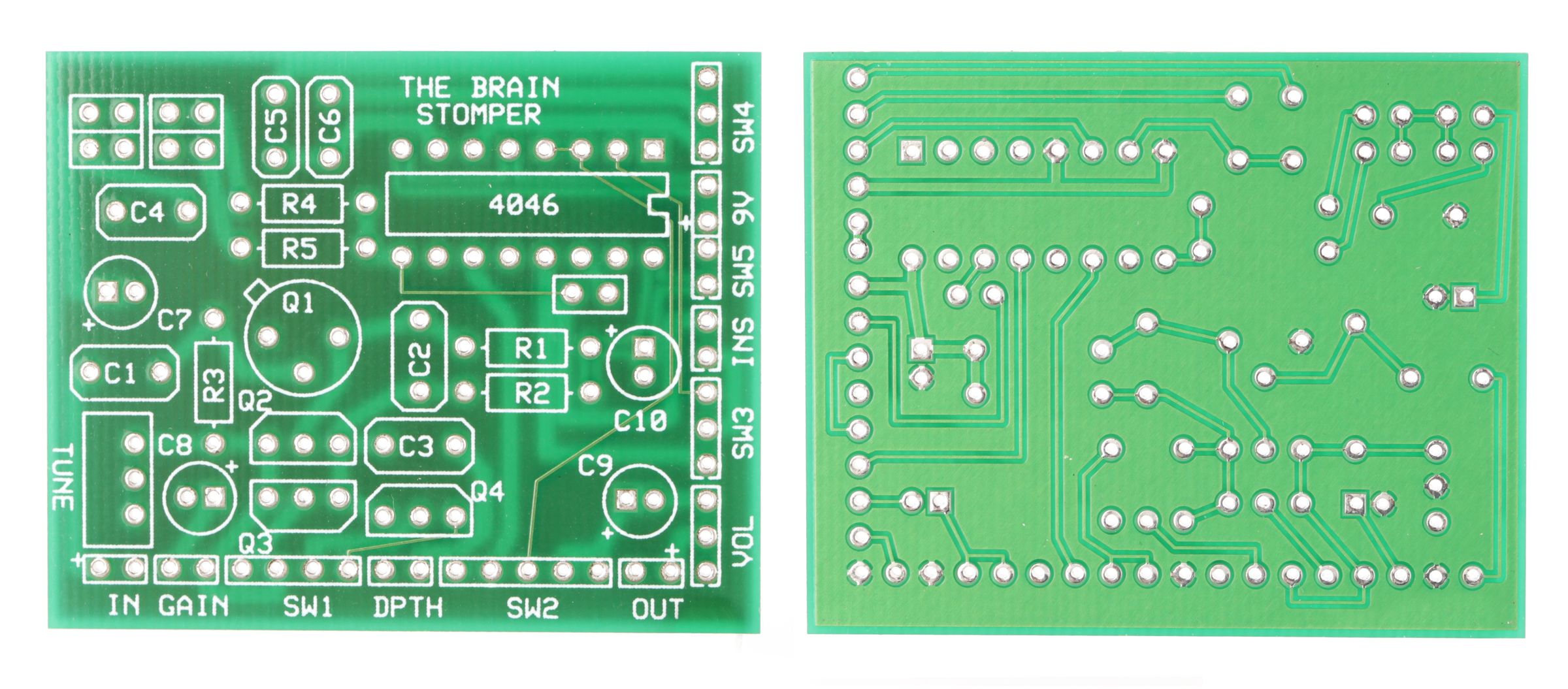

PCB stands for "Printed Circuit Board." This is the standard circuit board you will find inside of most electronic consumer products.

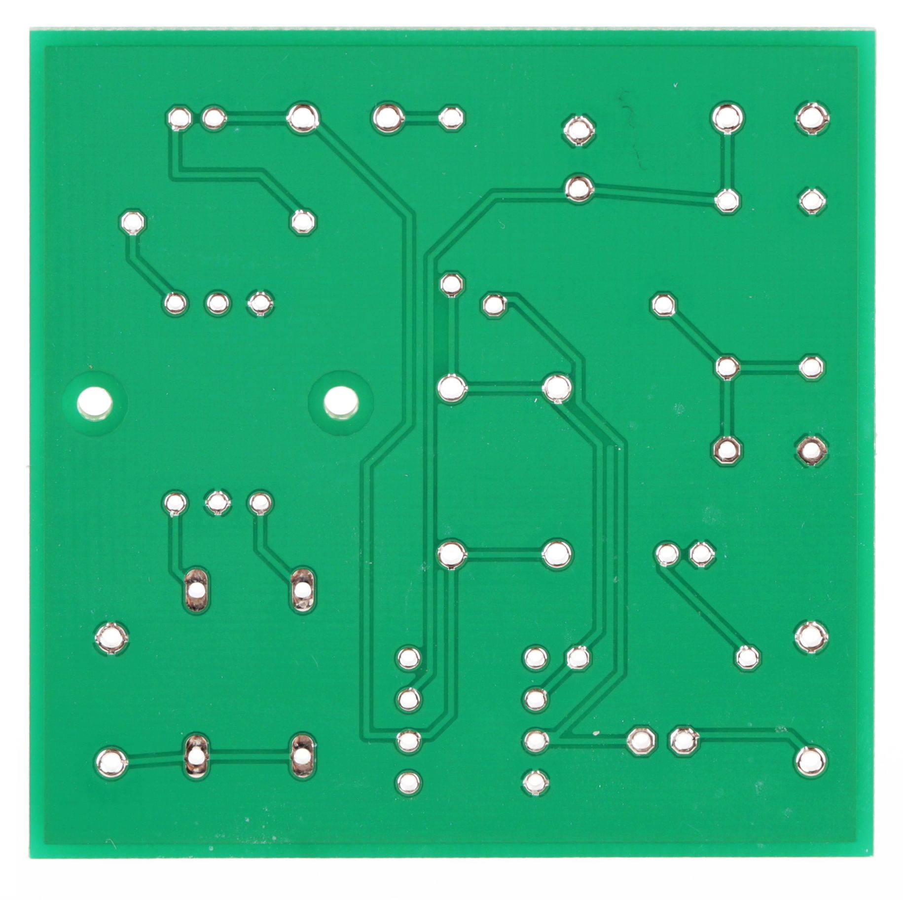

A PCB consists of a fiberglass board with conductive copper pathways or traces that connect together electronic components that are soldered to them. The totality of connections between components is what constitutes the circuit.

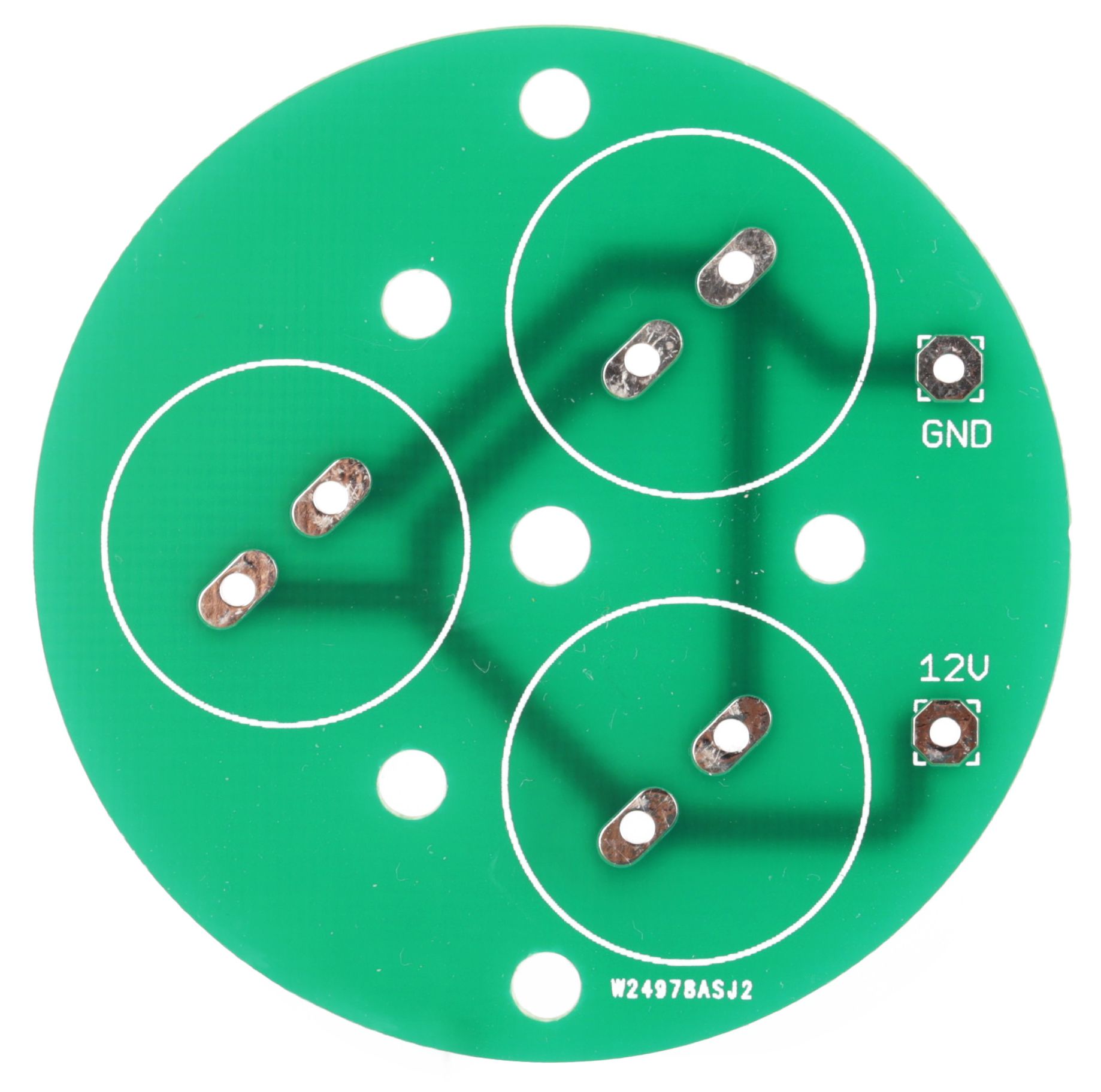

A standard circuit board has 4 layers that we need to concern ourselves with. This includes the base, copper layer, soldermask and silkscreen layer.

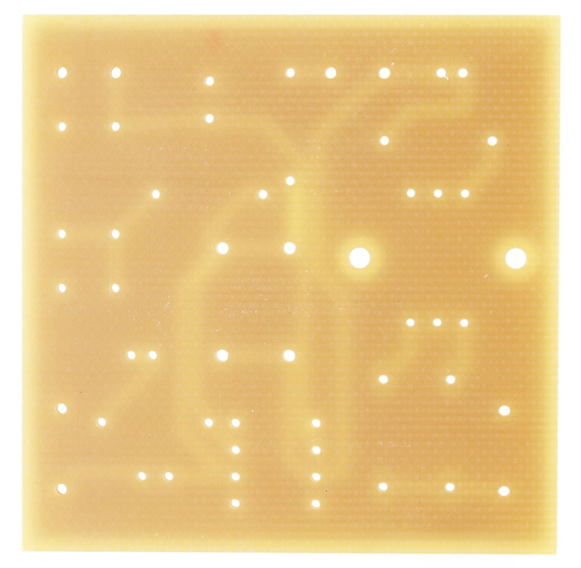

The circuit board's base is typically made out of a type of fiberglass called FR4. This material provides rigidity, and has good heat resistance properties. Thicknesses vary from board to board, but 1.6mm is fairly common.

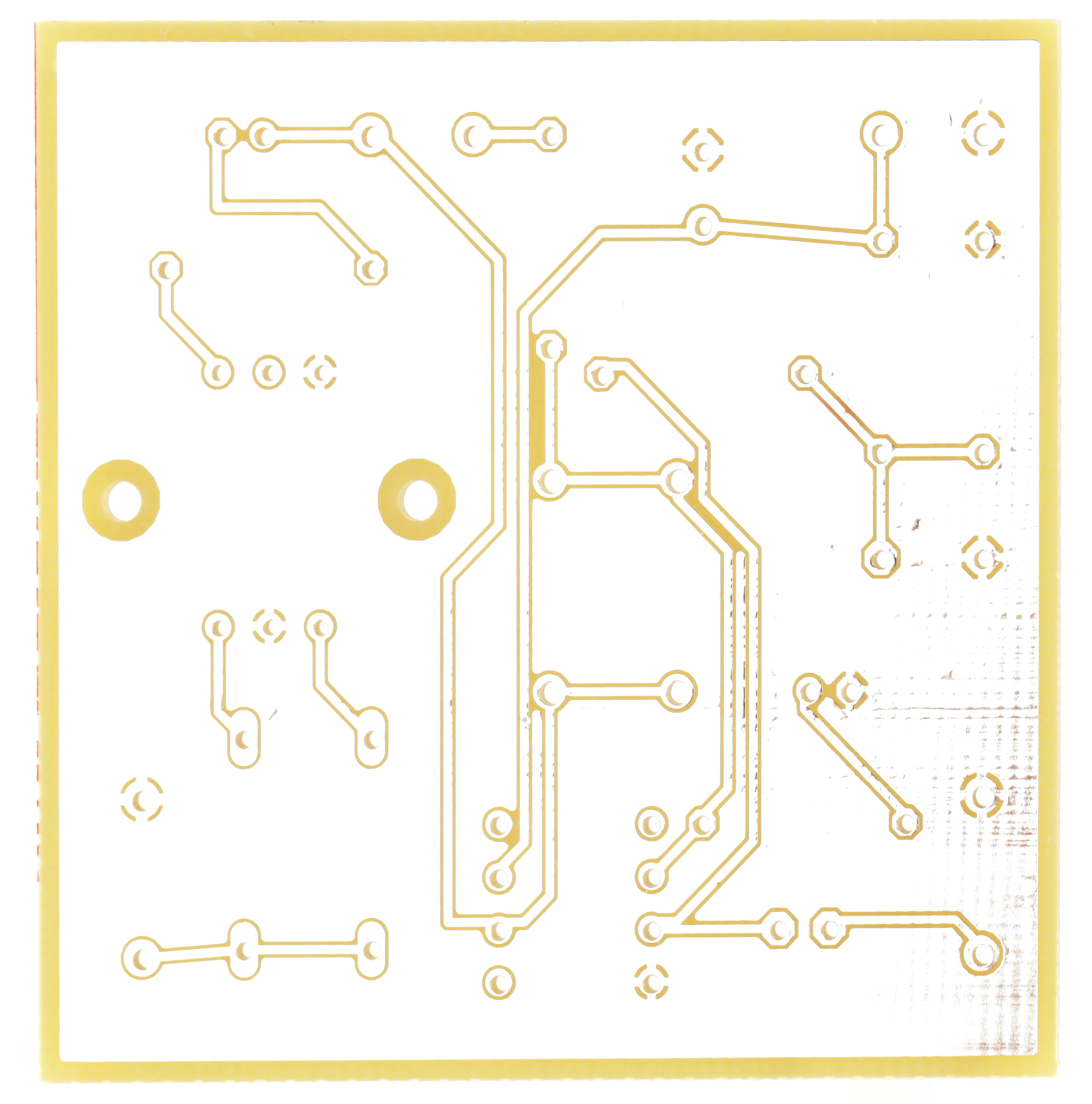

The copper layer is laid atop the fiberglass base (making the base "copper clad"). This is the layer that conducts electricity and the circuit's components are soldered to. All of the circuit's connections occur on the copper layer.
The soldermask is a layer of colored resin strategically laid over the copper layer to insulate the parts of the circuit that do not get soldered to. Typically the soldermask is green, but it can be all kinds of different colors.
The silkscreen layer is printed atop the soldermask and serves as a guide for assembling the board.
Typically, a circuit board will have two sides, which means there will be a top side and bottom side. Each side can have all four of these layers, but the bottom often excludes a silkscreen layer since it is often unnecessary (which also reduces manufacturing cost). This 2-sided arrangement is fairly standard and the board we will design in this class will be like this.

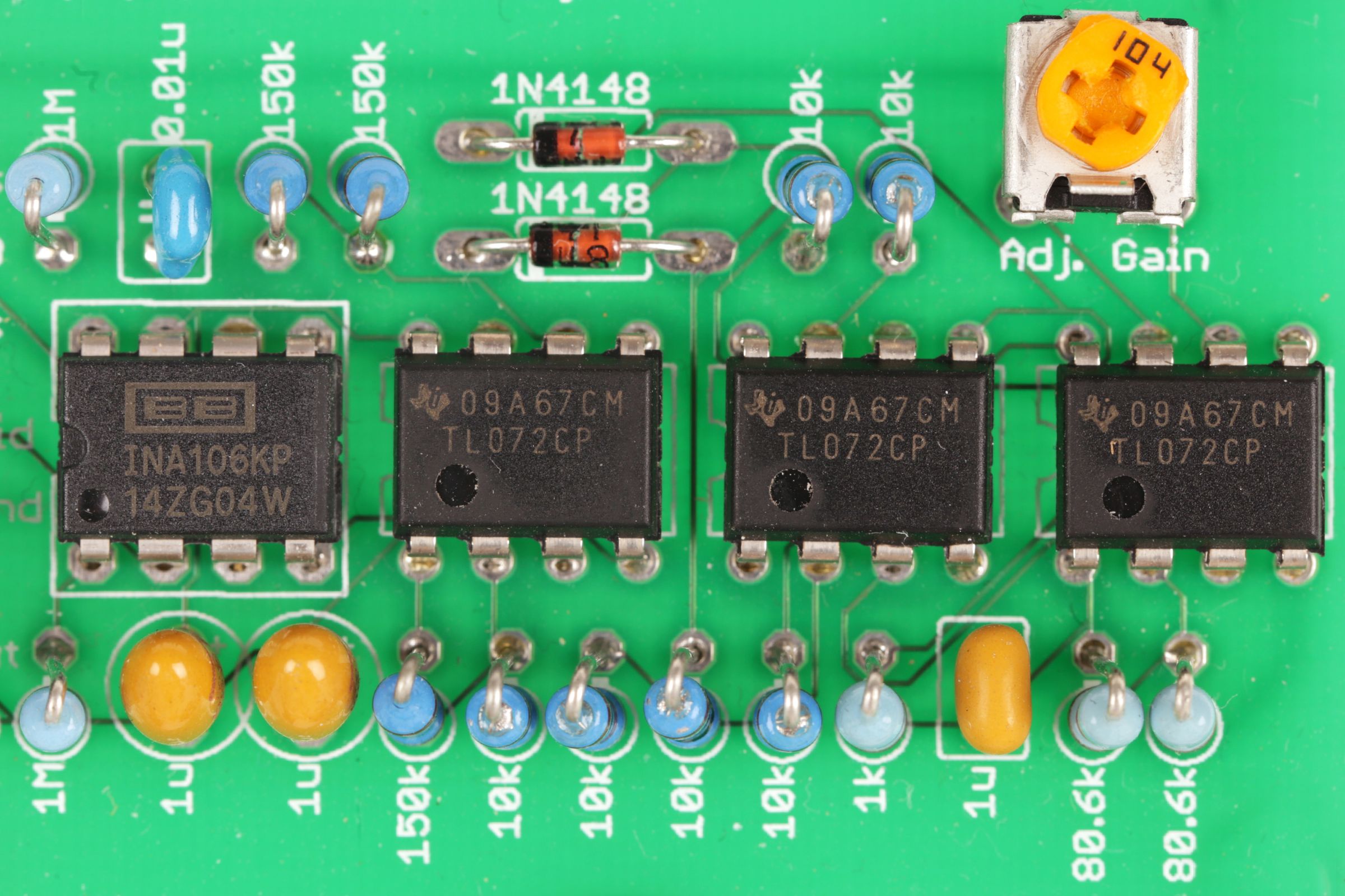

The type of components we will be using to build circuits in this class use through holes. These are round metal plated holes that serve to both connect the top and bottom copper layers together, and give you a surface to solder the component to the board. In this class, I will be dealing exclusively with through-hole parts.

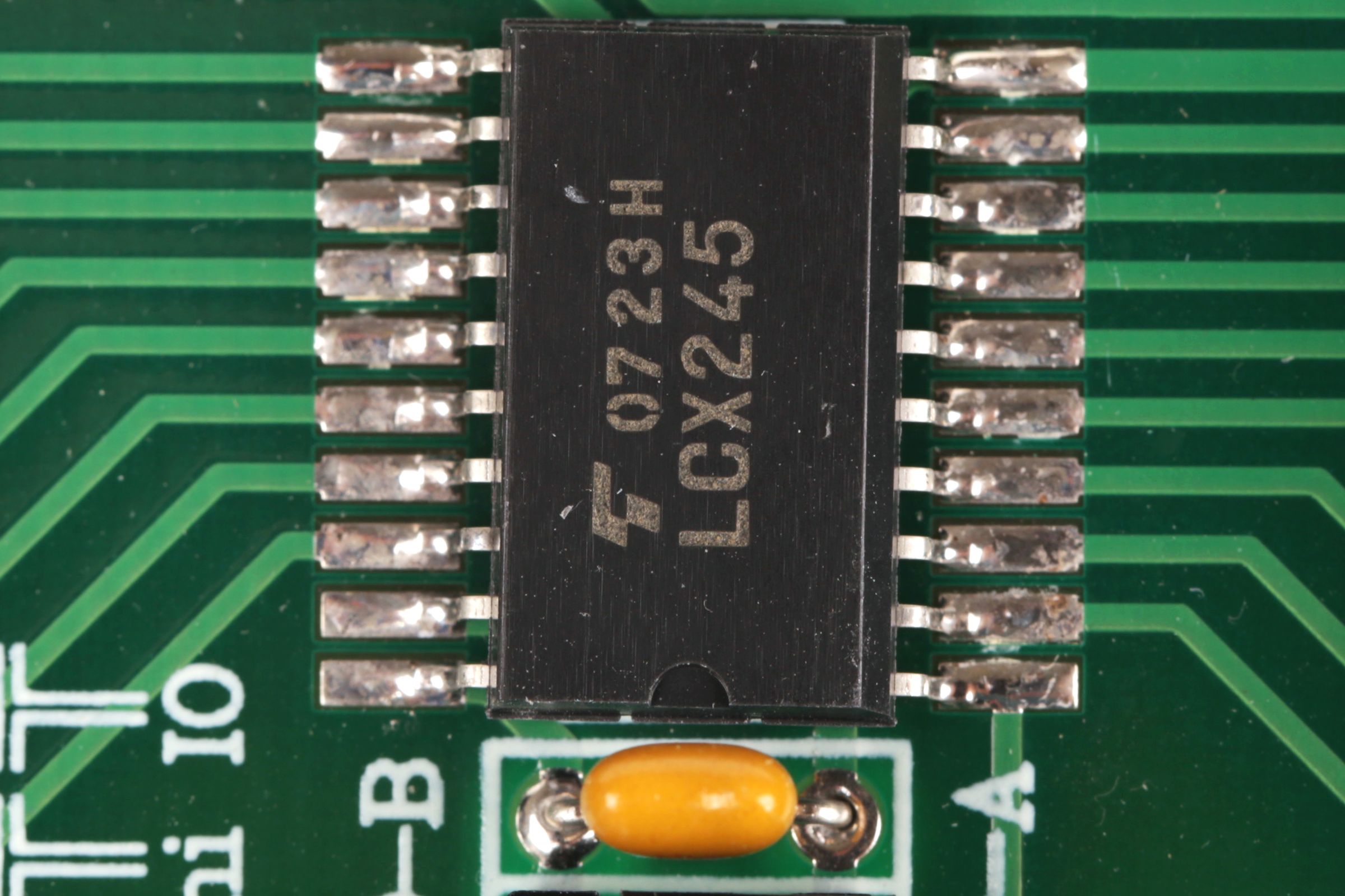

The other common type of component you might attach to a PCB are surface mount. These are small parts with metal tabs that get soldered directly to the surface of the board.

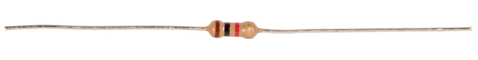

A component refers to any part used in a circuit. This is always referring to the part itself, and always has the same symbol. It can and often does have a different package and footprint.

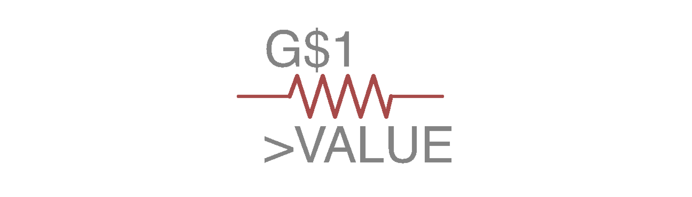

A symbol is used when drawing a schematic as a stand-in representation of a component. It has all of the necessary pin connections required by the component.

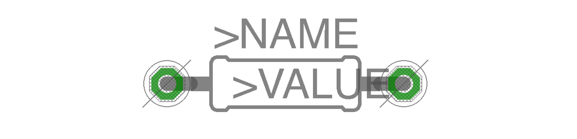

A package is the 3-dimensional shape of the component, and also indicates how it mounts to the circuit board (through hole, surface mount, or otherwise). This specification is typically provided by the manufacturer or retailer and is used for selecting the appropriate footprint when designing the board.

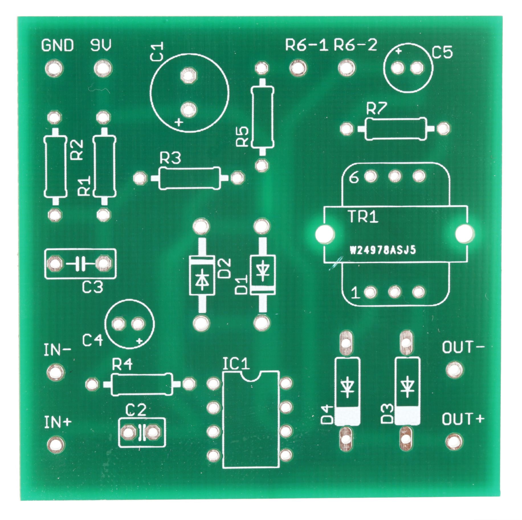

A footprint
is the 2-dimensional layout of the package atop the surface of the
board. It consists of a silkscreen layout, name label, plated through
holes or pads, and any other necessary layout information.
