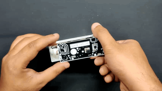

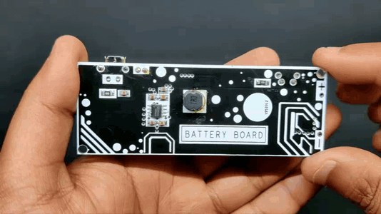

Step 3: PCB DESIGN: BATTERY BOARD
The battery board, which consists of an IP5306 Minimal configuration with a few capacitors on both the input and output sides as well as a few resistors and an inductor, was then set up.
The XIAO SAMD21 and the RGB Matrix, in our case, are powered by the IP5306, a power management integrated circuit (IC) that is used in commercial power banks. It increases the 3.7V lithium cell's output to a steady 5V 2A, which may be utilized to power numerous 5V operated devices.
Along with these characteristics, it also has a battery fuel indicator light and low and high cut functions.
Regarding the board design, we used the CAD file's board shape to arrange all of the SMD components on the top side of the board and the bottom side of the board to allow for THT components such as the USB port, push button, LED, and lithium cell holder.

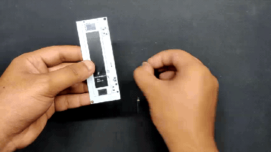

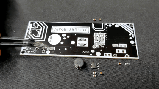

Step 6: PCB ASSEMBLY
  1. Using a solder paste dispensing needle, we first add solder paste to each component pad, one by one. We're using standard 37/63 solder paste here.
  2. Next, we pick and place all the SMD components in their places on the PCB using an ESD tweezer.
  3. With extreme caution, we lifted the complete circuit board and placed it on the SMT hotplate, which increases the PCB's temperature to the point at which the solder paste melts and all of the components are connected to their pads
  4. Along with the indicator LED and push-button switch, we added a USB micro port to the bottom side and used a soldering iron to solder the pads of the components.

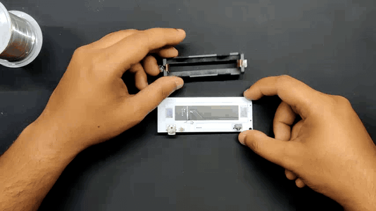

  5. The lithium cell holder is then positioned, and its pads are soldered in place.

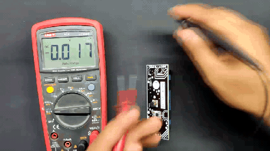

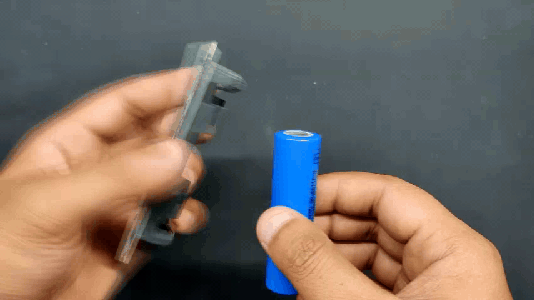

Step 7: POWER SOURCE
We are using an 18650 3.7V 1800mAh Li-ion cell as our power supply, and it is attached to the PCB's backside lithium cell holder.
We used a multimeter to measure the board's output voltage after putting in the cell, and the result was 5.1V, confirming that the circuit is functioning.

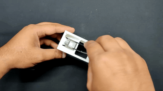

Step 8: BODY ASSEMBLY

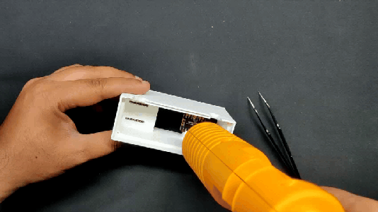

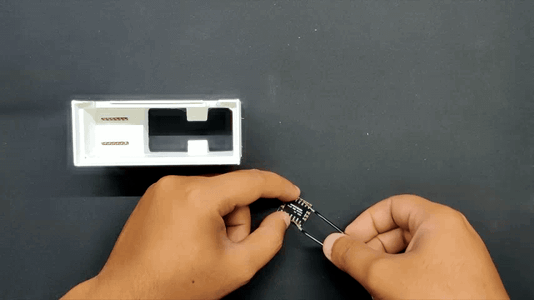

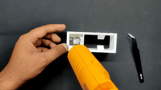

  1. The first step in the body assembly procedure was placing the XIAO on the main body in the intended place. We place the XIAO into its intended place using a tweezer.
  2. To secure the XIAO to the main body, we next put hot glue on top of it.

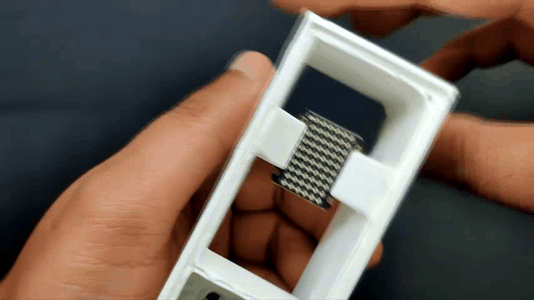

  3. Next, we use the tweezer to pick the XIAO RGB matrix and place it inside the main body. After that, we secure the matrix board and body in place using hot glue.

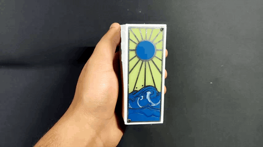

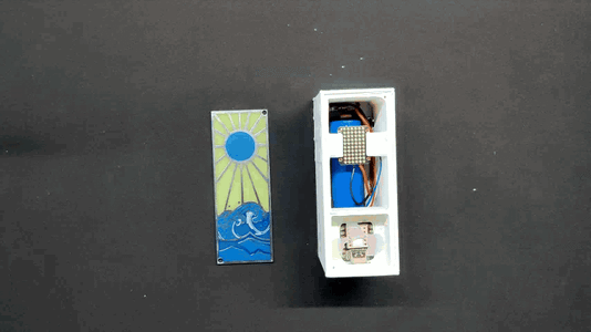

Step 10: FINAL ASSEMBLY

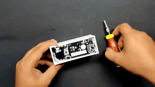

  1. Following the wiring, we installed the battery board on the rear side of the main body and fastened it firmly with two M2 screws.

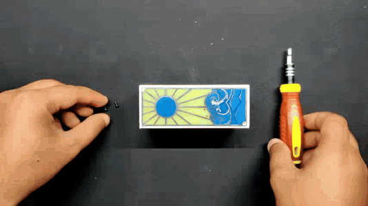

  2. Subsequently, the Art Layer PCB is positioned on the front side of the main body, and it is secured with two M2 screws.
PCB Desk Light is now complete. Let's have a look at the code.

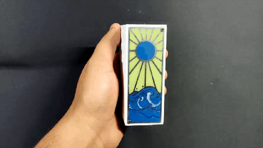

Step 12: RESULT

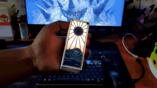

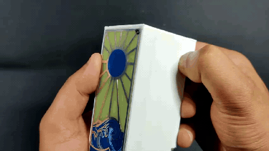

This is the finished project, an ARTISTIC PCB DESK LIGHT inspired by the "Great Wave off Kanagawa." By pressing the push button located on the left side of the device, the device turns ON.
The RGB Glow is visible on the front side of the PCB, where we have opened the solder mask to allow light to pass through, and the RGB matrix illuminates the interior of the desk light.

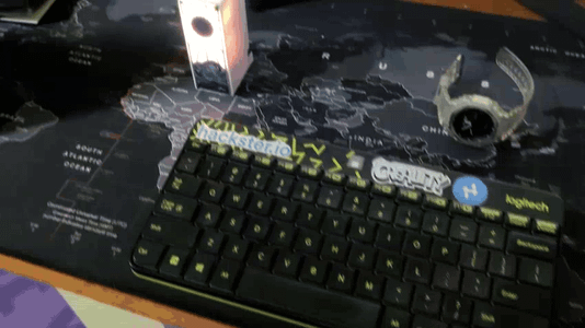

We positioned this desk light next to our monitor, and it looks amazing and enhances the aesthetics of the desk setup.
