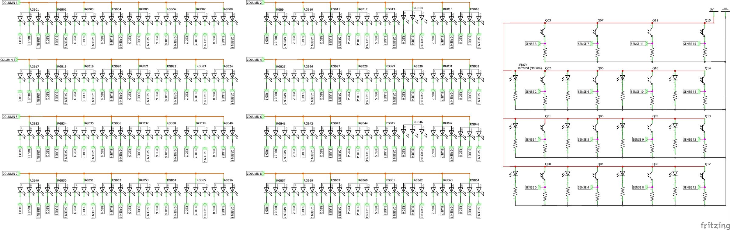

Step 2: SCHEMATIC & EAGLE DESIGN

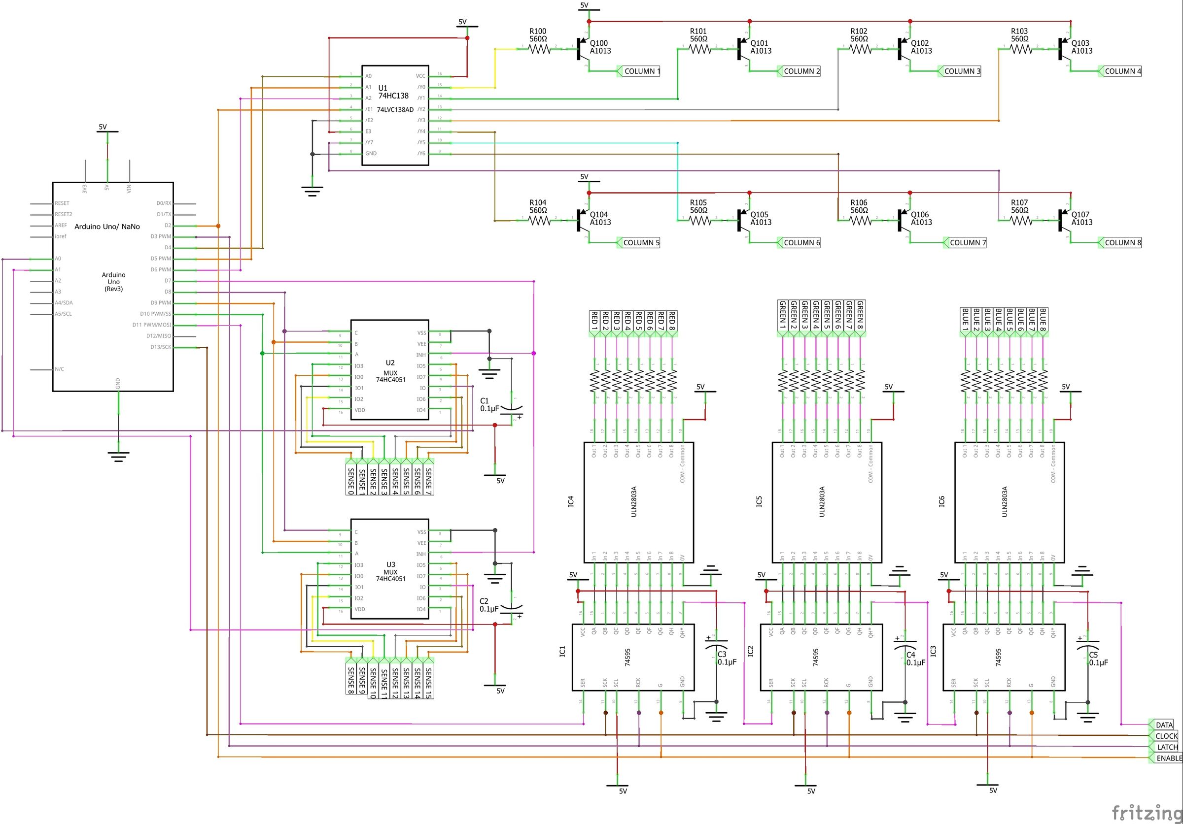

1. SCHEMATIC
Picture above is overall schematic for an interactive RGB Led size 8x8 or you can download high resolution PDF file HERE. It includes the following circuits:
- INTERACTIVE MODULE 8x8: including 64pcs x RGB LED 5mm, common anode + 12pcs x IR LED + 16pcs x Photo-transistor.
- LED COLUMN SCANNING CIRCUIT: including 3pcs x (74HC595 + ULN2803) or 3pcs x TPIC6B595N + 24pcs x R100 + 3pcs x Capacitors 0.1uF.
- LED ROW SCANNING CIRCUIT: including 1pcs x 74HC138 + 8pcs x A1013.
- MULTIPLEXER CIRCUIT: including 2pcs x 74HC4051 + 2pcs x Capacitor 0.1uF.
Note: The 74HC4051 is an 8 channel analog multiplexer/ de-multiplexer, its working is as follows:
- Multiplexer mode: You can choose between 8 different inputs and select just one you want to read at the time.
- De-multiplexer mode: You can choose between 8 different outputs and select just one you want to write at the time.

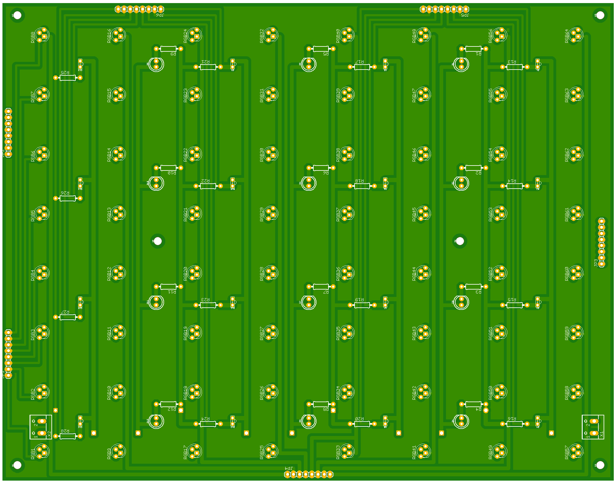

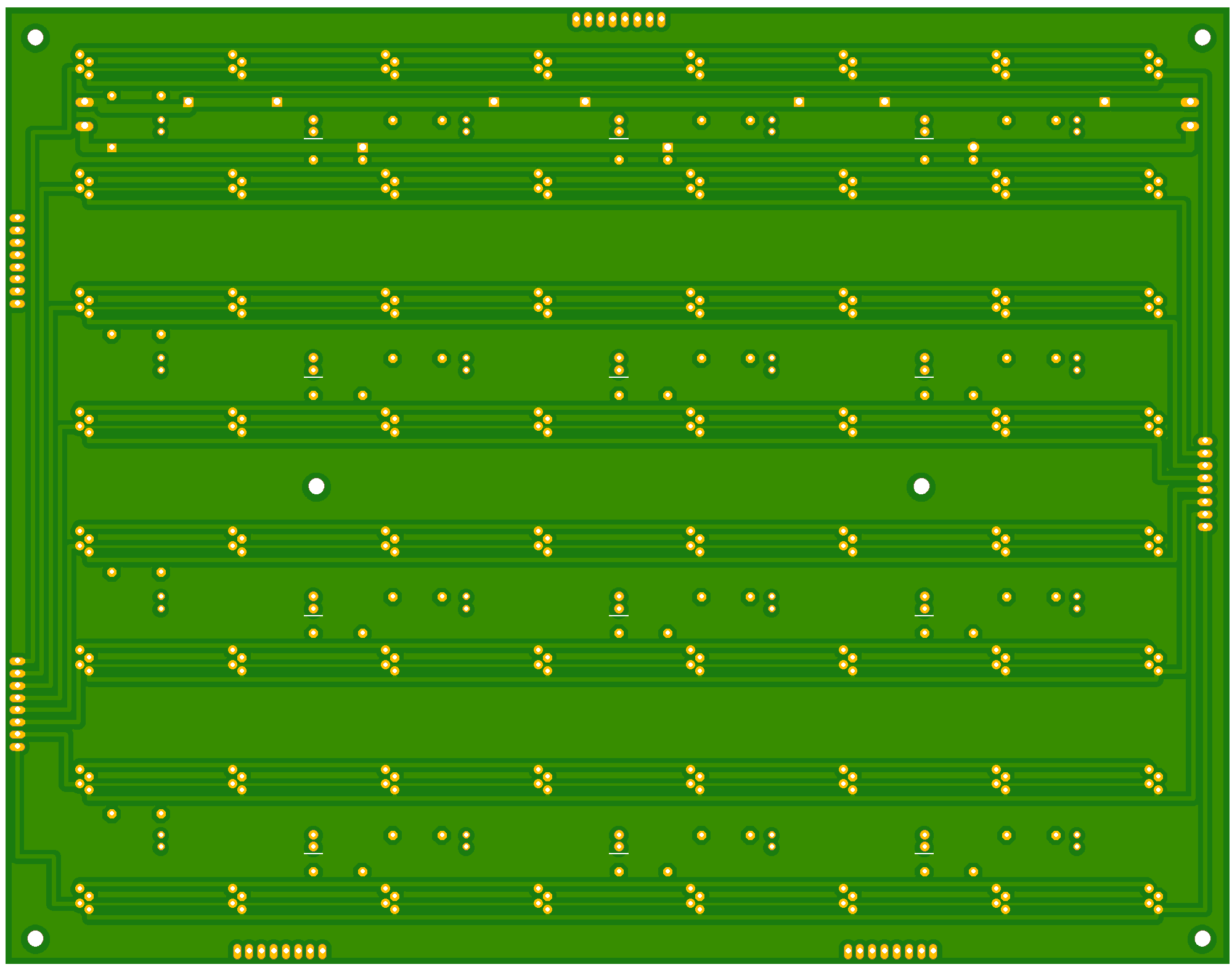

2. EAGLE DESIGN
I only designed PCB for INTERACTIVE MODULE 8x8 on Eagle software and etched this circuit at home. For the remaining control circuits, I soldered on the prototype board 9x15cm.
You can download PDF design files below:
*** INTERACTIVE MODULE 8x8 - TOP
*** INTERACTIVE MODULE 8x8 - BOTTOM

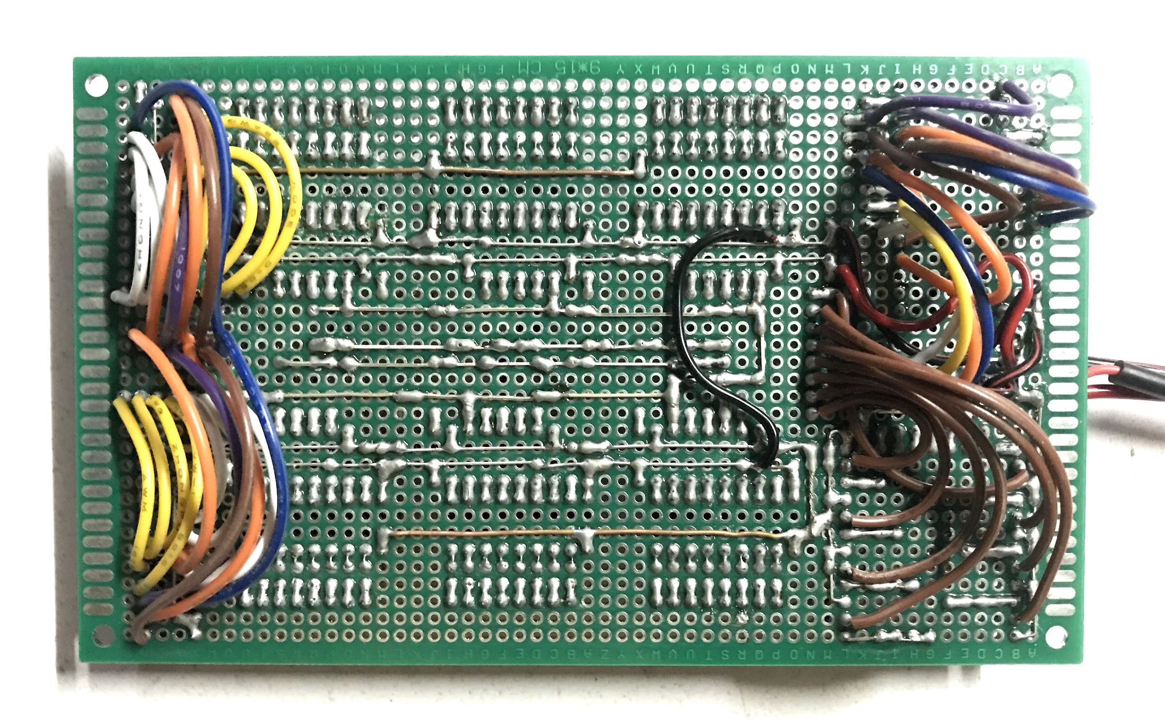

- PROTOTYPE CONTROL BOARD:
I soldered the control circuit on prototype board 9x15cm as diagram below. We'll see my result on next step.

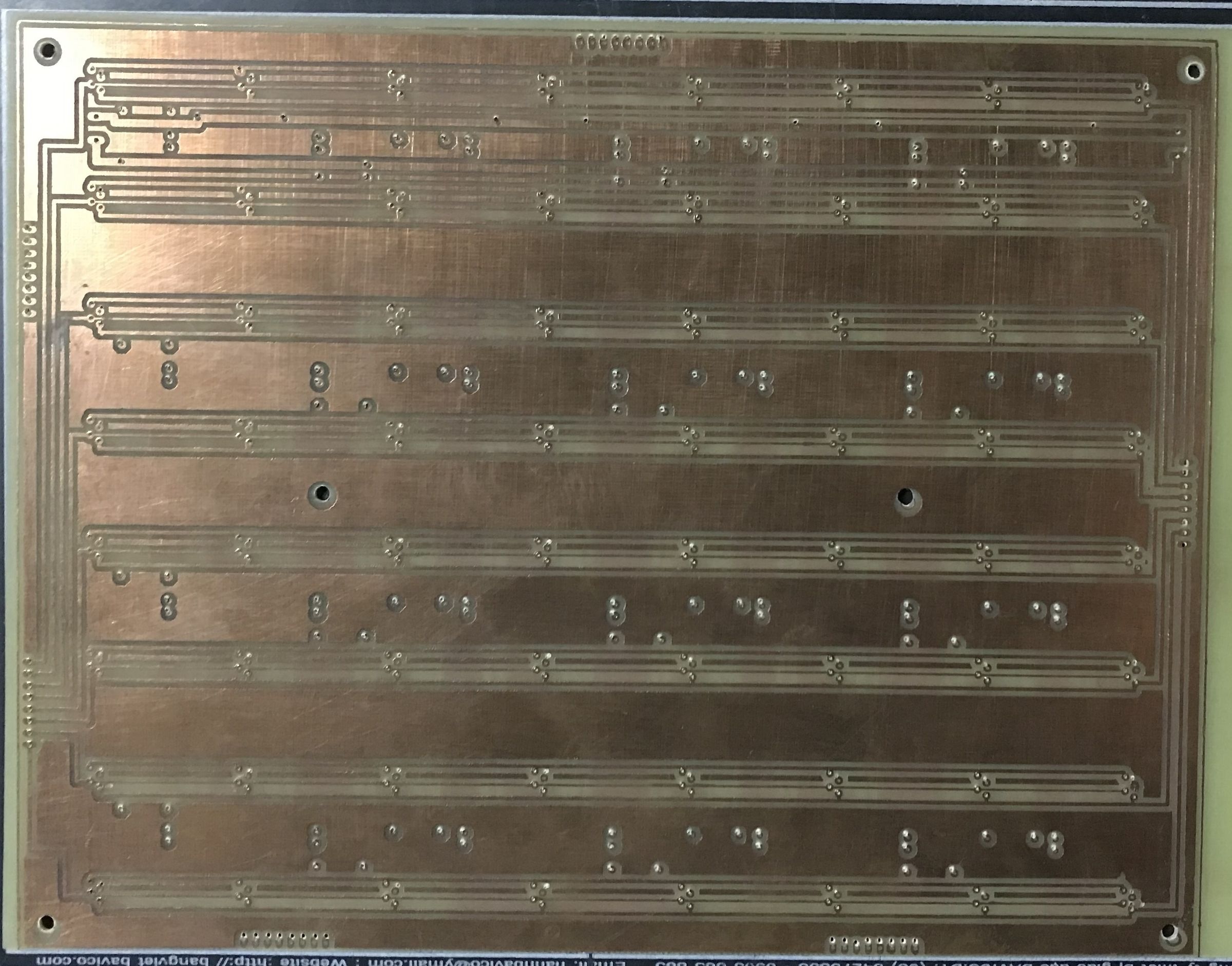

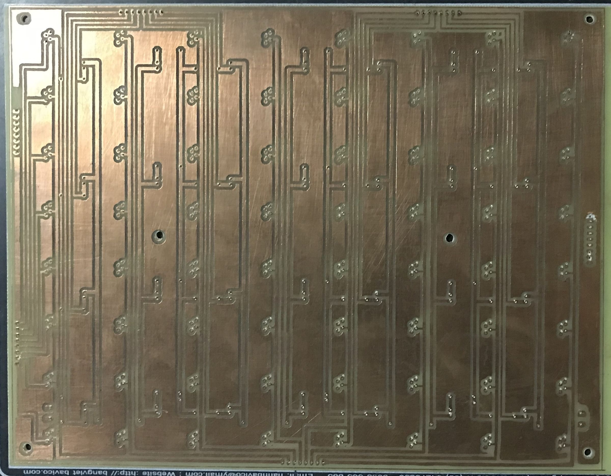

Step 3: ETCHING
To make a circuit board at home, I used Clothes Iron Toner Transfer method that simply print the circuit design out on a laser printer, iron it onto the copper, and etch. In this project, I did etching by myself on copper clad double side plate 20x30cm by Ferric Chloride method for INTERACTIVE MODULE 8x8.
TIP: If you're designing double sided PCB you'll should have a few holes somewhere that you can use a pin or drill bit to align both sides. In my case, I used some LED pin's holes located at four corners like alignment holes.
My result after etching and drilling as shown below:
- INTERACTIVE MODULE 8x8 - TOP VIEW
- INTERACTIVE MODULE 8x8 - BOTTOM VIEW

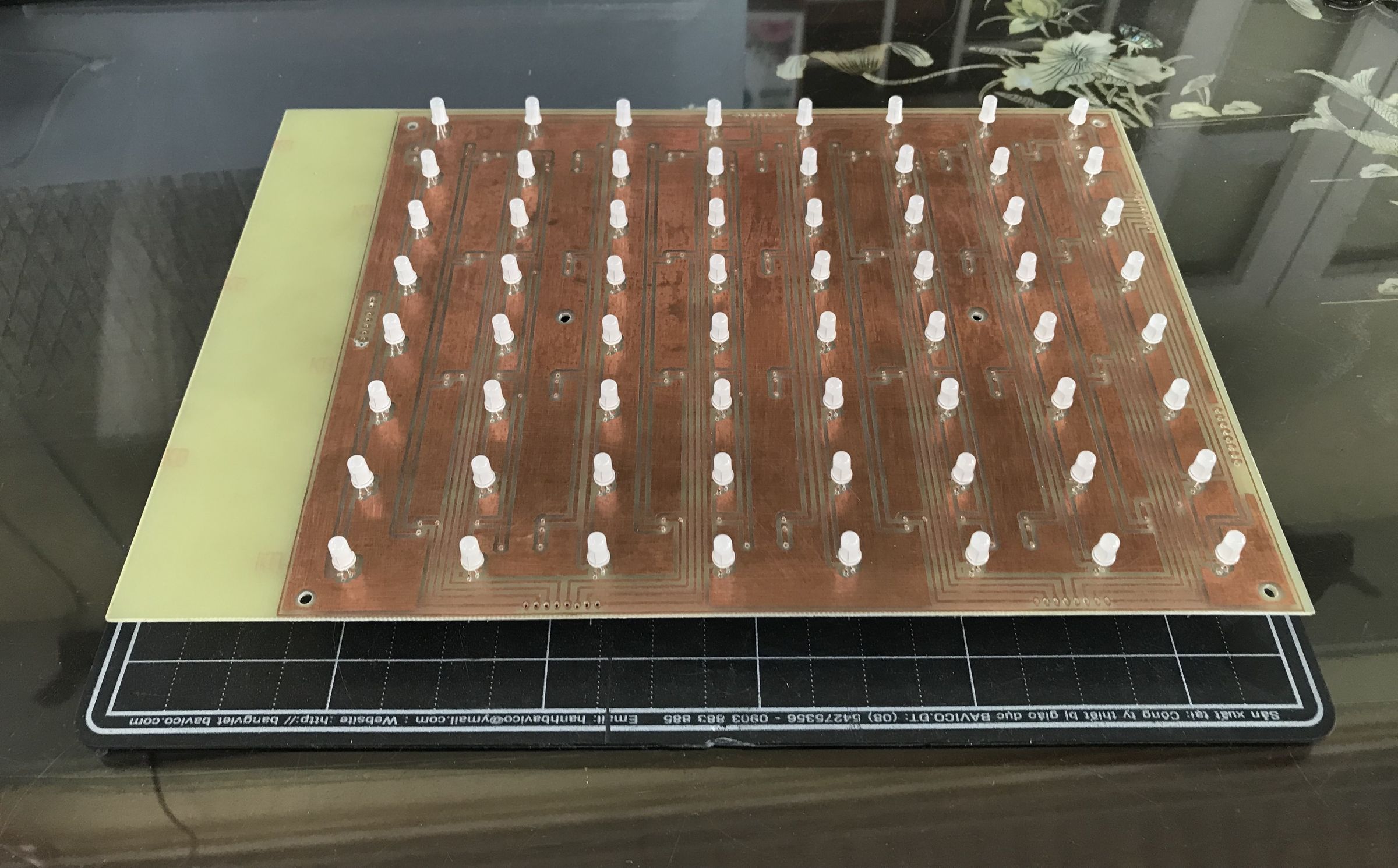

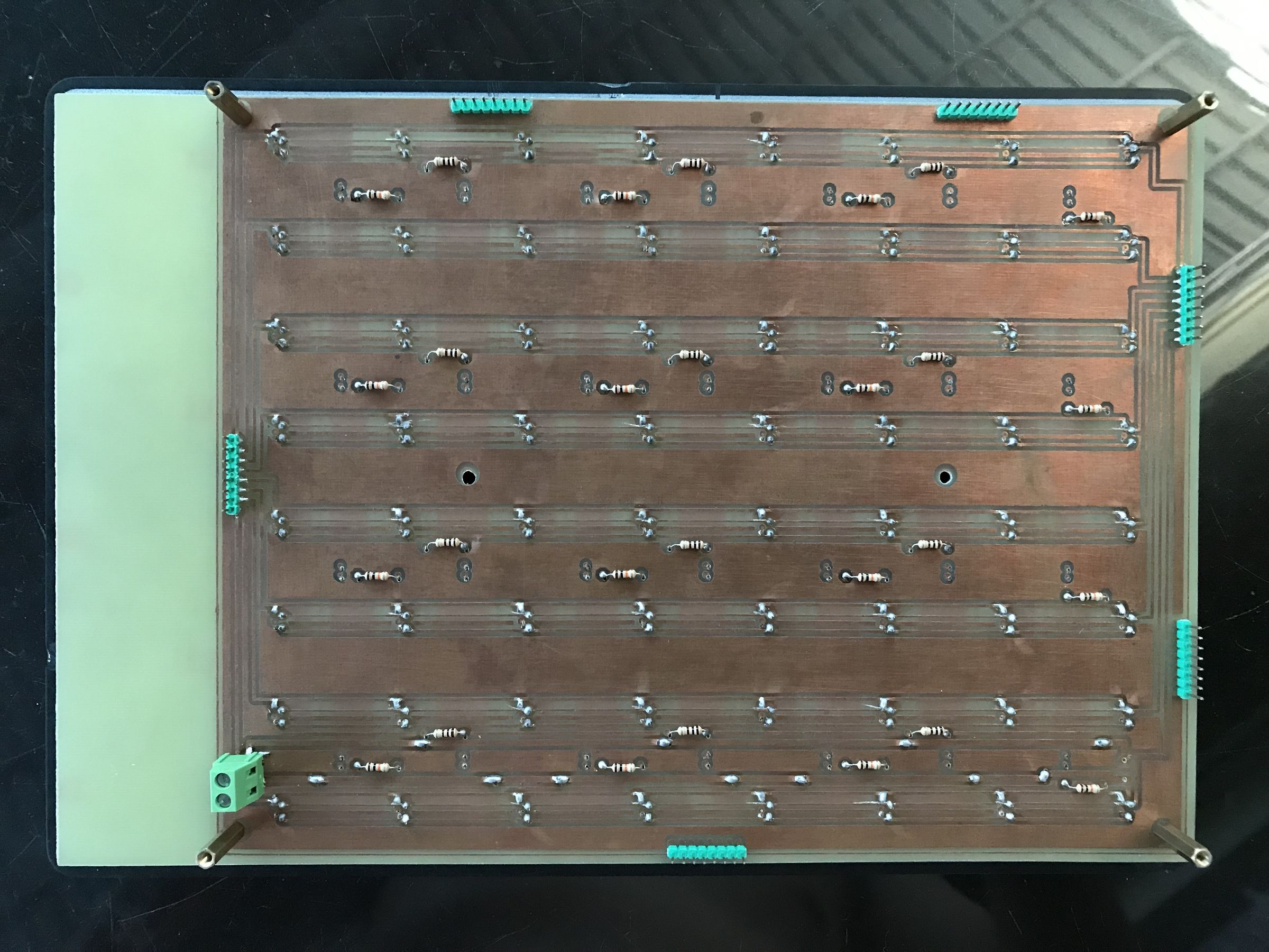

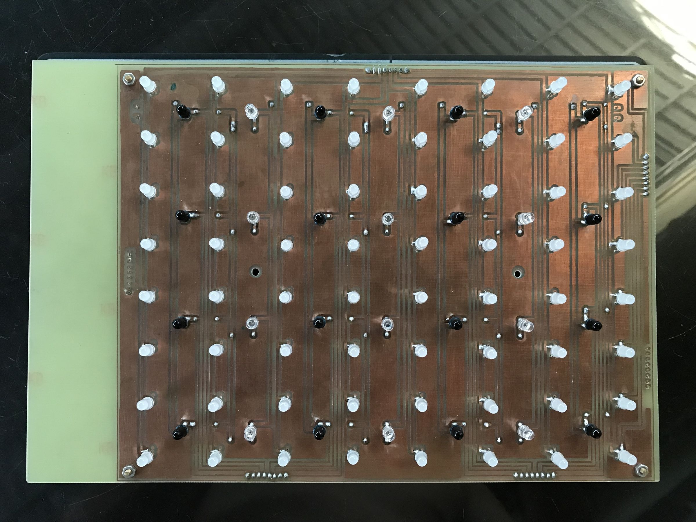

Step 4: SOLDERING WORK
- Soldering 64pcs x RGB LEDs.
- Soldering 12pcs IR LEDs and 16pcs x Photo-transistors.
- Soldering resistors, female header and power supply screw header. Note that I put all headers and resistors at bottom of PCB.
Soldering a prototype control board following the schematic on previous step, including: LED COLUMN SCANNING CIRCUIT, LED ROW SCANNING CIRCUIT, MULTIPLEXER CIRCUIT and ARDUINO NANO. My circuit has up to 6pcs x (74HC595 + ULN2803) while 3pcs x (74HC595 + ULN2803) are sufficient for this project.
*** PROTOTYPE CONTROL BOARD - TOP VIEW
*** PROTOTYPE CONTROL BOARD - BOTTOM VIEW

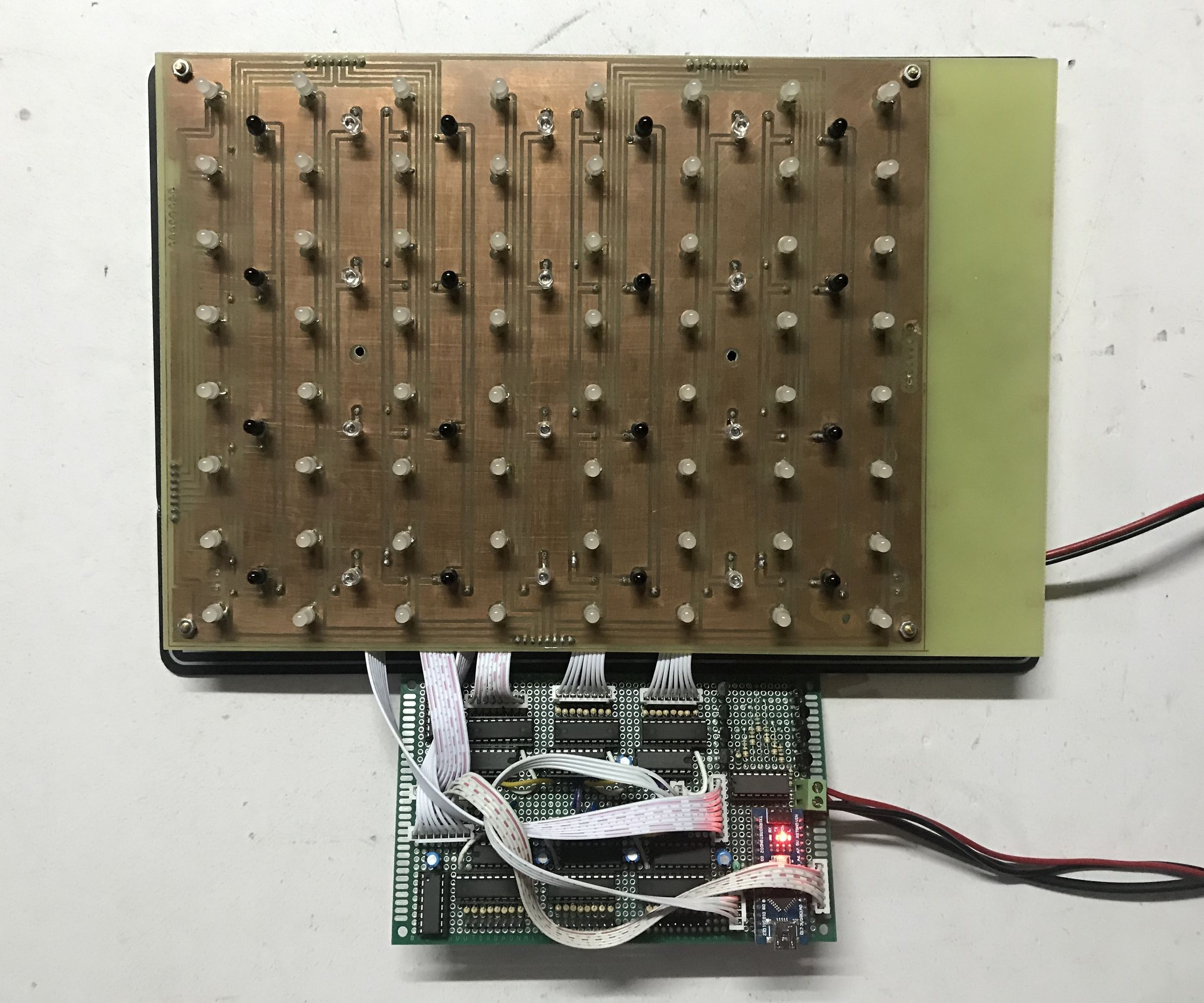

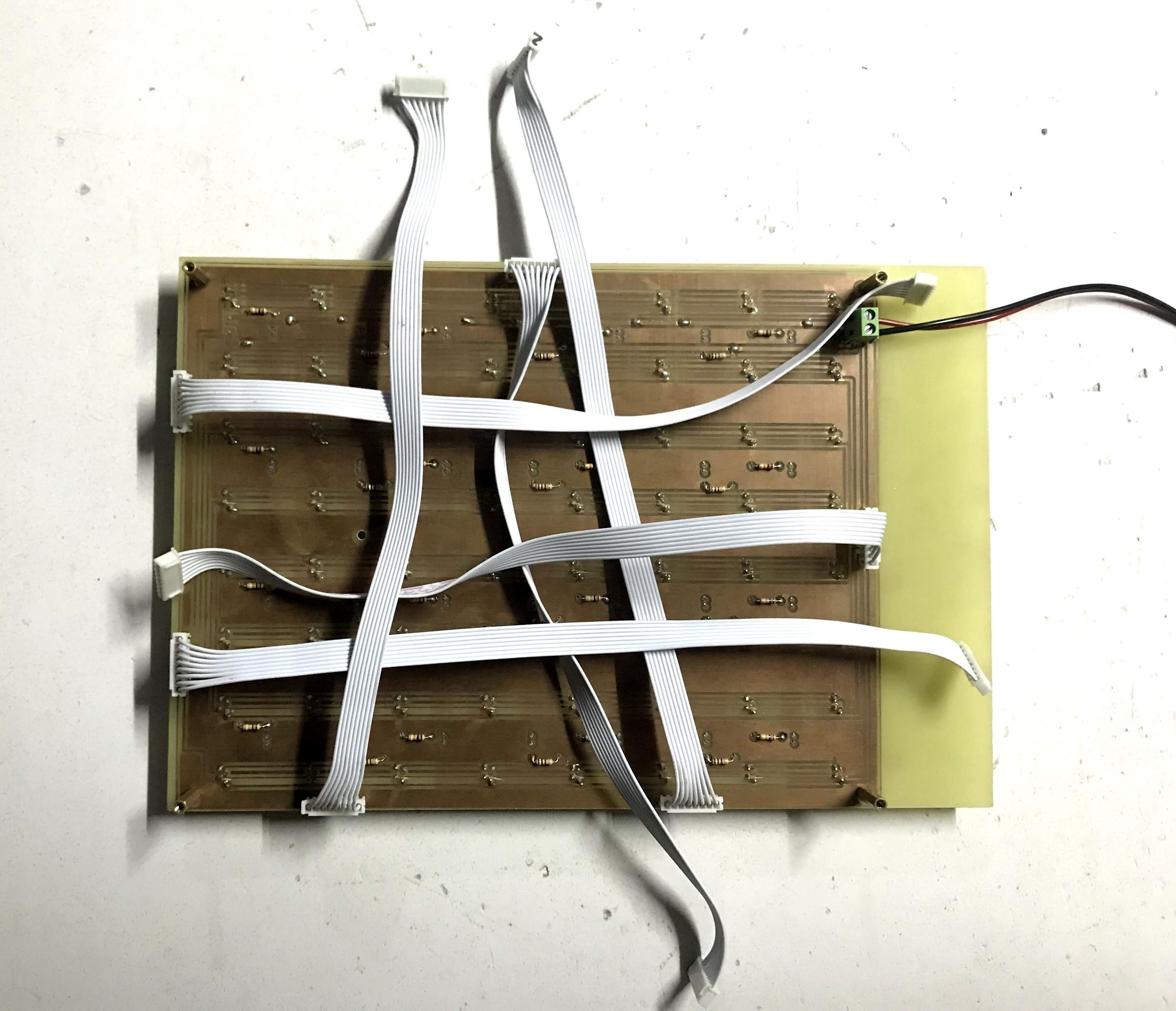

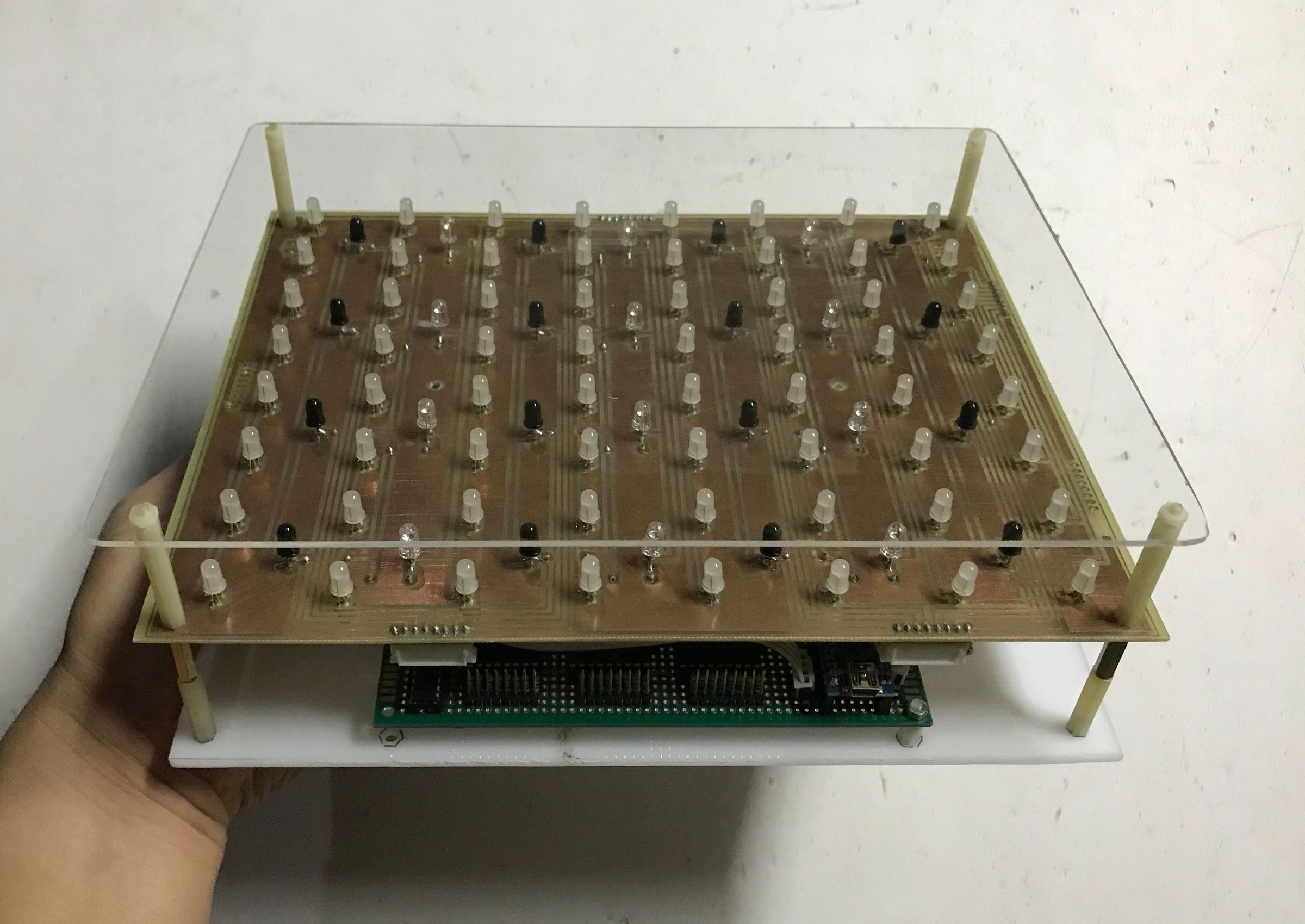

Step 5: CONNECT BOARDS TOGETHER
- Connecting 6pcs x 8P flat ribbon cables to INTERACTIVE MODULE 8x8
- Finally, I connected all flat ribbon cables and power supply cable from INTERACTIVE MODULE 8x8to Prototype Control Board.
NOTE: Before connecting the circuit together, we should check and fix or replace the RGB LEDs in case the LEDs are broken or short-circuited.
- Cover top led board by clear acrylic plate and bottom led board by white acrylic plate. Now, Prototype Control Board is mounted on the white acrylic plate. DONE!

- RGB Leds, IR leds and photo-transistors arrangement and their coordinates are shown in below picture.
- When object is placed on the table, the photo-transistors will detect it and 4 RGB LEDs around these photo-transistors will be lighted up following the colorwheel rule. See picture in case all photo-transistors are covered.

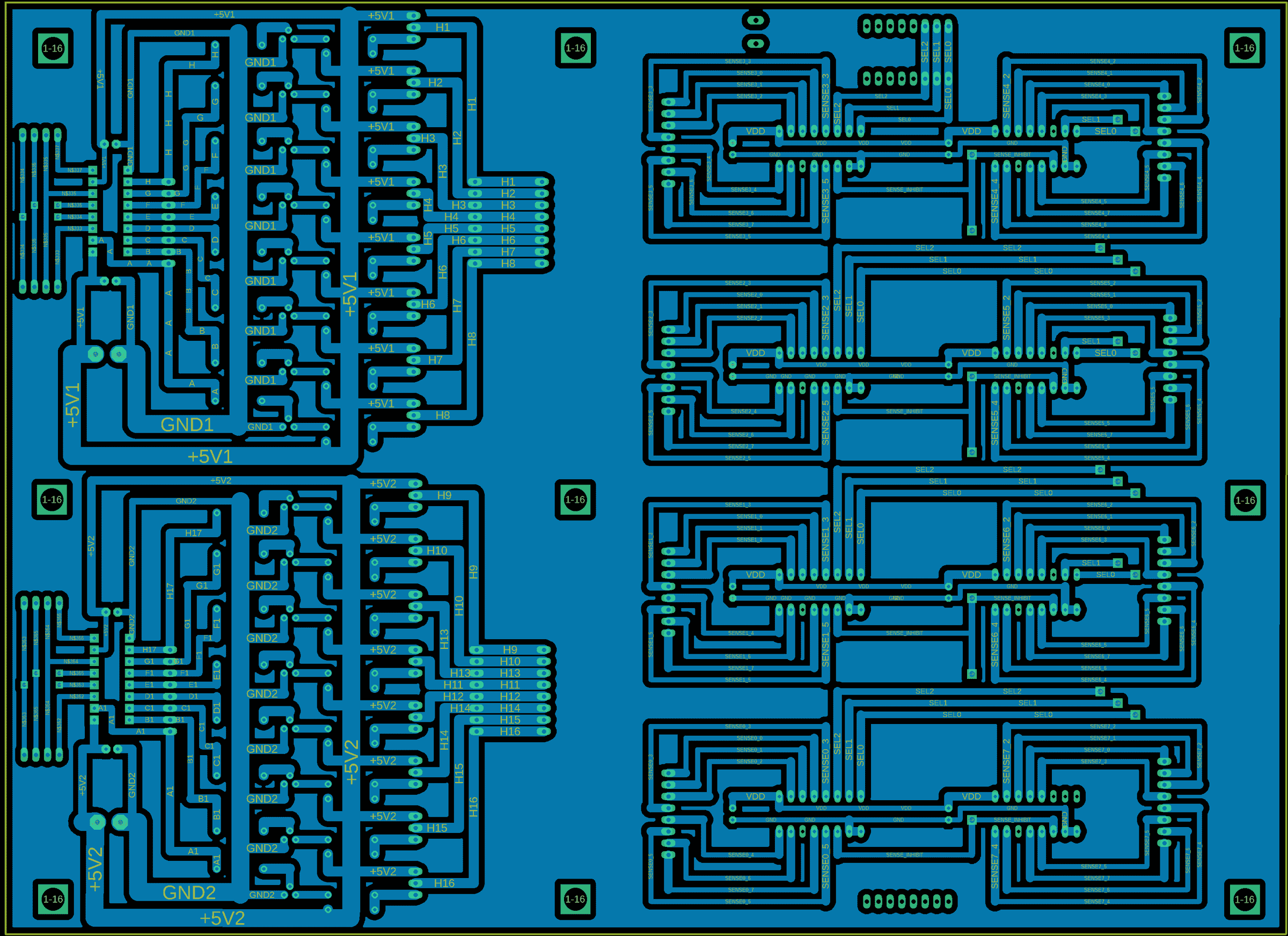

This project can be expanded up to 16x16 or 16x32 interactive led table by combining 4 or 8 x INTERACTIVE MODULE 8x8together. And we can use Arduino Mega 2560 with 16 analog inputs. I have designed preliminary control circuits on Eagle software as follows:
- LED COLUMN SCANNING CIRCUIT with 24pcs x (74HC595 + ULN2803). It can control 512 RGB LEDs of 8 x INTERACTIVE MODULE 8x8.
*** PCB TOP VIEW
*** PCB BOTTOM VIEW

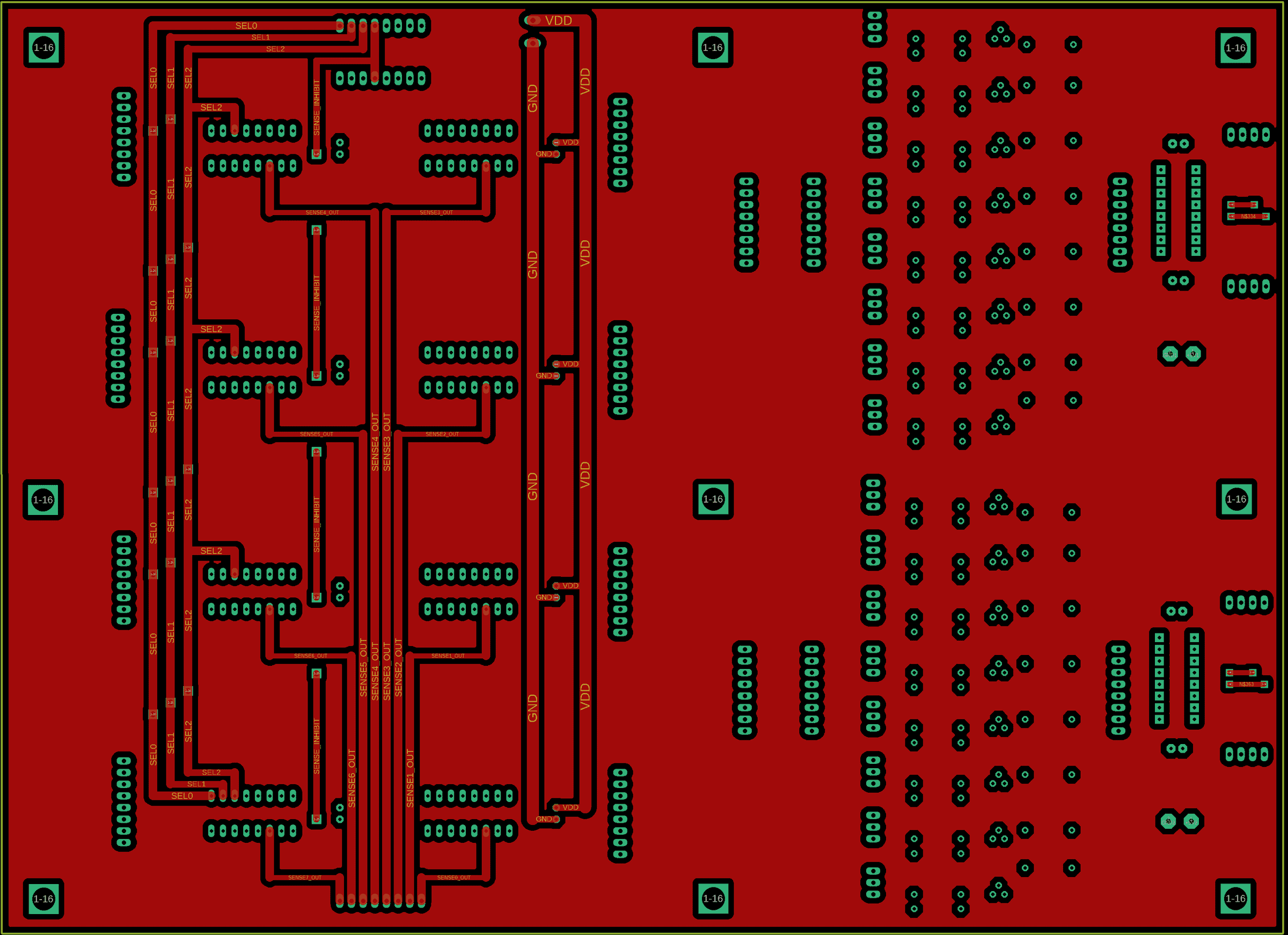

- LED ROW SCANNING CIRCUIT& MULTIPLEXER CIRCUIT: I combine them in one PCB
- LED ROW SCANNING CIRCUIT: include 2pcs x 74HC238 + 16pcs x TIP42C. It can control 16 LED's rows.
- MULTIPLEXER CIRCUIT: include 8pcs x 74HC4051. It can read 64 photo-transistors through 8 analog input. We can use 2 circuits to read 128 photo-transistors through 16 analog input of Arduino Mega 2560.
*** PCB TOP VIEW
*** PCB BOTTOM VIEW
