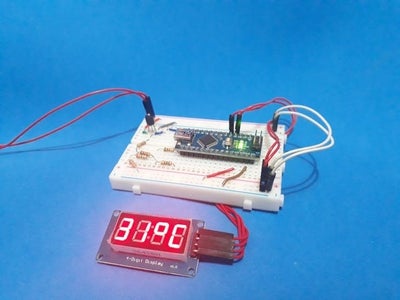

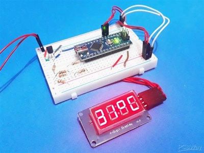

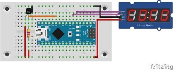

Step 1: The Project
The project is constructed through an Arduino Nano, DS18B20 Sensor, and TM1637 Display. Everything can be seen in Figure presented above.

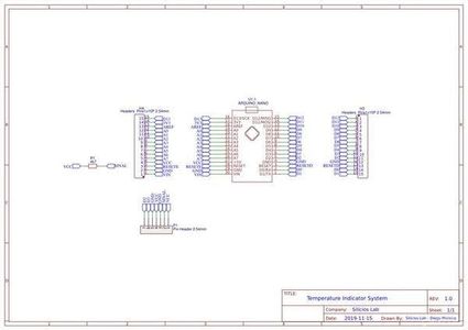

Step 2:
Through this circuit is possible to see the temperature is indicating in the TM1637 Display. The Electronic Schematic to construct your circuit is presented below.
Through this circuit, the printed circuit board was designed. And the electronic schematic is presented above.

From this code, you'll verify the temperature value in your system.
