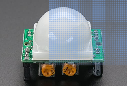

Using a screwdriver, turn the orange knob labeled "time" all the way to the left. This shortens the time delay to about five seconds which is ideal for my project. Turning the knob all the way to the right would result in a 60 minute time delay. Adjust "sensitivity" knob (seen on the left) directly in the center.

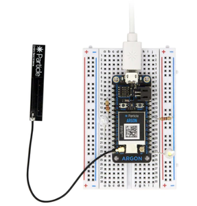

Hook sensor up to argon.
Step 4: Wiring
Place seven wires on the breadboard accordingly using the images above.

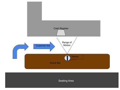

Attach toilet paper roll around the base of PIR sensor to minimize the range of motion it senses and ensure accuracy.

Above is a visual representation of my workplace layout and how I utilized my project. I chose to face the sensor towards the register to ensure it didn't pickup irrelevant motion in the seating area.

I struggled with the time delay. Initially I had it set to 10 minutes and didn't know why my IFTTT wasn't working. Upon further inspection I realized it wasn't a programming issue and I just needed to shorten the time delay on the physical sensor.
