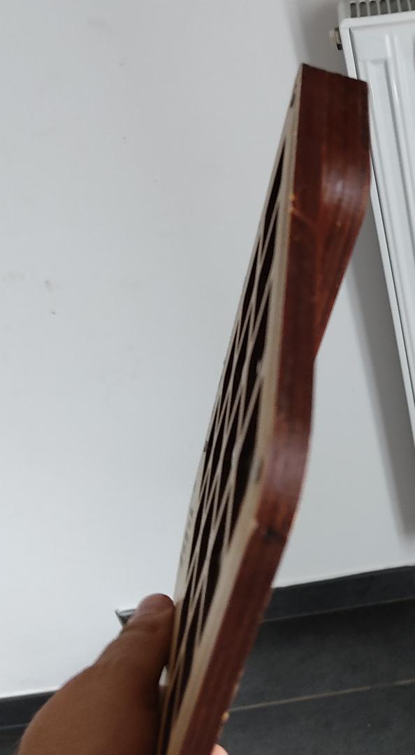

Step 2: The Enclosure (Update)
Here is the Updated Version
The enclosure is made of 3mm MDF boards that have been laser-cut. Of course, it should also work with a hobby saw.
"1" is the lowest part. Part "2" and part "3" are glued on top of it. This then looks like this.
The six M3 nuts are then used in part 3.
now glue part "4" and "5". This completes the bottom part
The front part
Part "3" is glued to part "4" first.
The circled things must be removed with the help of a cutter or side cutter.
On the back of "1", insert two M3 nuts at the bottom and glue on the elongated wooden part so that they no longer fall out.
Now "1" can be glued on
Copper tape from 10mm width works. mine is a little wider, but this is not a problem. Four pieces cut to size and stick as shown in the photo.
Glue the bottom part with the top part and the enclosure is completed.
Before gluing the bottom part, do not forget the last 2 nuts in part "4", because they will hold the front cover.

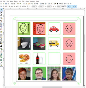

Step 4: Cover Sheet
The cover sheet with the pictures is simply a printed picture for which a template has been created so that you can make them yourself without any problems. Afterwards, the sheet is simply sealed in laminating foil so that the pictures are protected against abrasion.
Alternatively, you can also stick a transparent film on the front.
Cut off along the black line.
Now insert the sheet and screw the cover on.

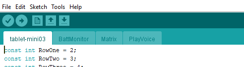

Step 6: Software
I have used several tabs in the Arduino IDE to keep the programming clearer.
Here are some explanations of the function
As you can see, the software consists of the main programme (Tablet-Mini03), the BattMonitor, the Matrix and the PlayVoice Tab.
The main programme defines all the variables that are used. Otherwise it checks whether a key has been pressed. A timer checks how long no key has been pressed in order to give an info via sound after 5 minutes that the board is still switched on (030.mp3).
The battery status is checked every 3 minutes. If the voltage drops below 3.3V, the battery low warning is played (020.mp3).
The BattMonitor works by using the analogReference(INTERNAL) in the main programme. This sets the measurement reference to 1.1 volts.
R1 (12K) and R2 (33K) function as voltage dividers. This can be calculated here: /https://www.peacesoftware.de/einigewerte/spannungsteiler.html
This way the Arduino can monitor the battery and set the variable BatteryLow to true at 3.3V.
The matrix, scans one row after the other and then per row the individual buttons. If a button was pressed during the scan, this is recorded in the ResultMatrix variable. The value is normally "0". Otherwise, the variable contains the number of the button pressed.
The PlayVoice part, controls the DF MINI PLAYER via the serial interface. I do not use the ready-made LIB, but I have written my own control software.
This TAB consists of 3 VOIDs.
void ResetVoice, Sends a reset sequence to the DF Mini. (to stop a sound file) void VolumeVoice, sets the volume.
void PlayVoice, plays the sound file that was previously set.
DFDataFile[] = {0x7E,0xFF,0x06,0x0F,0x00,0x01,0x00,0xEF} is the data that is transmitted to the DF MINI, where the sixth data string defines the sound file (Bold). Then this data set is simply sent to the DF MINI via the For loop.

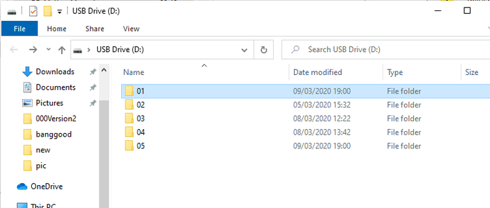

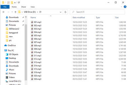

Step 7: The File Structure of the SD Card in the DF Mini Player
Connect the Pecs board with an micro USB Cable to a PC
The file folder 01 is accessed in the root directory, but you can create several, and then switch between the templates by renaming them.
The MP3 files are then uploaded inside the file folder, where 001.mp3 stands for the first button and 016.mp3 for the last.
020.mp3 should contain a text that indicates low battery power (e.g. Battery Low).030.mp3 should contain the text, indicating that the device has not been used for some time but is still switched on (e.g. Hello, have you forgotten me).
