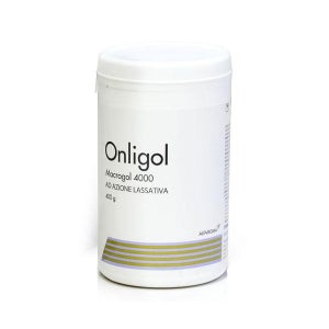

If you live in the US you can find it with the name of Miralax which is a specific brand name for PEG 3350. While Macrogol is the generic name for PEG in Europe. It can be found in a lot of different brands and formulations. Some of them may contain flavoring and excipients which you don't want in your solution. You need pure PEG.
The brand I found in Italy of pure PEG is Onligol. It contains pure PEG 4000.
- Miralax: https://amzn.to/3XDGTNL | https://ebay.to/3R7CHDs
- Onligol: https://ebay.to/3HhE1zs
