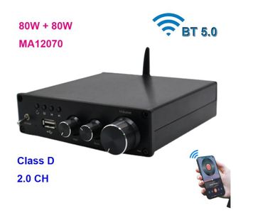

 The Signal Generator function is taken over by any smartphone, which I hope you all have at hand. It is only necessary to install the previously mentioned free application "Signal Generator". To amplify the rectangular signal generated by the smartphone, we will use an audio amplifier that we usually have for listening to music. If we don't want to use the amplifier for this purpose, we can buy an inexpensive Class D amplifier with Bluetooth connectivity that costs less than $40 and uses Laptop Power Supply(19V DC).
   Finally, we need one of the coils whose production I described earlier.
   Now we connect a cable from the phone's headphone jack to the AUX or similar universal input on the Amplifier.
   Next, at the place where the speakers are connected, we connect the coil to the place of one speaker.
   And that's all, we made the simplest PEMF machine. We turn on the amplifier, and then the smartphone software in which we enter the frequency. Next we turn the volume potentiometer up to 50%. To check if the device works we need to bring a small neodymium magnet close to the coil and the magnet should move.
