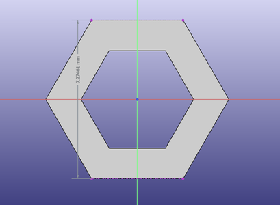

Step 1: Designing the Tip End
  1. In the "Part design" workbench, create an Hexagon shape about 7.3mm across (between 2 parallel sides) with a 4mm diameter hole in the middle
  2. Extrude this shape 20mm
  3. Create a 9° filet on one side

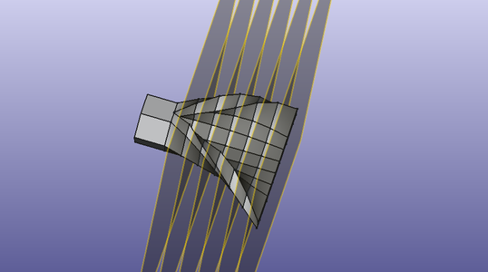

Step 2: Designing the Folding Out Section

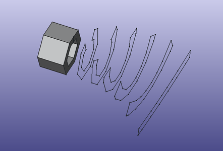

The angle between 2 consecutive sides of an hexagon is 120° and we want to completely open the hexagone which is to means progressively getting the angle from 120° to 180°
  2. Create 6 datum planes parallel the the original hexagon face, these datum planes should be 3mm appart from one another
  3. On each datum plane, create a progressively more "open" hexagon. We have 6 datum planes, creat the open hexagon with 130° angles, then 140°, 150°,160° and 179° (the last one is 179° not 180° because I could not find a way for the "additive pipe" tool to work with the angles being 180°)
  4. Select the schematic on the first datum plane and the schematic on the last datum plan, use "additive pipe" and in this tool menu, choose "Section transformation->multisections", clic on each schematic on each of the datum planes
Note: this "Folding out section" is identical in my design on both ends of the pen but you could change them as you like

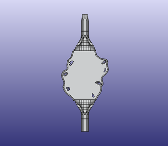

Step 3: The Middle Part
This part needs to look more "organic" than the rest of the pen, Freecad is not the best tool for this, I prefer to use a different tool: inkscape. We design this part flat on inkscape and then we import it in Freecad to make it 3D
  1. Create a random shape keeping in mind that in the final display, the sides of the pen should look as if it was actually stretched on the "dissection table" but it also has to "naturally" connect to the attached "folding out" part which are 25mm wide. For this, in Inkscape, I have used the "pen tool" to create the basic shape using lines with sharp transitions
  2. I selected all the summits of the shape (called nodes in Inkscape) and I rounded them off using "Node tool->Make selected nodes smooth"
  3. I also drew hole shapes and placed then on the shape where pin would have streched the "pen skin"
  4. Perform a boolean operation between the holes the original shape "Path->Difference"
  5. Save as SVG file
  6. Import the shape in Freecad: File->import->your_image.svg->SVG as geometry
  7. Select all the imported path
  8. go to workbench "Draft" then use the tool "Draft to sketch", this creates a sketch
  9. In the "Part design" workbench, create a body, drag and drop the created sketch
  10. pad the sketch 1.5mm

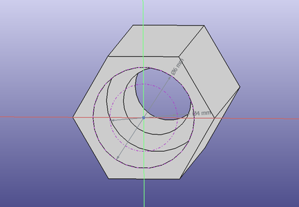

  1. In the "Part design " workbench, create an Hexagon shape about 7.3mm across (between 2 parallel sides) with a 4mm diameter hole in the middle
  2. Pad this shape 20mm
  3. Create a bigger hole on one side 6mm in diameter
  4. Cut this hole 8mm deep

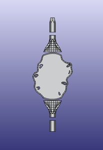

Step 5: 3D Model Assembly
In a new file in Freecad, in the the "Part" worbench
  1. Import all the parts (5 in totals with 2 different instances of the "folding out" part)
  2. Move/rotate them as necessary to achieve the desired design (right clic->transform)
  3. Perform Boolean "union" operation on all the parts (assemble 2 parts at a time)
