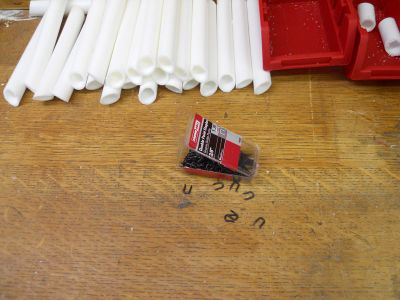

- U shaped nails, commonly called fencing staples

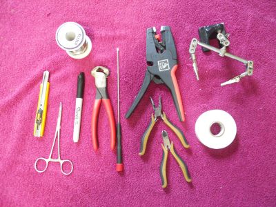

Tools:
- Hand Saw Miter Box, critical tool for making the hexagons work well
- Drill and bits, drill press is best
- Sharp Razor
- End Cutting Pliers, these are used to crimp the fencing staples
Electronics tools, wire cutter, stripper, soldering iron, etc

The PEX Hexagons are made out of 6 equal length sections with 60 degree miters on each end. A 1/16" hole drilled near the edge of the miter, which is used for inserting the U shaped nails that hold the hexagons together. The holes need to be in the right position, a drilling jig and drill press make it easy. Before cutting the entire length of pipe was cleaned with some solvent and a rag, the printed text comes off easily.

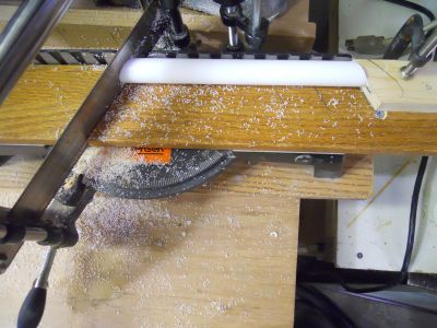

- The miter box will need a stop block to ensure each section is exactly the same size, just measuring and cutting will result in a hexagon that doesn't fit together well. The miter box saw was not long enough so a long board was clamped to the top of the miter box.
- Set up the miter box for 60 degrees
- Measured and clamped a stop block to the miter box in position for the first length.

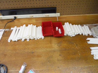

- Cut all the segments for each length at the same time, without allowing the stop block or blade setting to be changed. This ensures they will all be exactly the same length.
- Then adjusted the saw stop block for the next segment size.

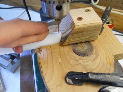

Drilling:
- A small drilling jig was made, which is a 2x2 block with 60 degree miter, screwed to a board with groove cut in it to seat the PEX pipe.
- The jig was clamped to a drill press and through a bit of guessing and trial and error, was secured into position. The distance is a little bit less than half of the width of the U shaped nails.
- Drilled 1/16" hole on each segment end, with the hole on the point of the miter.
- Drilled 2 holes in each segment, repeat for all segments.

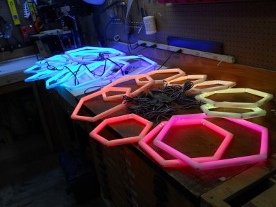

With the hexagons nearly ready, the final layout, and distances needs to be figured out. Adobe Illustrator or other graphics software can make it easy to try different variations. Once a layout has been selected, the length of the wires between the LED hexagons and the LED controller needs to be calculated. Its always better to have too much slack than too little, as you can always cut some off, but splicing ribbon cable is a huge pain and could cause issues.
LEDs:
- Start by numbering the partially assembled hexagons, referenced to the layout design.
- Calculate the length of LED strip that will be required for that size hexagon and cut some to length.
- Find the length that the 4-conductor ribbon cable will be for that hexagon and cut some wire to length.

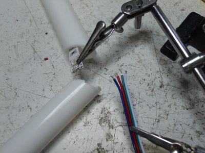

- Strip one end(an autostripper is very helpful), tin and solder the wires to the LED strip contacts, minding the wire colors so they will be the same from hexagon to hexagon.
- Tape(white tape) or shrink tube the wire and LED strip contacts.
- Insert the LED strip into the hexagon, LEDs facing inwards(at least for this project) it takes some effort and jiggling to get it past the staples/nails.
- Once its all inserted crimp the segments together.
- Repeat with all hexagons.

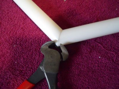

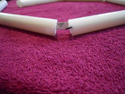

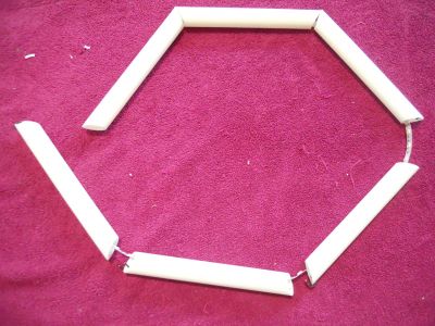

Segment Crimping:
- Lay all the segments down flat with the LED strip inside.

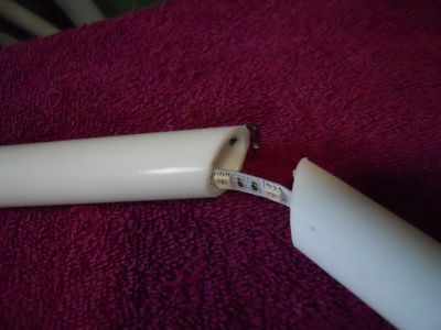

- Insert a U shaped nail/staple through the holes into 2 of the segments.
- Using an end cutting pliers, squeeze the u shaped staple/nail, it should bend inwards. It won't be very strong until all of them are installed.
- Work around inserting the staples and crimping them tight.

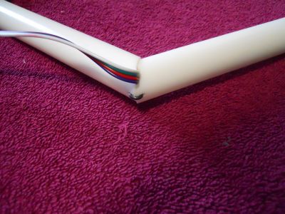

- Save the segment junction where the wire comes out for last.
- Use a razor to cut away some of the PEX pipe to make a gap for the wire to fit through.
- Position the wire, adjust the LED strip and crimp the last segment junction.

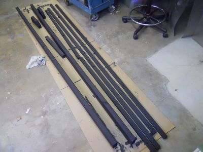

For this project all the PEX hexagons were hung on a curtain of black construction fencing. It came in 3' wide rolls, a 50ft roll was cut into foruths, making a 12'x12' section, that was zipped tied together with black zip ties. The curtain was hung from 2x2 framing, painted black.

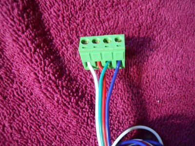

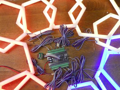

Two NLED 30 Channel High Current Controllers or NLED Quasars were positioned at the bottom of the curtain, and all the hexagon wires were connected to them. A 12 volt at 30A power supply was used to power both controllers.

The NLED Quasar or the NLED 30 Channel High Current LED Controller is extremely easy to hook up. They each offer 2 power input terminals, a large one and standard size one. Either or both can be used to provide power to the controller. Heavy gauge wire should be used to connect the controller to the power supply. The controller offers 30 output terminals, divided into 10 groups, V+ - Ch.1 - Ch.2 - Ch.3 - V+ - Ch.4 - Ch.5 - Ch.6 etc. Each group or RGB channel has a position for V+, which is the same as the input voltage provided by the power supply, and a separate position each for 3 channels(or RGB). For single color or RGBW setups, connection is a bit more confusing, but no more difficult. Just mind that the LED anodes are connected to any of the V+ positions and cathodes are connected to the desired channel(1 - 30, each independently controllable)
