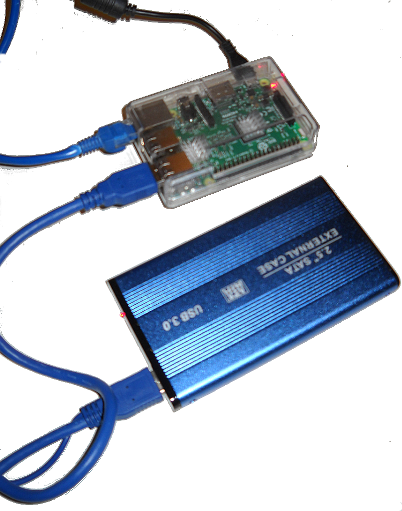

Do you already have a PI 3 ? I use mine to host a local web server for grammar and style checking. However, I also use it for a local NAS, networked attached storage. You can find lots of documents for setting up a PI. In the following document, I assume you already have a running PI.
Writing to a hard drive is faster than writing to a USB flash drive. I bought a new 500 GB 2.5" hard drive. I also spent about $12 for a USB 3.0 SATA case for the drive. I use a standard USB A to A male cable to connect it to one of the PI's USB 2.0 ports. Make sure your power supply for the PI has a capacity of 2.5 amps, 5 volts. The hard drive will get its power through the USB cable. Plug in the drive and attach the USB cable to the PI. You should heard the hard drive spin up. A 2.5" hard drive only draws about half an amp during operation. It will stop spinning when not in use, so the drive should not overload a 2.5 amp or greater 5 volt power supply.

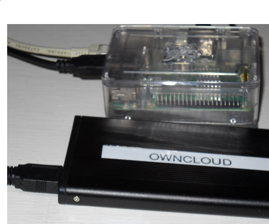

Enjoy your new PI NAS. It is fast and cheap. You can still use your PI for all its other uses.
