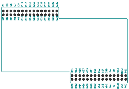

The daughter boards connect to the main board via two 2 x 30 2.54mm pitch pin headers. This allows daughter boards to be created either via a PCB fabrication house or by hand using Vero board.

The main board and daughter board interconnect include the following busses;
1. 43 dedicated I/O lines for either analogue or digital,
2. VDD and GND power supply,
3. 5 dedicated SPI Chip Select (CS) lines,
4. SPI Buss for MOSI, MISO and CLK lines,
5. I²C shared as part of the SPI buss,
6. Dedicated TX and RX lines for RS232, RS485 and MIDI,
7. Dedicated D+ and D- lines for USB data,
8. Dedicated PIC programming lines, MCLR, PGD and PGC.
Due to the nature of SPI chip select lines, these lines are shared with various I/O lines. The sharing of which I/O line depends on the microcontroller daughter board used. It is intended that the connection of the CS lines to the microcontroller will be done on the daughter board. For example, for the PIC16/18 40 Pin USB daughter board for PIC18F4550 the CS lines share I/O pins 16, 17, 18, 19 and 32, which equates to PIC pins Port C0, C1, C2, C3 and E0. For this reason it is required for all peripheral boards using SPI to include a switch or breaker method to disconnect unused or other utilised CS lines.
Due to the nature of the RS232 TX and RX and USB D+ and D- lines, these lines are also shared with various other I/O lines. For this reason it is required for all peripheral boards using RS232, RS485 or USB to include a switch or breaker method to disconnect unused or other utilised TX, RX, D+ and D- lines.
The I/O lines are routed to various microcontroller pins, which pins are detailed within the daughter board schematic or the PCB silkscreen. Usually ports are routed to;
1. Port A = I/O lines 0 – 7,
2. Port B = I/O lines 8 – 15,
3. Port C = I/O lines 16 – 23,
4. Port D = I/O lines 24 – 31,
5. Port E = I/O lines 32 – 35,
Other PIC types such as dsPIC30/33 and 24 series will use different wiring arrangements.
