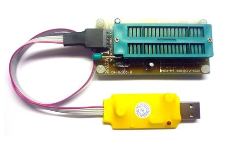

PIC Programmer (I used the old fashioned QuickWriter.)

Step 3: Program the Chip
Download the software, set up the cables and program the code with the object code or if you want to be able to edit it , use the source code.
