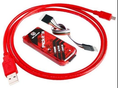

3- PICKit3 Programmer (Can be purchased on Ebay or online stores)

The programmer built into the MPLABX IDE can be used for upload to the PIC.
The PICKitEasy programmer software in step 9 is an alternative to the MPLABX IDE programmer.
The PICKitEasy programmer software handles PICKit2 and PICKit3 legacy programmers.

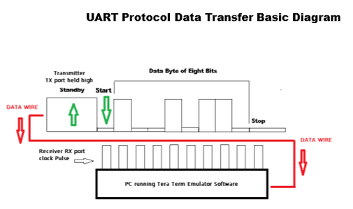

Step 4: Basic UART Protocol
UART (Universal Asynchronous Receiver/Transmitter) is a means to transfer data using serial communication over two wires, identified as RX and TX data wires. In this presentation the TX (Transmit) line will be used to send data from the PIC micro-controller to a PC running the Tera-Term emulator program software.
UART is the most basic communication protocol consisting of a start bit, eight data bits, and stop bit to initiate a simple data transfer in this presentation. There are other bits such as parity but not necessary to initiate a data transfer and not used in this presentation. The TX line is controlled by the PIC micro-controller and initiates the data transfer.
For this presentation the data transfer is calculated at 2400 baud (bps.) 1/2400 = .000417 seconds or .417 mili-seconds or 417 micro-seconds per bit. This number will be offset in the PIC code to compensate for PIC internal execution times but the Tera -Term emulator will be set for 2400 baud and no parity. Studying the attached timing trace notice the receiver clock pulse occurs in the middle of the TX data bit sent. This sample technique ensures that the data bit sampled is accurate by sampling at an average data bit pulse length. Based on this method of sampling the clock sequencing between the PIC and the emulator can be within a 10% error.

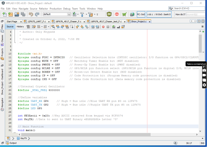

The next step is to build the MPLAB X IDE project to insert the UART code for the PIC12F675 micro-controller.
Launch MPLAB X IDE software
Use the supplied pictures as a guide to build the Project Folder

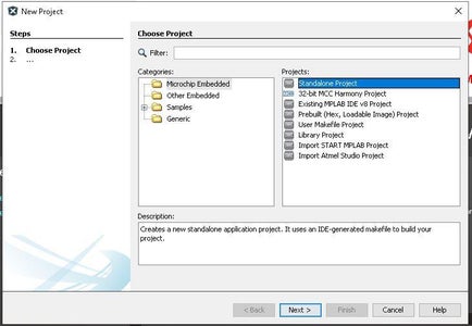

PIC #1Create a new project ( Click on folder)
PIC #2Highlight "Microchip Embedded" and "Standalone Project" (Click Next>)

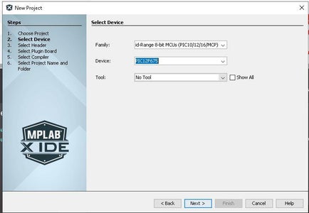

PIC #3 Select Device "PIC12F675"(Click Next>)

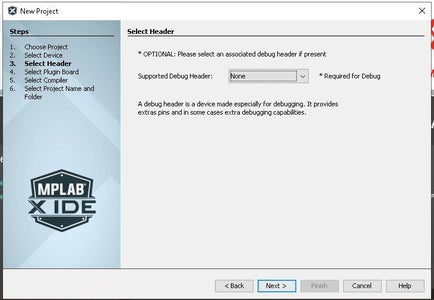

PIC #4Select Header [Leave at "NONE"](Click Next>)

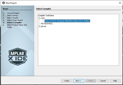

PIC #5Select Compiler [Highlight XC8](Click Next>)

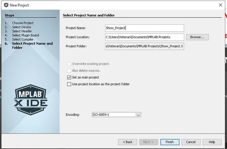

PIC #6Select Project Name and Folder: Type in: "Show_Project" or your own Project Name
Browse for your Project Folder or other folder you created to place the Project: (Click Finish)
NOTE: MPLABX will place the Project in its directory if a different folder is not created and selected

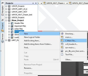

PIC #7In MPLABX select [Projects] in the left bar if not already open and then expand "Show_Project"
Highlight: (Left Click) "Source Files"

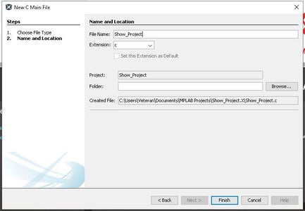

PIC #8Right Click "Source Files" and hover to "NEW" and then Left Click "C.Main File..."
PIC #9[Name and Location] Type-in under [File Name:] "Show_Project" or your own Project Name
PIC #10The "Show_Project.c" folder will open in the main window where to place the code

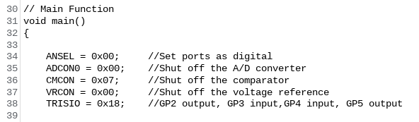

2- This segment explains lines 30 thru 39. View Segment 2 Code video:
Refer to the picture "PIC12F675 General Purpose I/O Byte"
TRISIO = 0X18 command 00011000 reading from the right most bit GP0 to GP5. GP0 and GP1 not used, GP2 output is the TX data line, GP3 input is not used but is the MCLR and must be an input for the PICKit3 to program the PIC12F675, It can then be used for an external input in the code, GP4 input is the RX data line which is not used in this project, GP5 output is for the LED. GP6&7 is not used on the PIC12F675.

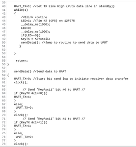

3- This segment explains lines 40 thru 78. View Segment 3 Code video:
Refer to the picture "Basic Example of UART Protocol" and "UART Protocol Data Transfer Basic Diagram"
Example data byte 01010101
The data byte sent from the PIC12F675 consists of eight data bits labeled 7 to 0. The eight bits are indexed from the right most bit referred to as bit 0 to the left most bit referred to as bit 7.
The indexing of the eight data bits labeled 7 - 0 from right (0) to left (7) conforms to UART protocol. In UART data transfer the least significant bit (the rightmost bit in the Example data byte (1)) is sent first. Then the remaining bits are sent with the most significant bit (the leftmost bit in the Example data byte (0)) sent last. The transfer order is (0-1-2-3-4-5-6-7)
Referenced in the code the shift left << command followed by the bit index 0 - 7 is as follows.
( <<0 no shift, read bit zero (The least significant bit) which is data bit 1 in the Example data byte 01010101
( <<1 shifts one bit to the left of the least significant bit which is data bit 0 in the Example data byte 01010101
( <<2 shifts two bits to the left of the least significant bit which is data bit 1 in the Example data byte 01010101
( <<3 shifts three bits to the left of the least significant bit which is data bit 0 in the Example data byte 01010101
( <<4 shifts four bits to the left of the least significant bit which is data bit 1 in the Example data byte 01010101
( <<5 shifts five bits to the left of the least significant bit which is data bit 0 in the Example data byte 01010101
( <<6 shifts six bits to the left of the least significant bit which is data bit 1 in the Example data byte 01010101
( <<7 shifts seven bits to the left of the least significant bit which is data bit 0 in the Example data byte01010101

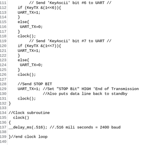

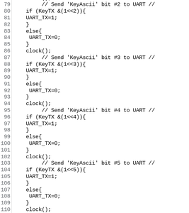

4- This segment explains lines 79 thru 110. View Segment 4 Code video:
5- This segment explains lines 111 thru 140. View Segment 5 Code video:
The data transfer is set for 2400 bps baud rate which equates to 1/2400 = .000416 seconds or .416 mili-seconds. In the program the data transfer delay is set for .516 mili-seconds which works as an offset in the code execution time. Because this is a programmed time delay and not a crystal frequency divider routine the delay timing is within an error factor but works in this program. Based on researched articles, the transmitter data bit retention time and receiver clock pulse can be within a 10% error on a data transfer. Viewing the picture above it shows the receiver clock pulse reading the data bit somewhere around the mid point of the data bit retention time in order to verify a valid read. Not too close to the rising or falling edges of the data bit.
