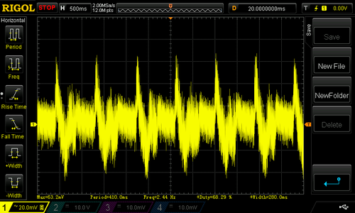

The sensor interfacing is very similar to the source document I told you about in the first step, but I tweaked the values a bit to get a better signal in each stage. The filtering is basically the same, the C4 = 4.7uF and R6 = 68K form a high-pass filter of ~0.5Hz while the C4 = 100nF and R3 = 680k. The stages also have some gain, 11x and 310x respectively.

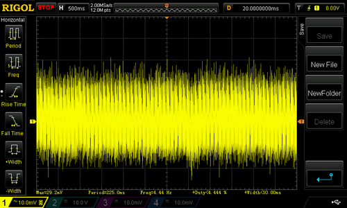

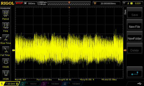

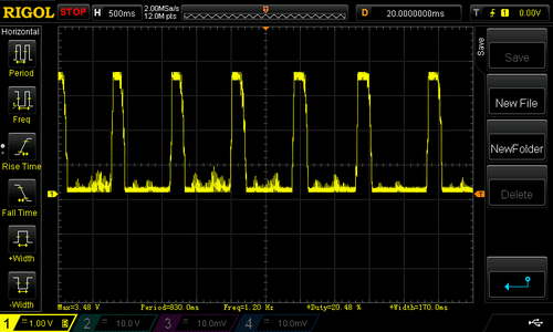

I added some oscilloscope screenshots to the image section of this step, see how the very noisy signal coming from the sensor collector slowly turns into something useful. The measurements were taken on the sensor collector, R6, R8 and finally R10. R10 is routed directly onto the CCP1 pin of the microcontroller and an edge-detection is implemented which starts the measurement cycles.
One thing you must take care of is to keep the infrared LED current down, otherwise the whole thing gets incredibly sensitive and you will not be able to measure any heart rate. I found that with a 220R resistor this thing could be used for distance measurements quite easily. I ended up adding a 2K trimmer resistor, tuning the resistance until I got some good BPM readings, then measuring & replacing the thing with a fixed resistor of 1.5K.

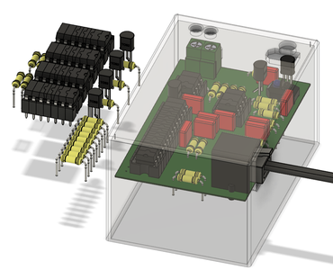

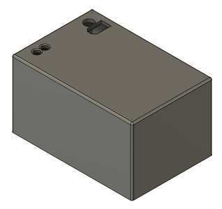

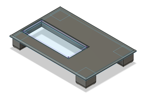

For the enclosure design I used Fusion 360. I am actually still very far from being a 3D designer, but I am slowly able to design simpler enclosures and models - I bought a cheap course on Udemy, so far it is very good. I used to use TinkerCAD but wanted to get a bit more serious and try something for the more advanced.
I exported a STEP model from Altium Designer to avoid taking hundreds of measurements - the component outlines can be projected on sketches making cutouts very easy to add on the enclosure extrusions. I don't know if TinkerCAD supports this, I didn't see this so far and it was a very useful feature for this project.
