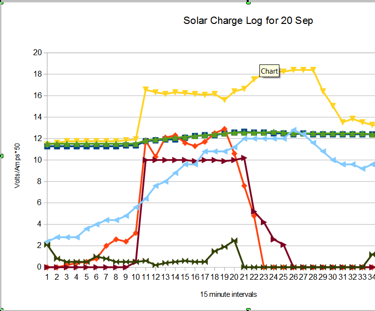

It is a remote acquisition system, where another computer (PC) can collect data via the serial port for graphic display. ( It has been used as the front end of ECG project).
It has a logging facility (for data logging over hours), results are uploaded from EEPROM.
