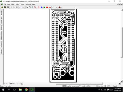

Step 2: PCB Design
This design will try to leave the most compact possible, for attachment to any application, whether in breadboard or PCB.
May leave some devices it was below pic, such as resistors, ceramic capacitors and crystal oscillator.
In designing the option was left to decide which voltage feed, either by USB or external source.
I was working at PCB Wizard and I leave designs.
