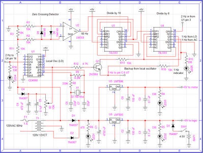

Step 3: Circuit Diagram 1 Explanation
Here is a high level explanation of how the circuit in drawing 1 works:
120 VAC is supplied to transformer T1 which converts it to 12VAC (max 1A) centre tap, so we have 6VAC from the center tap to each side of the secondary. This is rectified with D1 and D2 and filtered by large 4700 uF capacitor C1 and this gives us about 9VDC. This is an ideal level for supplying voltage regulators U6 and U5 which provide us with regulated +5VDC and +6VDC for the logic circuit and water pump motor respectively.
A sample of the 6VAC sine wave on the secondary of T1 is supplied via R11 to the zero crossing detector circuit at top left of circuit drawing 1. R1 - R3 pad the voltage down and provide current limiting. D5 and D6 prevent overdriving of U2. This op-amp will have huge open loop gain and so any small difference between the voltages on pins 2 and 3 of the op-amp will cause the output on pin 1 to swing between ground and +5V. These transitions will take place as the incoming sine wave crosses over the zero voltage line, hence the name zero crossing detector. This has the effect of producing a 60 Hz square wave on U2 pin 1. The frequency of the incoming 60 Hz sine wave will vary slightly as the load on the overall power grid varies but over long periods of time it will, on average, be extremely accurate, so our circuit timing will also be very accurate over extended periods of time too.
The 60 Hz square wave on U2 pin 1 is then fed into U3 (74LS93) which is a shift register set up as a divide by ten counter which is then fed into another shift register U4 set up as a divide by 6 counter. So if we take 60 Hz and divide by 10 then by 6, in effect we are dividing by 60. This give us a 1 Hz square wave on the output of U4 (Q3, pin 11). This output is then fed to transistor Q1's collector via R13. Q1's base is connected to potentiometer R7 and so Q1 is controlled by the voltage on R7's wiper. So why is this set up this way?
When we lose AC power and the circuit switches to battery backup, we still want it to keep time. U1 in combination with the resistors, capacitors and crystal connected to pins 9 and 10 of U1 create a local oscillator that provides a 2 Hz signal even when we only have DC battery backup power. This 2 Hz signal is fed into the spare register on the U4 shift register to provide a 1 Hz signal derived without the benefit of the incoming 60 Hz signal. When 120VAC is present 6VAC power from T1's secondary is rectified by D4 and filtered by C4. There will be about 8 to 9 VDC across R7 when this is done. Potentiometer R7 can be adjusted so that there is approximately 4.6 to 4.8 VDC on the wiper of R7. This voltage is fed to the reset pin of U1 and to the base of Q1. So this voltage acts to indicate indirectly if AC power is present.
When AC power is present, U1's reset pin (pin 12) is held high and this local oscillator is shut off. Meanwhile Q1's base is high and it is turned on. The 1 Hz signal derived from the power line (from U4 pin 11) then appears on Q1's emitter and is fed into the microcontroller for timing. Should the incoming 120VAC power go out, then U1's reset pin will go low and it will start up and begin to supply the local timing signal. Meanwhile Q1 will be turned off. So if pin 11 of U4 happens to be in a low state at the instant AC power is lost, it cannot also pull the line supplying the local 1 Hz signal (U4 pin 12) low and prevent it from working. So when AC power is lost the voltage on R7's wiper goes to zero, U1 starts up and Q1 is shut off ensuring that the signal from U4 pin 12 keeps clocking the microcontroller unimpeded. Note that the LED indicator on U1 is connected to pin 3 the source of the 2 Hz signal. This is deliberate, if U1 is active this LED blinks at twice the rate of the normal operating 1 Hz LED so that it is visually easier to notice.
A note on setting pot R7; before connecting U1 pin 12 to the wiper of R7, connect a voltmeter from ground to R7 wiper and adjust the pot until you read between 4.6 and 4.8 VDC. This ensures we don't put too high of a voltage on U1 and damage it. Also to protect U1, we don't want to adjust the voltage all the way to +5V to give some leeway in case there is a surge on the power line causing it to exceed the 5V limit for U1.
Battery BAT1 consists of 3 AA cells in a battery holder which gives us a 4.5VDC battery backup. When the 120 VAC supply is present and +5VDC is supplied by U6, then diode D3 will be reverse biased and virtually no current will flow out of the back up battery. If the 120VAC hydro goes out, as it often does due to summer thunderstorms in my area, then the +5VDC supply from U6 will drop to the point where D3 begins to conduct and we will supply approximately 3.8VDC to the logic line. This is enough to keep our logic running for a short time, however not enough for U8 the LCD to present a display. So this battery backup is just intended to keep the microcontroller running and keeping time during short power outages or power bumps.
