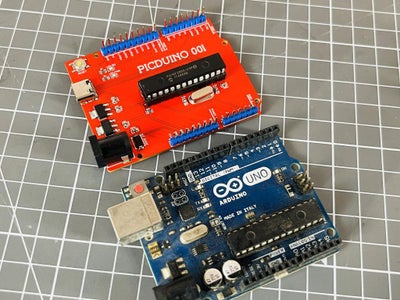

I am hoping to design a minimal board, overall a system that is compatible with Arduino UNO. And for this I choose two linear voltage regulators, a USB type C port for power and programming purposes, and the same compatible headers to ARDUINO UNO. I have added a header for programming through the PIC kit directly. The circuit diagram shown above and sectioned properly. 12V connector for the external adaptor power.

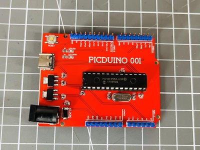

Step 4: PCB Layout:
The PCB layout turned out to be the same as the Arduino’s one. The chip at the centre, oscillator nearby it. Some decoupling capacitors. The power section at the front end with all capacitors, led’s and power indicator at the top right. 12V jack and USB for power and programming, with ICSP at the same place.

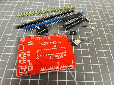

Step 5: Assembly Process:
After ordering the PCBs I assembled in my lab under a microscope, USB type C is one of the most difficult task to solder with hands. If you do not want to mess with such things, you can try PCB assembly services from PCBWAY. I gathered all my components at one place and soldered them one by one, starting from the SMD ones to DIP and pin headers. It took me around 1 hour.

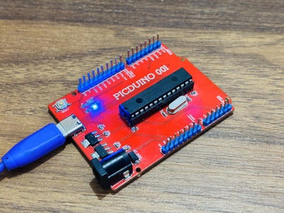

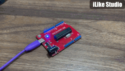

Step 6: Uploading the HEX File With PIC Kit:
I Have made the hex file, in the previous getting started tutorial which is basically a blink program. I connected the IC with onboard headers with PIC KIT and wrote this file to memory and here is the result of that. It is working properly, just for testing purposes. There are 2 more methods to program the same, have discussed in the next blogs can be seen through the links here:
Programming the chip with USB
Programming the PICDUINO with pinguino software
The board is in working condition, I have tested all the GPIOs and power sections. The files can be downloaded from GITHUB. Let’s do the programming in part 3. Visit PCBWAY to know more about its services.
