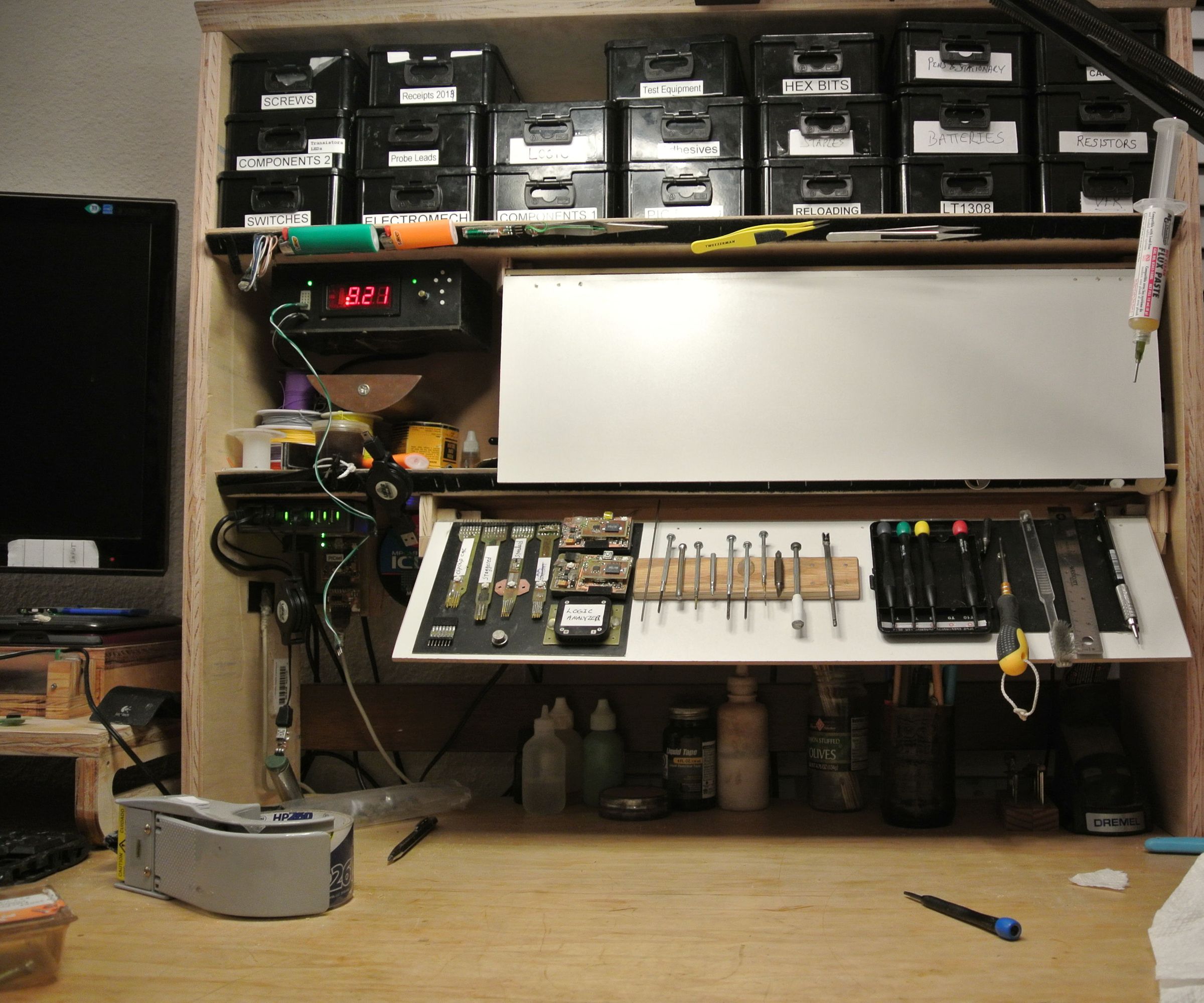

By using a long length of programming cable, I had previously enjoyed a clutterfree desk. I had even made my own "programming button" by hacking my mouse and wiring up the mouse button to my programming setup/socket.
After switching to the PICKIT2, I initially liked the programming button, because I didn't have to stick the wires from the mouse to my programming setup. But having two devices daisy-chained on my desk was annoying, and the button was more difficult to press when it wasn't hardwired to my programming setup, like before.
So that's the point. I know I just lost 99% of the readers. :(

Step 5: Happy Desk
Now your desk will thank you. Your PICKIT2 can now be shoved off into the distance, never to be seen from again, while your programming cable, alone, can take it's place. Here's my seven pin cable, shown next to another random USB cable that I use a lot... the one for downloading pics off my camera so I can make awesome Instructables.
