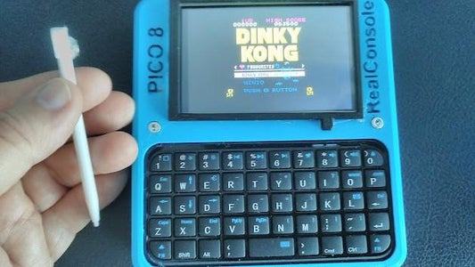

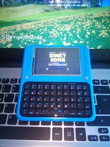

A little computer with Raspberry Pi 3 and the amazing PICO8, a fantasy console. Now it's real in your hands.
I love the PICO8 concept and wished to make a little computer based in Raspberry PI 3 with this software installed. I met PICO8 some years ago and this project has been waiting since then. Finally here it is. In 2020 made other minicomputer but had some failures and finally stopped that project. Now I create this one from zero. I've been inspired by projects like YARH IO Micro 2 or Decktility but have some important differences inside.

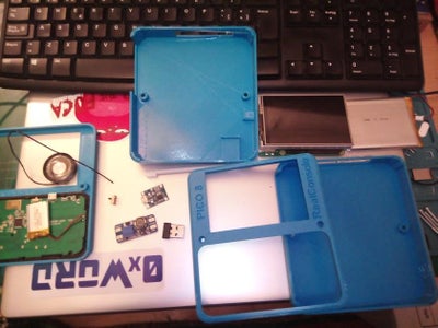

Step 1: All the Pieces Are Ready ?
You need 4 stl files and electronics. I've printed stl files with PLA and 20% infi

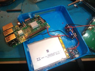

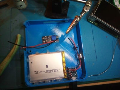

Step 2: Solder Battery, TP4056 and Switch.
Hold them with glue.
Step 3: Solder Dcdc Step-up and Raspberry Pi
Connect to pins 5V and GND in GPIO). Hold the connections with some glue. Adjust the dcdc Vout to 5V BEFORE TO CONNECT THE RASPI.

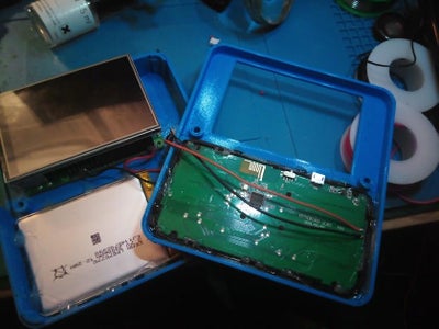

Step 4: Solder the BT Keyboard.
First of all cut the wire of little keyboard battery (only 150mAh). Glue the pieces of the keyboard without its bottom. Solder to 3300mAh in the dcdc DCIN connectors.
Step 5: Glue the Little Piece to the Screen
(not glue to the Raspi).
This adjust the level between Raspi and display. This piece is included in the stl bezel file.
Step 6: Join the Top and Bottom With 2xM3 25mm Nuts&bolts.
The screen must fit in the upper rectangle. After that, glue the bezel. Glue a little magnet in the top of the stick and test if holds correctly in the bezel.
