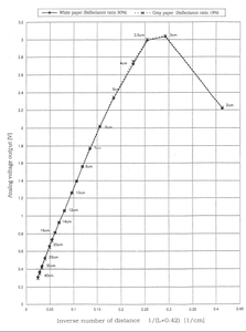

We used the datasheet of the Sharp GP2YOA41SKOF distance sensor to write a programme which calculates the distance of the rolling cylinder from the midpoint.
An essential part of any PID algorithm is the choice of the PID constants. It took us many hours of trial and error to arrive at the values in the code below. However, these might not be right for your own application, depending on factors such as the density of your PLA or the friction coefficient of your specific roll of filament. Therefore, It is essential for you to test and adjust these values, which will be unique to your particular set of circumstances.

float distanceRead(){
 float temp = analogRead(A1)*5;
 if(temp < 400){
  temp += 3000;
  Serial.print("Analog read: ");
 Serial.print(temp);
 Serial.print(" ");
 double distance = 12.94*1024/temp -0.42;
 return distance;
