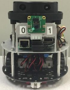

The goal of this project is to get a two-wheeled robot (with a caster) to travel to a coordinate in the world frame as precisely and quickly as possible. We achieved this by generating a reference trajectory based off of a cubic spiral, using encoder readings to calculate the robot's current position in the world frame, and using feedforward and PID to adjust the robot's position so that it approaches the reference trajectory.

These assumptions are made by the Matlab Raspbot Simulation API:
The nominal wheelbase is 9cm. Diameter of the robot is ~12cm
Maximum speed - 0.3 m/s. This is the maximum speed the robot API will accept for either wheel. Beyond that, the API should throw an error message and not cause the robot to respond.
Max acceleration - 10 m/s/s. This is enforced by the PID driver on the robot, not the API. Any higher accelerations cause unstable PID control.
Encoder message rate - 50Hz. These messages are sent by the robot automatically. The simulator may be slower (say 30 Hz) because it is also using up your CPU cycles to do the simulation.
Velocity commands maximum rate - 50 Hz. The API will send these to the robot no faster than 50 Hz.

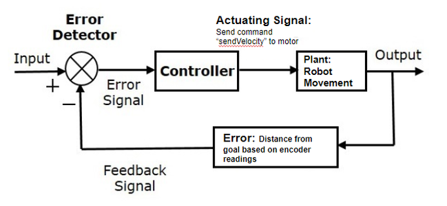

Step 3: Tune P-Controller to Travel 10 Cm in a Straight Line (Kp=3)
Using a proportional controller, we calculated the error as follows:
error_distance = goalposition - current position
where the current position is determined by integrating the encoder readings. That error (distance to the goal) is then multiplied with the proportional gain to produce a velocity command (capped by 0.3 m/s) that we send to the robot.
To calculate the velocity command we do:
command = Kp*error
We started with a Kp of 3, and the robot speeds up initially (error is big) and slows down towards the end (error is small), and does not overshoot 10 centimeters. However, it approaches the target relatively slow (took about 1 second).
Step 4: Tune P-Controller to Travel 10 Cm in a Straight Line (Kp=13)
We wanted to see if we can get the robot to reach the target position faster using the proportional gain. We expected there to be oscillations and overshoot as a result, and that is exactly what we found when we used a Kp of 13:
The controller made the robot move 10 centimeters within 0.5 seconds, but the large overshoot and enduring oscillations made the result unusable.
Step 5: Tune PD-Controller to Travel 10 Cm in a Straight Line (Kp=13, Kd=0.6)
After experimenting with a few derivative gains, we found the optimal Kd to be 0.6. If we set the derivative gain lower and underdamp the system, then the robot oscillates around the destination for too long. If we set the derivative gain much higher and overdamp the system, then the robot approaches the goal slowly.
To calculate the velocity command we now do:
command = Kp*error + Kd*(change in error)
where change in error is calculated by differentiating the encoder readings between each time step.
As you can see in the video, there is a small overshoot but the robot gets there decently fast at around 0.5 seconds.
