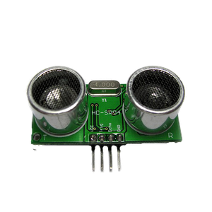

PINGBot is the Explorer Robot that uses an ultrasonic sensor to be able to dodge objects present in its path.
The ultrasonic sensor emits pulses at a frequency of 40KHz (imperceptible to the human ear and animals), these pulses when hitting an object, they are reflected and return to the sensor after a certain time; knowing the total time round the wrists and the speed of sound in the medium (the air), it is easy to calculate the distance traveled by the wrists and thus determine the distance of the object relative to the sensor.
See the post about PING sensor for details in https://www.instructables.com/id/Basic-Principles/

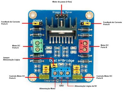

We will use the same chassis of the BUGBot https://www.instructables.com/id/Basic-Principles/ ... but currently with a dual H-BRIDGE / L298H to control two DC motors (control direction and speed), which will give greater flexibility to our prototype.

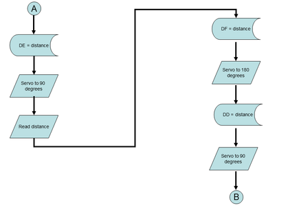

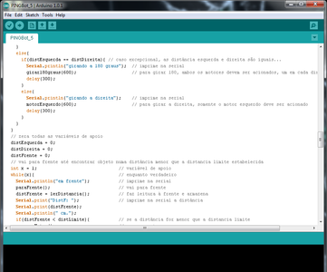

Step 1: Programming Logic
Speaking in terms of logic of programming, we have:
- including libraries;
- initialize variables and constants;
- define and initialize the pins;
- initialize serial communication;
- "BEGIN"
- call routine to stop motors;
- positioning servo to 90 degrees;

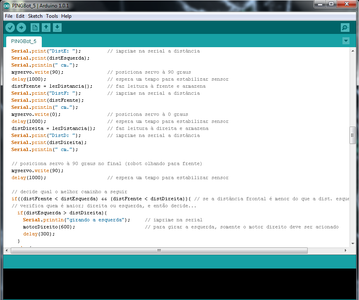

- read FRONT distance and store;
- servo position at 0 degrees;
- read LEFT distance and to store;
- positioning servo to 180 degrees;
- read RIGHT distance and to store;

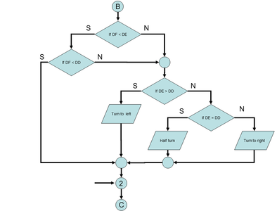

- comparison (1): FRONT is greater than LEFT?;
- yes: - comparison (2): FRONT is greater than RIGHT?;
- yes: - call routine to move forward;
- no: - call routinel to turn right;
- no: - (comparison (1) is less than: - call routine to turn left;

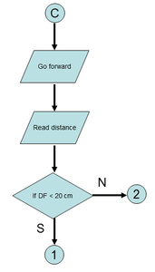

- If any condition is possible (all distances are exactly equals: - move forward and stop for a while, and so begin the cycle again.
- walking distance to detect less than 20 cm;
- loop to the "BEGIN";

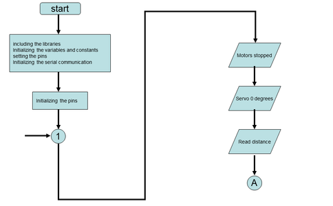

The flowchart show us, how to perform these programming functions (only as example):

1 x Ultrasonic Sensor HC-SR04
1 x Dual H-BRIDGE

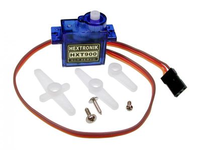

1 x Servo Motor HXT900 9g / 1.8 Kg

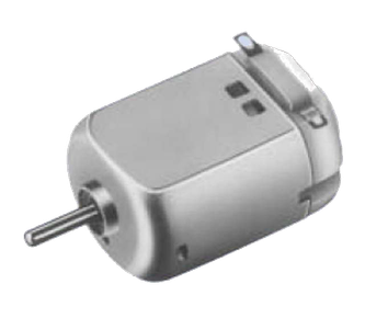

1 x Kit Tamiya Gear Box with two 3-6V DC motors

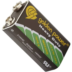

Battery pack to power the Arduino and motors (9V)

5 -> H-BRIDGE port-A enable pin
6 -> H-BRIDGE in1 pin
7 -> H-BRIDGE in2 pin
8 -> H-BRIDGE in3 pin
9 -> H-BRIDGE in4 pin
10 -> to attach the servo motor
11 -> H-BRIDGE port-B enable pin

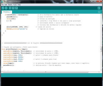

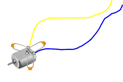

"I had many problems with noise in the distance sensor system, which was solved by
adding 100nF capacitor between pins of the DC motors and their
carcasses (besides the capacitor which is usually added among its pins).

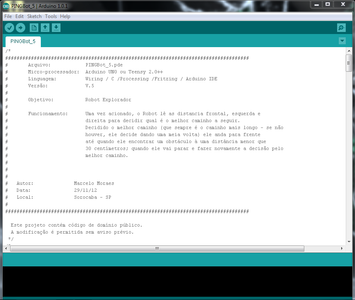

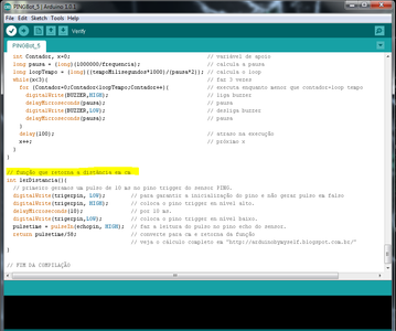

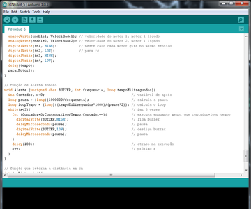

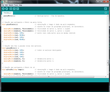

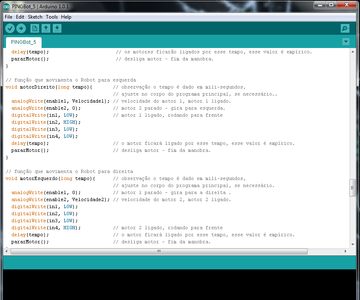

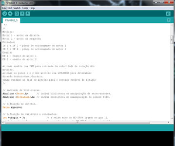

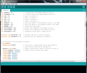

Step 4: Software and Programming
Many versions were created in the construction initial phase of the PINGBot.
It were created a version to manage the DC motors (direction, speed, to turn left, to turn right and for to turn 180 degrees).
And also were created the continous rotation servo motor's version. If you need this version, contact me please and I am willing to help you.
I had a lot of work to do the final adjustments in the Robot (and I think that is not too good so far). First, because the DC motors noise as I already commented, and then for the movements adjust and batery consuption.
About 30 hours were spent in this project. I believe that for any kind of chassis, we will need spent time for the adjustments and debug.
You can download the arduino sketches and libraries directly from the GitHub below:
https://github.com/Arduinobymyself/PINGBot.git

Note that the DC motor battery is rechargeable type ... it helps us to save money and give more energy to the car.
Use a 9V/900mAh Nickel Metal Hydride (NiMH) batery.
