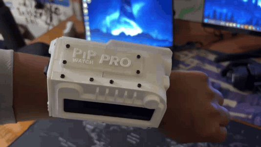

Meet PIP-WATCH, a Pip-Boy-themed internet Watch that brings the retro-futuristic charm of the original device to your wrist, featuring the TTGO T DISPLAY ESP32 S3 LONG that has a super wide 640x180 Pixel screen that we are using as the main microcontroller and display for this project.
If you enjoy Fallout as much as I do, this PIP-WATCH is a great way to keep track of time in a Fallout style.
This is the Updated verssion of my previously created PIP WATCH V1 project that features a smaller GC9A01 Round display and a much smaller and different body than that of an actual PIP boy. In Version 2, we tried to model the device as close to its actual counterpart as possible, featuring the wide body design with a screen placed horizontally. The Clock funstuion remains the same in version 2; we are getting Time data from an NTP server and then it is being displayed on the screen.
In order to power our TTGO ESP32 Microcontroller, we have even integrated an inbuilt lithium cell.
The code used for this project was adapted from the previous PIP WATCH project, the design was made in Fusion360, and this Instructables explains how to make your own PIP-Watch in a few simple steps.

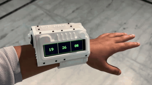

In keeping with the Pipboy theme, PiPWatch receives time from an NTP server and shows the result in green on the round-oled screen.

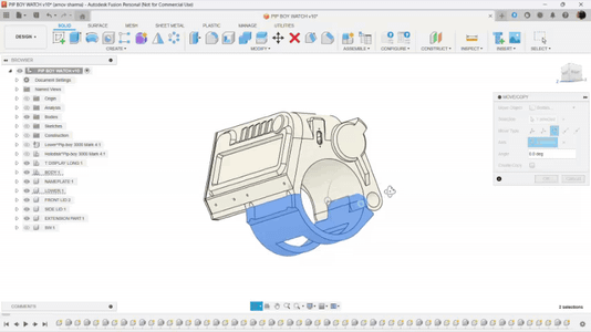

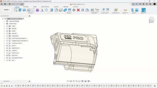

Step 3: DESIGN VERSION 2

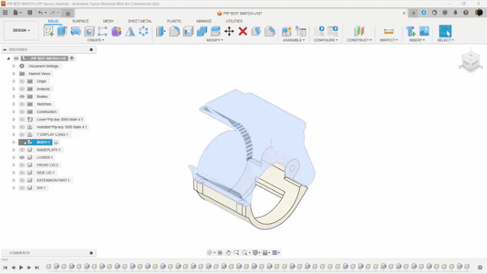

The 3D model was the first step in this project, and our objective was to reuse parts from the previous project.

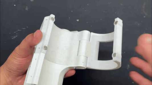

We decide to retain the wrist clamp, which is attached to the main body and pivots on a hinge. In order to keep the hinge clamp part of the watch attached to the body, super magnets are attached to the inside of the clamp and body. The hinge part of the watch is secured in place by these magnets. It can be worn by applying some force to the magnet joints, which will open the clamp and allow the user to put the watch on their wrist.
To make it easier to mount the TTGO Display horizontally, we simply modeled a new holder around the main body while maintaining the same structure. Additionally modeled was the new screen holder part that secures the display.
A rocker switch that will be used to turn the setup ON or OFF has been added to the lid part, just like in the previous version.
To show that this is a newer version of the PIP WATCH PROJECT SERIES, there is now a nametag that says PIP WATCH PRO.
Once the 3D model was finished, we exported the mesh files and used our ENDER 3 to print all of the parts in white PLA.

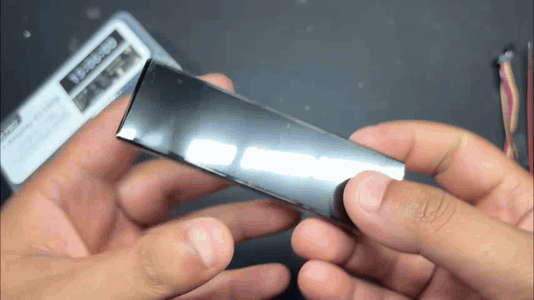

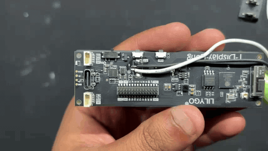

Step 4: TTGO T-DISPLAY ESP32 S3 LONG
The Liligo TTGO T-Display S3 Long, which is the brain of this project, is powered by an ESP32-S3R8 dual-core LX7 microprocessor and provides strong performance for demanding applications.
It is perfect for connectivity projects because it has Bluetooth Mesh, BLE 5, and Wi-Fi 802.11. It can easily handle complex graphics and multitasking thanks to its 16 MB of flash and 8 MB of PSRAM.
Its most notable feature is the 3.4-inch capacitive touch TFT LCD, which uses a QSPI interface and has a 180 × 640 RGB pixel resolution, making it ideal for touch-enabled, long displays.
I think LILIGO should have created a proper wiki to make this amazing hardware user-friendly because I had a very difficult time figuring out exactly how we can use this display and had to rely on the Volos Project Video about the TTGO T DISPLAY S3 LONG Board. The information on this display is very limited; by limited, I mean the documentation is very weak. I suggest you should watch Volos Video on the board because it goes into great detail regarding essentially every aspect of this display.

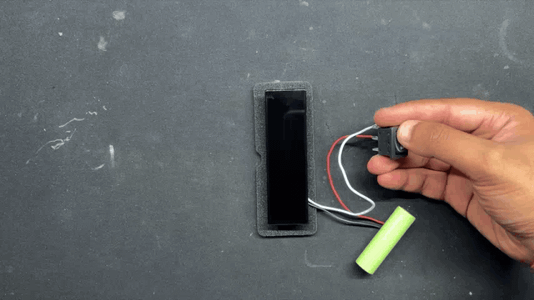

Step 6: WIRING PROCESS

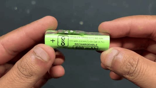

The first step in the entire process is to connect our power source, which is a 14500 3.7V 600mAh Li-ion cell with a PCM.
The PCM has a DW01 Circuit that gives the cell low and high cut features, which are necessary for charging and discharging the cell correctly without causing a blast.
- First, we connected the lithium cell's positive and negative terminals to the TTGO Board's positive and negative battery terminals.
- Next, we attached a switch between the TTGo board and the battery connections. We soldered one end of the positive wire from the battery to the switch's NO terminal, and the switch's NC terminal is linked to the TTGO battery terminal's positive terminal. To break power between the battery and the TTGO board, we installed this switch between them.

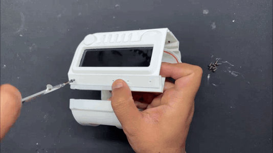

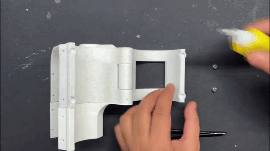

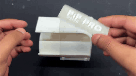

Step 8: BASE FRAME ASSEMBLY PROCESS
- We now start the project's Body build, which starts with setting up the project's Base. We fasten the main body with the lower clamp part using M2.5 bolts.
- The extension part is then positioned over one side of the main body, its mounting hole is aligned with the main body, and an M2 screw is used to fasten them together.
- The nameplate, which essentially holds the main body and extension section together with four screws positioned in corners, is installed in place once the extension part has been placed.

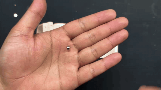

- Next, we add tiny magnets with a diameter of 5 mm to the main body and clamp part. Our first step is to apply a drop of super glue to the magnet's clamp mounting place. This will ensure that the magnet remains in place permanently.
- Similar to this, we add magnets to the main body by following the same process, but we make sure to face them in the correct direction since this section employs two magnets to create a magnetic lock, and magnetism is crucial in this situation; utilizing the same poles on the same side will break the entire system.

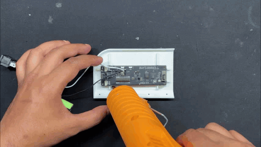

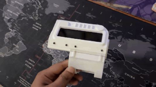

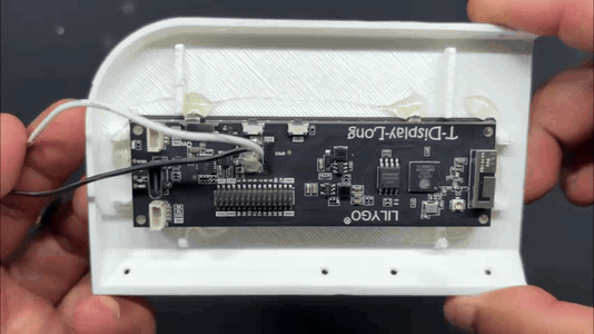

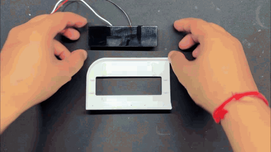

Step 9: SCREEN HOLDER & DISPLAY ASSEMBLY
- Now that the TTGO Display is positioned over the screen holder, the screen side of the TTGO T Display board is facing out.
- We apply hot glue to the entire board's perimeter to keep it in place. This will create a connection between the display and the screen holder.

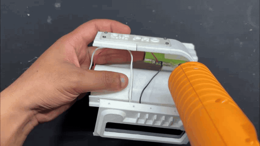

Step 10: BASE FRAME & BATTERY ASSEMBLY
We now proceed to the battery assembly phase of the build, where we insert the lithium cell into the main body and secure it in place with hot glue.
Step 11: BASE FRAME & SCREEN HOLDER ASSEMBLY
After positioning the screen holder over the main body, we fasten it to the main body and extension part using eight M2 screws.

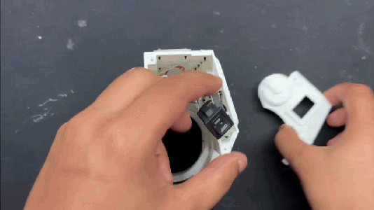

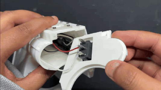

Step 12: LID ASSEMBLY
- The next step was the lid assembly, which starts with desoldering the wires from the rocker switch so that we can insert the rocker into the opening on the lid part. After positioning the rocker switch, we reattach its wires.
- After that, the lid is pushed into place and fastened with two M2 screws to the extension part.

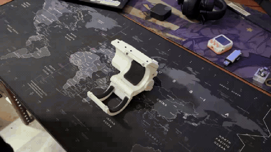

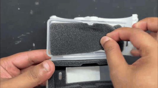

Step 13: CUSHION SUPPORT
- The cushion support on the inside of the hand clamp is one of the last finishing touches that we need to add to this project, which is almost finished. This thin foam sheet was included with the TTGO T Display package; we will cut it into pieces and place it inside the clamp part.
- We completed the assembly process by first applying two long foam cutout pieces to the clamp part using hot glue, followed by the addition of a rectangular foam piece to the main body.

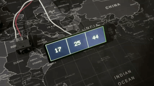

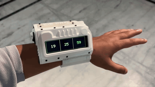

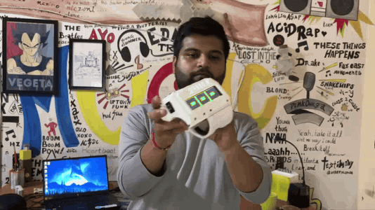

Step 14: RESULT & CONCLUSION
This small project Resulted into a fully functional PIP WATCH PROJECT, a PIP Boy-inspired watch built from scratch that connects to the internet using an ESP32 and an NTP server to retrieve time data, which is then displayed on a Liligo TTGO T-DISPLAY S3 LONG.
In order to wear this device, we have to first fully open the clamp, place our hand between the clamp and the main body, then use the super magnets to close the clamp part, latching the wristwatch.
