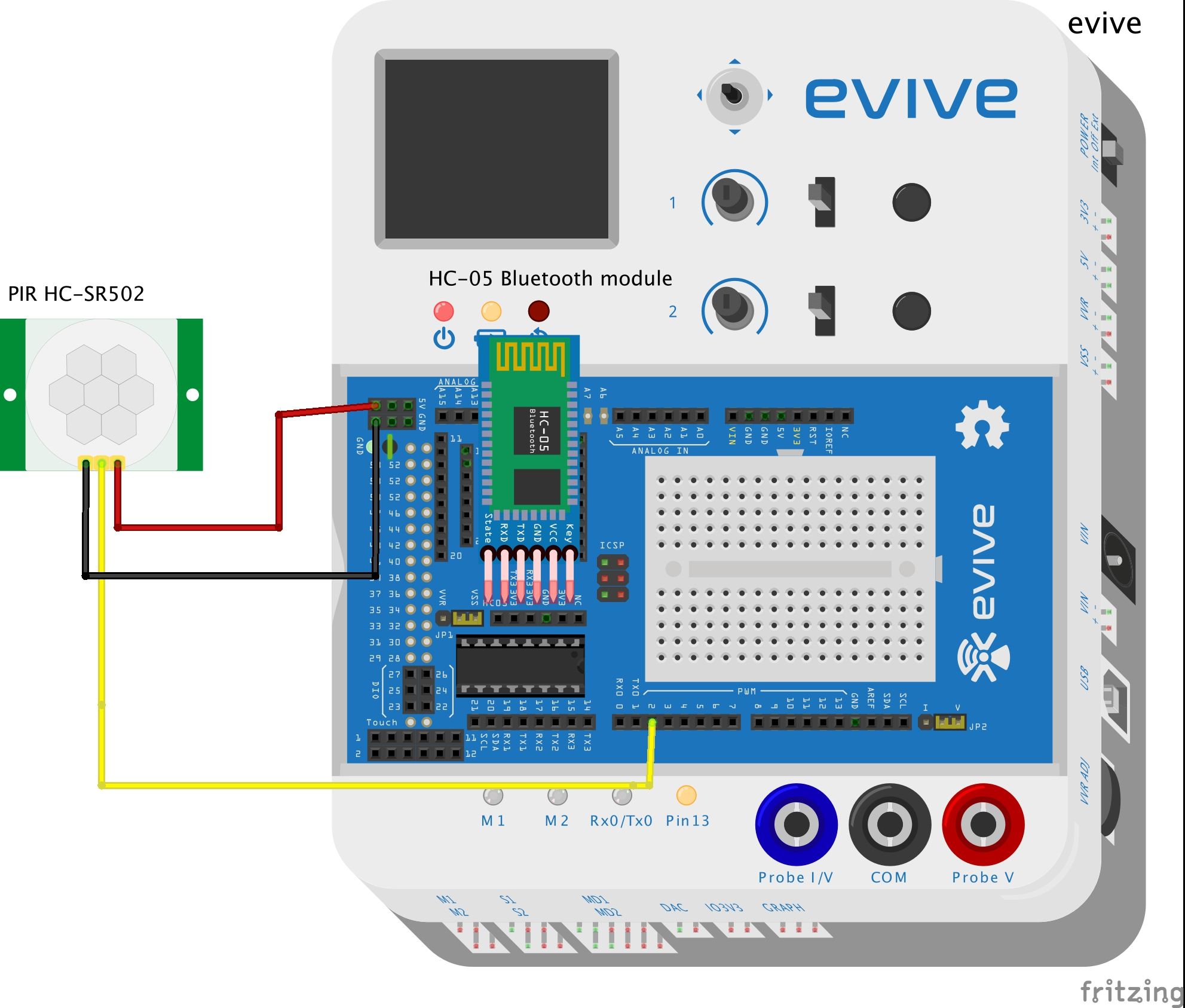

Step 3: Making the Connections
Make the connection as shown in the figure:
