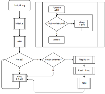

After you have put your music to the pi you can test if everything works as expected, using following command:
sudo python pirma.py
Now you should hear a "woooup" which tell you the script is running and the PIR sensor is armed. Now if you trigger the motion detection, you should here your music start playing. After finish playing the script will hold for 10 seconds before rearming. It will also not arm if the input is high, means it will not retrigger if there is continues motion.
If you have a button, you can stop the playing and directly rearm with it.
I had some Problems with long term run, Pygame or Alsa seem to crash after about 5-8 hours. So I made the Script to Restart itself after playing the audiofile. Also added a restart when the Script is armed for more then 4 hours without motion. With this changes, the script has proven to run without a problem for more then 50 hours straight. Even though, for our application this wasn't needed, since the museum is open for about 4 hours and the system is without power when the museum is closed. So any time the museum opens there is a fresh boot of the system and before the script would hang the museum closes.
