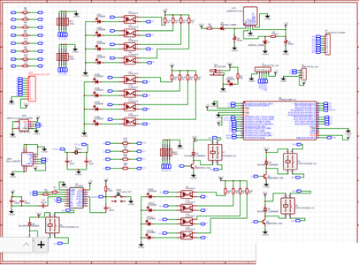

Step 1: SCHEMATIC DIAGRAM
Like all my projects, I share the schematic diagram so that you can do it yourself. The schematic diagram was designed in EASYEDA, a very professional and free electronic circuit design software, we can observe the electronic components that we use for this project and their respective values.
Sometimes the schematic diagram is not very noticeable as an image and that is why I share the PDF file where you can see it in great detail and very visible.
PDF:
https://mega.nz/file/mIA3ibpR#r5QKzchQfV_6cQgoh4r2SdS0iQB1VJmO3hZEupYfzcg
Step 2: FUNCTIONING
Firstly, the power supply of the project is 24VDC, so we control the 24VDC coil micro relays and internally it has a fixed LM2576S regulator.
DE 5VDC for all ICs such as the microcontroller and the communication chip that use 5vdc
We have 8 digital inputs from I0 to I7 controlled at 24VDC all inputs are isolated by PC817 OPTOCOUPLERS that are optotransistors and also the same operation of the digital outputs in this case we have 4 relays.
It should be noted that this project is designed in the SIEMENS LOGO, which is a plc with 8 inputs and 4 outputs, so we have done it similarly and thus we have our own plc at LOW cost
The programming is direct to the PCB itself since we have included the communication with the integrated CH340C that will allow me to load my program from the PC to my own PCB

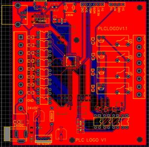

- 1 PCB

This project was made in the Easyeda software as we can see the tracks and the 3D image of the project working perfectly are no difficulty
