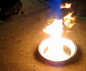

as soon as you hear or see that there is a tiny fire grab your extinguisher and tighten the adapter piece down all the way. then grab the baking soda canister and pour a generous heaping into the platter made form the spoon or scrap metal. point at the base of the fire and began to unscrew the canister. NOTE: twist the canister, not the adapter piece keep the adapter rig pointed at the fire.
there are some fires where baking soda is not required. if you just want to put out some candles on your birthday cake, or extinguish that guy's cigarette who is standing next to you, skip the baking soda and just let rip some co2.
check out these videos to see the extinguisher IN ACTION:
when i was putting out the candles i had low pressure with no baking soda which is why it didnt work well
the pan was filled with cooking grease and i used full pressure with the baking soda
