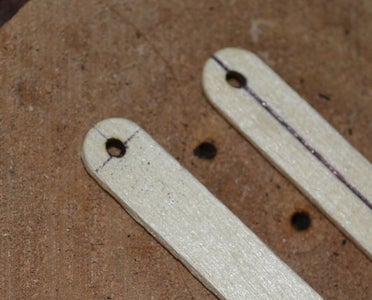

Step 2: PREPARE THE STICKS
-Cut one of the stick in half and sharpen one edge;
-draw a line in the exact middle of it (lengthwise);
-draw a line in the exact middle of the intact stick (crosswise);
-make 2 holes at the edges of the intact stick and one in the side of the half stick (like in the photo).
