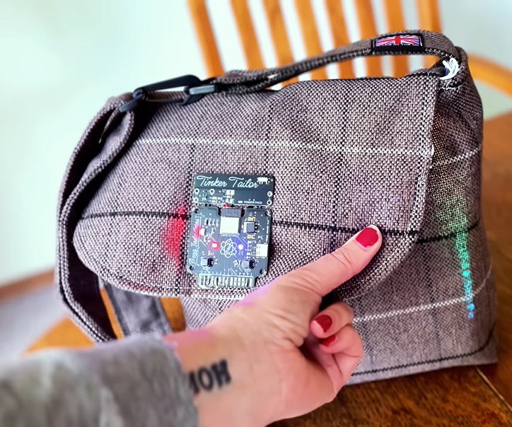

Step 6: Now Make Something With Your Fabric - How About a Bling Bag?
You can also follow on to my other Instructable that shows using this unique fabric to make a bag to hold your items, such as pens, pencils, or other small things to carry with you.
Yes, you can sew a bling conductive touch bag with this fabric, and I've created an instructable for that too!
