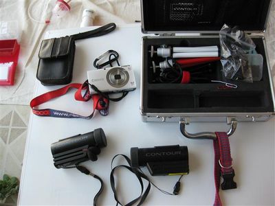

  1. Camera sub box: video, digital camera, mini tripods
Loose
  1. Laptop
  2. mp3 player
  3. stool for sitting
  4. full size tripod
