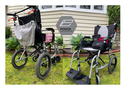

I'm an ambulatory wheelchair user, I use the Karma-ERGO LITE Ultra-Lightweight Folding Transport Wheelchair and realized that I needed more places to put my belongings and shopping. The solution is POUCH Wheelchair Accessories that improve the user experience, sustainable, shared, modular and accessible. These instructions show you how to make the Molle system and have links to the Molle and shopping bags.

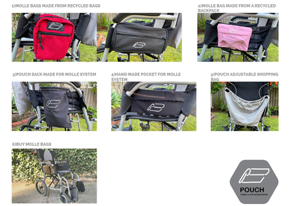

Step 1: Options for Molle and Shopping Bags
Bellow are links to the instructions
- Molle Bags Made From Recycled Bags, Part of Pouch Wheelchair Accessories https://www.instructables.com/Molle-Bags-Made-From-Recycled-Bags-Part-of-Pouch-W/
- Molle Bag Made From A Recycled Backpack, Part of Pouch Wheelchair Accessories https://www.instructables.com/Molle-Bag-Made-From-a-Recycled-Backpack-Part-of-Po/
- Pouch Sack Made for Molle System, Part of Pouch Wheelchair Accessories https://www.instructables.com/Pouch-Sack-Made-for-Molle-System-Part-of-Pouch-Whe/
- Hand Made Pocket for Molle System, Part of Pouch Wheelchair Accessories https://www.instructables.com/Hand-Made-Pocket-for-Molle-System-Part-of-Pouch-Wh/
- Pouch Adjustable Shopping Bag, Part of Pouch Wheelchair Accessories https://www.instructables.com/Pouch-Adjustable-Shopping-Bag-Part-of-Pouch-Wheelc/
- Buy) The first option is that you can buy a Molle bag to use on the Pouch side Molle system. Here is an option you could buy https://platatac.com/catalogue/pouches/platatac-accessories-large-mk3.html
You can use them to attach to the Karma wheelchair system bellow or just make a sustainable Molle bag

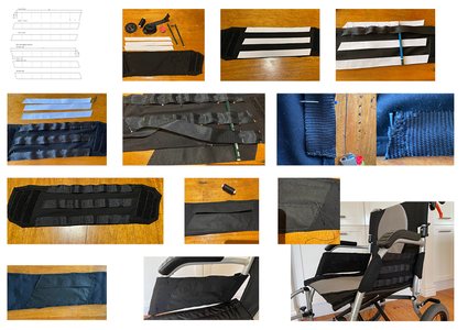

Step 4: Templates
Print templates to use. In the photos I showed making the right side Pouch Molle system using the right side template.
Step 5: Fabric: Molle System Part
- Collected materials
- Used template to cut two layers of fabric, the bottom one with a 1.5cm seam allowance
- Pinned, ironed and sewed seam

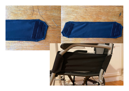

Step 6: Velcro: Molle System
Cut and sewed Velcro

Step 8: Sewing Webbing to Molle System
- Collect the materials for the webbing part
- Cut and heated the edges of the webbing
- Pinned the webbing using the webbing template as a guide
- Sewed webbing
- Finish sewing sides of pocket
Step 9: Add to Wheelchair
My wheelchair has existing velcro that I used to attach the new Pouch Molle system sides.
Step 10: Enjoy
I hope this wheelchair POUCH Molle system is useful and if your interested you can also make the POUCH Bags,
