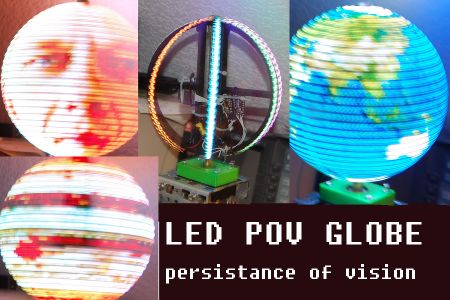

Here comes the core ! Printed with my 3d printer but as i said above there are also other options. To save weight i have many holes place in the frame. Now cut two strips off, each with 32 LEDs. Better count off several times before using the scissor :-)
Placing the strips is a littly bit tricky. You have two strips/columns that generates odd and even lines. The odd lines are at one side of the ring, the even lines are at the opposite. Mark LED number 16 at each strip (respectively line number 32 and 33) and fix it at the frame like showing at the pictures. One led fits exactly between two opposing LEDs. So you have two place the second strip with an offset !!!
After that you can fix the PCB/PCBs, i made small slots in the bracings so the PCBs can easily attached.
Before you mount the ring on the shaft, you must balance it. Use a thin stick to balance and screws or nuts as counterweight.

Step 9: Bring Into Service
Ok, first we only copy the test picture to the sd card.
- If the ring is manually rotated, the LEDs must flicker every time the hall sensor passes the magnet.
- now start the motor and increase the rotation speed until the LEDs are aligned (see the 2 pictures)
- the Voltage has to be constant and the ring must turn slighty to get a stable/aligned picture
- connect the arduino terminal to the motor control
- notice the shown value
- stop the machine
- replace the value to variable "startPos" in the POV_MotorControl sketch
- flash arduino again
Next time you start the motor you'll get the right speed.
The next step is no longer necessary with the new software, from a speed of 38 to 44 rps the odd and even lines are "locked" correctly.
(Use the up/down buttons for fine tuning if necessary.)
Now you can "fill" the card with your other pictures.
Have fun !!!!!!
