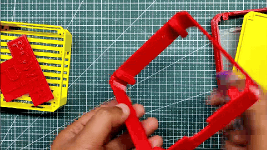

Step 4: 3D Parts
Printing all the Power Pi components, including the Circuit Holder, Raspberry Pi Holder, Bottom Lid, Middle Section, Top Lid, and Power Pi Logo, is the first step.
Yellow and RED PLA was used to print all parts with a 0.4mm nozzle through a 0.2mm layer height and 20% infill.
Here's a tip: if you have stringing issues, use a lighter flame to melt the strings away. However, act quickly because flames can also damage prints.

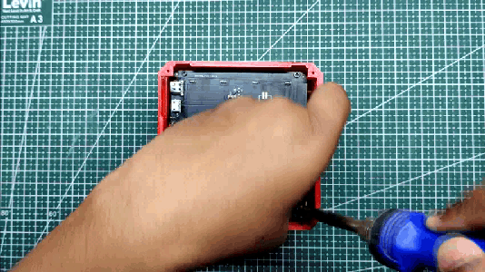

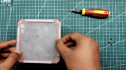

Step 5: Power Module Assembly
  • The Middle Part is mounted first with the circuit holder, and then the Power Module is added in the Circuit holder section to begin the assembly.
  • We then secure the circuit in its place using four M2 Screws

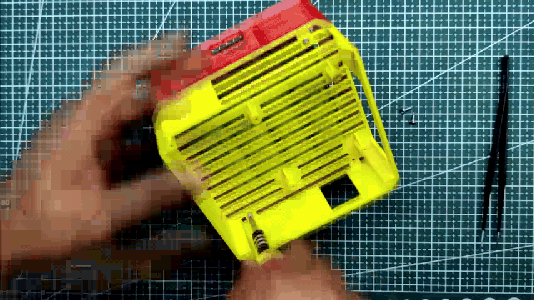

Step 6: Raspberry Pi Holder Assembly

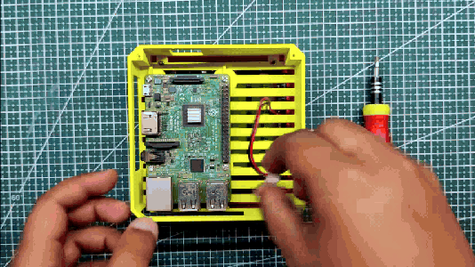

  • The Raspberry Pi Holding Part is then placed on top of the previously put together circuit holder, and four M2 screws are used to join the two components.
  • The Raspberry Pi is then secured in the Pi Holder using four more M2 screws.
Step 7: Connecting Power Module With RPI
  • Using a soldering iron, we add the positive wire of a CON2 Wire harness to the circuit's 5V + and connect the harness's negative wire to the circuit's GND in order to power the Raspberry Pi from the Power management circuit.
  • The Raspberry Pi's GPIO 5V and GND are then connected to the CON2 wire harness connector; doing so will enable us to power the Pi via the GPIO Port.

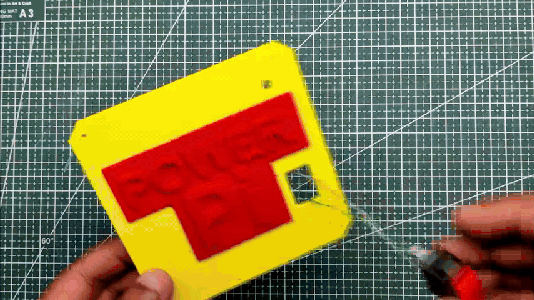

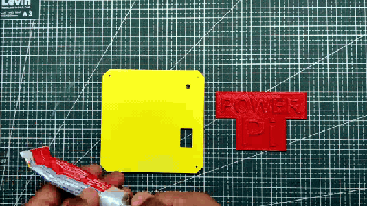

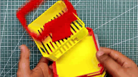

Step 8: LID Assembly
  • The top lid assembly is simple; first, we connect the Power Pi logo to the middle of the lid with super glue.
  • Rocker switch is then set in its spot and pressure-fitted there. Rocker switch remains in this position.
  • With a soldering iron, we next connect the switch's two wires to the circuit's push button; the wires are soldered in parallel with the switch. (In essence, we are expanding the switch that is already in the circuit here)

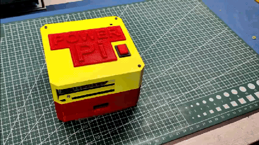

Step 9: Putting Things Together
  • Four M2 screws are used to firmly attach the lid to the central body after the wire has been connected.
  • The bottom lid is attached to the main body using four M2 screws in a similar manner.
Step 10: RESULT

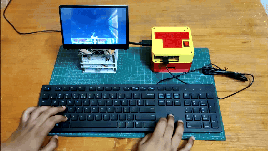

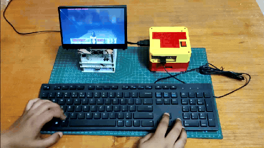

Step 12: DOES IT RUN DOOM?
Here's the crucial question: Does it run doom?
Yes, it does run doom.
The Raspberry Pi 3B+ is powerful enough to handle doom.
This system is functional and is powered by the lithium cells that are the on-board power source.
This configuration is completely portable and wire-free in a sense because the Mini HDMI screen is powered through the USB port on the power Pi.
This configuration is portable because we don't need an AC adapter to power the PI or screen, so we can take the Pi everywhere we go.
