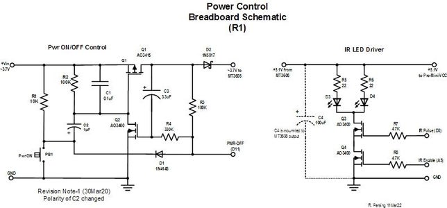

  • Build a simple circuit that provides auto power OFF and drives the IR LED transmitter
  • Interconnect all of the components and modules
  • Print an enclosure using a 3D printer using the STL files provided
Several pre-assembled modules are used to simplify construction and wiring. However, there is one custom circuit module that you must assemble. This can be done using a perf-board or by making your own PCB (Printed Circuit Board). Detailed drawings are provided for both of these methods.
 An assembly drawing for this circuit shows where to place the components on a typical perf-board. Also provided is the artwork to make your own PCB (printed circuit board) if you choose. There are several sources for information about making a PCB at home. Several “Instructables” (do a search for “PCB” within the “Circuits” group) as well as many on-line videos such as this video and others offer techniques for getting the job done. Do an on-line search for “how to make a PCB at home”. Of course, the PCB approach is optional. Point to point wiring on a perf-board will work nicely if the provided layout is used. Remember, it must fit into the remote-controller’s case. During the development of this project, I first used a perf board with point to point wiring but decided to add PCB fabrication to my learning challenge. My final assembly did make use of a home-made PCB.

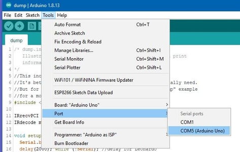

Set the IDE Port to be the same number as that used by the Uno-USB connection. In my example the Port is showing as COM5. Your port number will most likely be a different number.
                Select Tools / Port / COM?   (The ? will be your port number)

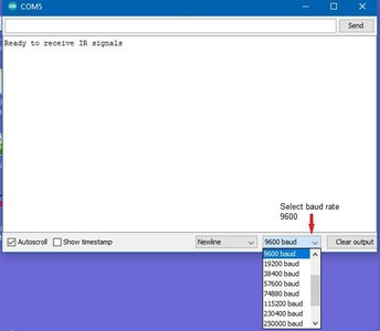

Step 8: Set Baud Rate
In the lower right corner of the Serial Monitor window there is a drop-down menu where you will select the baud rate being used by the Sketch. The “Dump” sketch is using a baud rate of 9600 so select this.
We now have something to look at so it is time to get some data and record it.

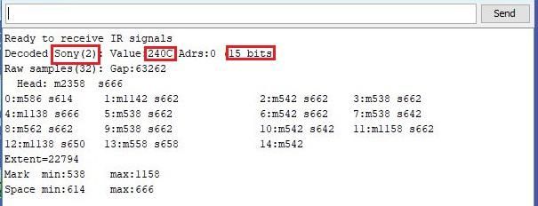

Step 9: Get IR Code Data
With the IR receiver setup as described, click on the Clear output button located to the lower right corner of the Serial Monitor window. It is important to have a clear monitor window to avoid confusion when recording the unique IR codes.
Using the remote that you want to clone, point it at the IR receiver and press the button for the function you want to program into your new remote. A lot of information will be displayed on the Serial Monitor screen. There are 3 data values sown on this screen that must be recorded. Refer to the screen shot above and take note of the items boxed in red. These are the data that will be used in YOUR new remote-control sketch. I suggest using the copy (Ctrl+c) and paste (Ctrl+v) function of the computer to copy the values from the Serial Monitor screen and paste them into a text file using any basic text editor. this technique should eliminate the possibility of errors.

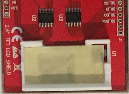

Step 12: Prepare the Arduino Pro-Mini
In this step you will solder the right-angle connector to the Pro-Mini as shown in the picture.
This connector will be supplied with the Pro-Mini and is the ONLY supplied connector to be used. The connector will be inserted from the component side of the Pro-Mini PCB. This connector is used to program the MCU. It can remain in place and still fit into the enclosure. If you want to modify the remote codes at some future time, the connector will be available as soon as you pop the enclosure open.

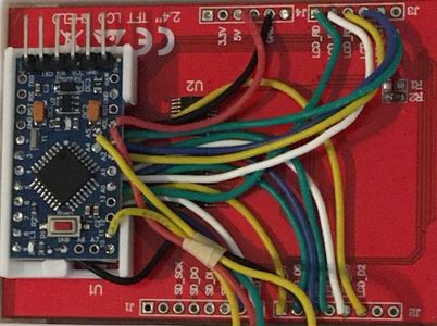

Step 13: Pro-Mini Wiring, Non-Component Side
There are a large number of wires that connect the Pro-Mini to the LCD display. Also, several wires will connect the Pro-Mini to other modules. To aid in assembly and keep the wiring compact, the Pro-Mini will be pre-wired with “flying leads”.
Using the wiring chart below, connect 70mm long wires to the NON-COMPONENT side of the Pro-Mini circuit board. You will need 14 wires 70mm long and one wire 90mm long. Use the 26 AWG, silicone insulated, stranded (multi-core) wire.
In this step all wires will be inserted into the contact holes of the PCB from the non-component side. Connect wires only to the contacts listed.
Note-Connect 2 wires into contact hole 3*

Step 22: Mount the Pro-Mini to LCD Display
With the Pro-Mini pre-wired with flying leads, it is time to make connections to the LCD display.
Start by taping the Pro-Mini_Mount (from the collection of 3D printed parts) to the display module as shown in the photo. The Pro-Mini_Mount straddles the SD socket and is taped to it. This holds it in the proper position.
Attach a temporary label to each of the flying leads and then place the Pro-Mini into its mount as shown in the photo for Step-23.
Note- The direction of the right-angle connector on the Pro-Mini must be positioned as shown in the photo.
Spread the leads out so the Pro-Mini PCB sits on the support rail of the 3D printed mount. If needed, use a piece of tape to help hold the Pro-Min in place.
Step 23: Wire the Pro-Mini to LCD Display
Refer to the Pro-Mini to LCD Display wiring chart and connect the flying leads from the Pro-Mini to the assigned contacts of the LCD display. Refer to photo for an idea of how to route the wires (I am sure you can do a neater job than I did). Trim the wires to a convenient length allowing a slight amount of excess to provide strain relief. The fit into the case will be TIGHT.
Wiring Chart Pro-Mini to LCD Display
Pro-Mini --------------- LCD
  • 9             -->        LCD_D1
  • 8             -->        LCD_D0
  • 7             -->        LCD_D7
  • 6             -->        LCD_D6
  • 5             -->        LCD_D5
  • 4             -->        LCD_D4
  • 3*          -->        LCD_D3
  • 2             -->        LCD_D2
  • VCC*    -->        5V
  • GND     -->        GND (70mm wire)
  • A0          -->        LCD_RD
  • A1          -->        LCD_WR
  • A2          -->        LCD_RS
  • A3          -->        LCD_CS
  • A4          -->        LCD_RST
*Note-Use one of the two wires connected to this Pro-Mini contact.
At this point your assembly should look like the photo above (hopefully neater).
Set it aside. The remaining 4 wires will be connected later.
Step 24: Assemble the Power Control Breadboard/PCB
Diagrams and photos show the placement of the various components that go into making the Power Control breadboard module. This is going to be a pretty big step but I trust you will find the diagrams and parts list helpful. Component placement when using a perf-board to build this module is the same as the PCB assembly. Use the PCB circuit traces diagram along with the schematic diagram to add the needed point-to-point connections on the perf-board. The components are positioned so that they match the 2.54mm hole spacing of the perf-board. If you choose to make your own PCB, I have included the artwork for the circuit traces I used in my build of the progrmmable remote. I used the "iron on" approach to transfer the laser printed traces on to the copper clad board. The pdf file has multiple images on a single page and should be dimensionaly correct.
Note- For convenience, the three capacitors and the four transistors, Q1 – Q4, should be mounted last.
First assembly step is to install the 8 resistors, 2 diodes and the jumper. (Jumper is next to Q1)
  • R1                          10K
  • R2, R3                   100K
  • R4                          330k
  • R5, R6                   22 ohm
  • R7, R8                   4.7K
  • D1                          1N4148
  • D2                          1N5817
 Next, install the three capacitors and four transistors (see the notes below).
  • C1                          0.1 uf
  • C2                          1 uf
  • C3                          3.3 uf
  • Q1-Q2                  AO3415-AO3400
  • Q3-Q4                AO3400-AO3400
Note- The two electrolytic capacitors, C2 and C3, are mounted to the breadboard/PCB with their leads bent at 90 degrees to maintain a low profile. Depending on the size of C1 that you use, it may also need to be mounted in a horizontal manner laying across the top of R2.
Note- The position of Q1 is next to R1 and the jumper. It is the AO3415 P-Channel MOSFET.
Note-If the perf-board you are using happens to be double-sided, put some tape between the perf-board and the backside if the transistor assembly to insulate the circuit traces of the adapter PCB.
The transistor assemblies should drop into the 6 holes of the perf-board/PCB. The adapter PCB should sit flat against the perf-board/PCB surface. Solder the 6 leads of each transistor assembly to the perf-board/PCB.
Step 25: Pre-wire the Power Control Breadboard/PCB
With all of the components mounted to the Power Control breadboard, we will add some flying leads to be used during the final assembly. Refer to the Power Control Breadboard assembly diagram and attach AWG 26 stranded copper leads using the approximate lengths indicated. They will be trimmed later.
Connection Point ------------  Length
  • PB1 & PB2                         50mm each
  • +Vin                                    130mm
  • Gnd                                    100mm (use pad next to Q2)
  • +Vout                                100mm
  • GND                                  100mm (use pad that is close to the 5.1V pads)
  • 5.1V                                   100mm
Note- The Pwr On/Off control circuit design (slightly modified) is courtesy of Mosaic-Industries.com

Step 30: Setup IDE for Pro-Mini
This time we will set up the IDE to work with the Pro-Mini CPU. The procedure is similar to that used when setting up the IR receiver. Refer to these screen shots and follow the steps listed below.
Using the IDE menu-
1) Select- Tools / Board: / Arduino AVR Boards / Arduino Pro or Pro Mini
2) Select- Tools / Processor: / ATmega328P(5V, 16MHz)
3) Select- Tools / Programmer:"AVRISP mkII"
4) Select- Tools / Port: / COM?
For the COM Port, replace the ? with the port number your computer is using to communicate with the Serial to TTL USB adapter.

The one area where editing the sketch could get tricky to understand is the “Protocol” portion (located immediately after the included libraries) so I will comment a bit more.
Manufactures of electronic equipment will create their own “IR codes” for controlling their equipment. It appears there is no universal standard to say, to turn “ON” a piece of equipment. So, the authors of the IR2lib library have invested considerable time and effort to understand and decipher the controlling codes used by many manufacturers (but not all).
Notice at the beginning of the sketch there is a list of “#include” statements. This is the area where you will specify the protocols needed for the IR controlling codes your remotes will be using.
Here are the 3 protocols I needed.
#include <IRLib_P01_NEC.h>
#include <IRLib_P02_Sony.h>
#include <IRLib_P05_Panasonic_Old.h>
The “NEC” protocol is used by my Vizio TV.
The “Sony” protocol is used by my Sony receiver.
The “Panasonic_Old” protocol is used by the Samsung cable box.
The protocols used by the remotes you are cloning might be different or you may need several more than the 3 protocols I needed.

Remove the adapter cable from the Pro-Mini and re-seat it into the 3D printed mount. If needed, use some tape or a drop of hot melt glue to help hold it in place.
Check the wire routing to make sure it will not interfere with closing the case. The space between the Power Control breadboard and the display will be very tight when the case is closed. It is a good idea to put a some hot melt glue over the push button to hold it in position. Also, if the MT3608 module appears too loose in its compartment you can add a bit of tape to the "bump" in the end of the compartment to keep it locked in place. Finally, the Power Control breadboard will need to be held in place using some hot melt glue on the side closest to the battery compartment.
The wires leading to the LEDs must be held close to the sides of the enclosure. I used some hot melt glue in the corner of the case to keep these leads from interfering with the Pro_Mini's reset button (notice the hole in the enclosure's bottom that gives access to the reset). Now it is time to connect the battery. Place a small piece of some sort of foam or spongy material on top of the battery to keep it from rattling in the case.
