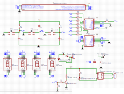

Introduction: PROGRAMMABLE TIMER WITH ATTINY85
HERE WE WILL SEE THE SCHEMATIC DIAGRAM AND ALL THE VALUES OF THE ELECTRONIC COMPONENTS USED FOR OUR TIMER PROJECT.
GERBER:
https://mega.nz/file/eRwA1Q5D#6HnrcAPaUwlRHEnMkTAI0cX6lRa_7LEuygl4qB_5niA
Step 1: SCHEMATIC DIAGRAM

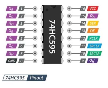

Step 2: 74HC595
INFO
The 74HC595 register allows converting data from serial to parallel format. It is an ideal chip to expand the digital outputs of our Arduino/Pic, 3 Arduino pins can easily handle more than 500 outputs. The 74HC595 is used in the construction of LED Matrix/Cubes, Relay management and more.
The 74HC595 internally has a shift register, a latch register, and tri-state outputs. The shift and storage registers have separate clocks. It has one serial input, eight parallel type outputs (8 bit) and one serial output (Q7S) to use registers in cascade and thus further expand the number of parallel outputs.
TECHNICAL SPECIFICATIONS
Chip: 74HC595
CMOS technology
Compatible with TTL voltages
Operating Voltage: 3.3V - 5V
16 pin DIP type packaging
Offset Frequency (max): 100 MHz

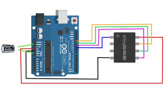

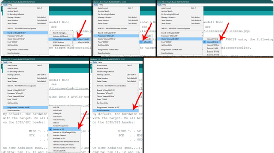

Step 3: BOOTLOADER ATTINY85
Ok, we have to burn a bootloader to the chi adn then uplaod the code. For both those steps we need the connections below to an Arduino. In my case I will use Arduino UNO. So, make the connections as below between the Arduino SPI port and the PCB. We will sue the Arduino as ISP to uplaod codes.

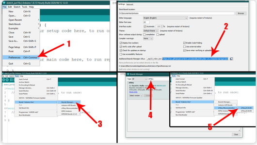

Step 4: Install ATtiny Boards
Run your Arduino IDE. We need to install the ATtiny85 boards in case that you don't already have that. To install the boards, copy the link below. Go to Ardduino IDE, to File -> Preferences -> Paste the link in the "Additional Boards Manager URLs". If you already have another link ther, add a comm "," first and then paste the new link. Save and close preferences. Now go to Tools -> Board -> Boards Manager. In this manager search for ATtiny adn install the attiny boards. Now, if you go on tool -> board, you should see the ATtiny boards as well.
https://raw.githubusercontent.com/damellis/attiny/ide-1.6.x-boards-manager/package_damellis_attiny_index.json

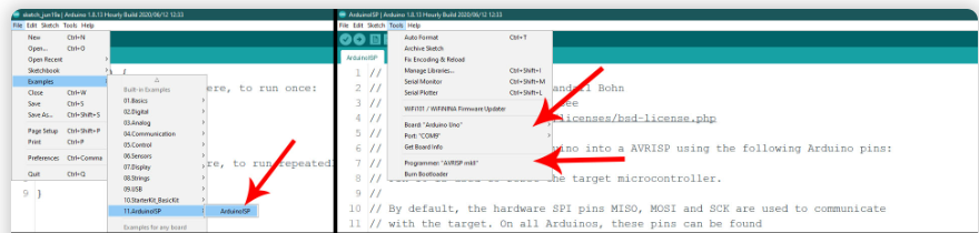

Step 5: Arduino As ISP
In order to use the Arduino as an ISP programmer, we need to uplaod a code to it so for taht, go to Examples -> ArduinoISP -> ArduinoISP and open that example code. Then make sure yous elect the type of board for your Arduino, in my case, Arduino UNO. Select the com and leave the default programmer as "AVRISP mkII". Connect the USB, select the COM and uplaod the code to the Arduino UNO.
Step 6: Bootloader Burn
Ok, now the Arduino has the ISP code so it will act as a ISP programmer. Now, let's butn the bootloader. Go to Tools -> Board and selectt the ATtiny25/45/85 type of board. Then, once that is selected, go to Tools -> Processor -> And select the ATtiny85. Then go to Clock -> and select the internal 8MHz one so we will burn that bootlaoder. Go to Tools -> Programmer and make sure you now change the normal programmer from "AVRISP mkII" to "Arduino as ISP". Finally, amke sure the Arduino UNO is connected to the PCB to the ISP port and go to Tools -> Burn Bootloader. The Arduino Rx/Tx LEDs will blink and after a while you will get the bootloader burn complete on the screen.

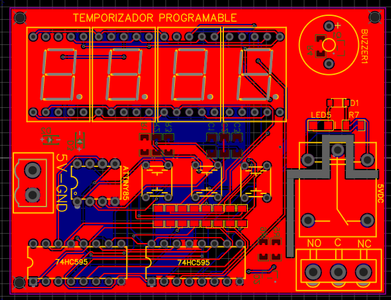

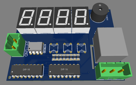

Step 9: EASYEDA
Once the project is finished with all the respective tests, we carry out the PCB design and we will obtain the routed tracks and the 3D image of how our finished PCB would look.
