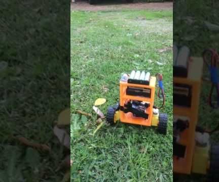

Introduction: PS2 Wire Controller and Arduino (control LEDs)
In this tutorial, I like to show my work on interfacing PS2 wire controller with Arduino through controlling LEDs on breadboards.

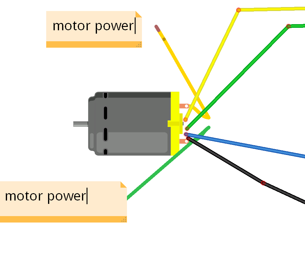

Step 1: Step 1 : Wiring PS2 Controller and Arduino
This is the part that took me quite a while, try to keep the plastic case connector and follow the wiring digram, in my case I cut the wire and lost track of the ordering or the wire label. But I figured it out in the end.
Here are my PS2 controller wire codes :
1 brown Data
2 orange command
3 violet vibration
4 black ground
5 red power
6 yellow attention
7 blue clock
8 ---- not used
9 green acknoledge
Hook up the connection between ps2 and arduion according to the diagram .
