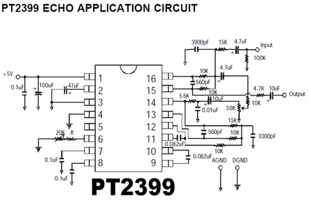

In this Instructables I am going to create a circuit using PT2399 Integrated Circuit (IC). This circuit is used to create echo sound or voice in our audio signal. This circuit can repeat sound. We can also change the number of repeats by a potentiometer and we can further change the delay time between these repeats. The star of the project is PT2399 IC. So let's make this Circuit!

Step 1: Pin-out and Block Diagram of PT2399 IC
PT2399 IC Description
The PT2399 is a single chip echo processor IC utilizing CMOS technology. Which accept analog audio input signal, a high sample rate ADC transfer the analog signal into a bit stream then storage to internal 44Kbit RAM, after processing the bit stream will de-modulate by DAC and lowpass filter. Overall delay time is determined by internal VCO clock frequency, and user can easy to change the VCO frequency by changing the external resistance. The PT2399 performs low distortion (THD<0.5%@0.5Vrms) and low noise (No<-90dBV) characteristic for audio purpose, and pin arrangement and application circuit are optimized for easy PCB layout and cost saving advantage.

Step 2: PT2399 ECHO Circuit
APPLICATIONS OF PT2399 CHIP
Step 3: PT2399 ECHO Circuit Diagram
