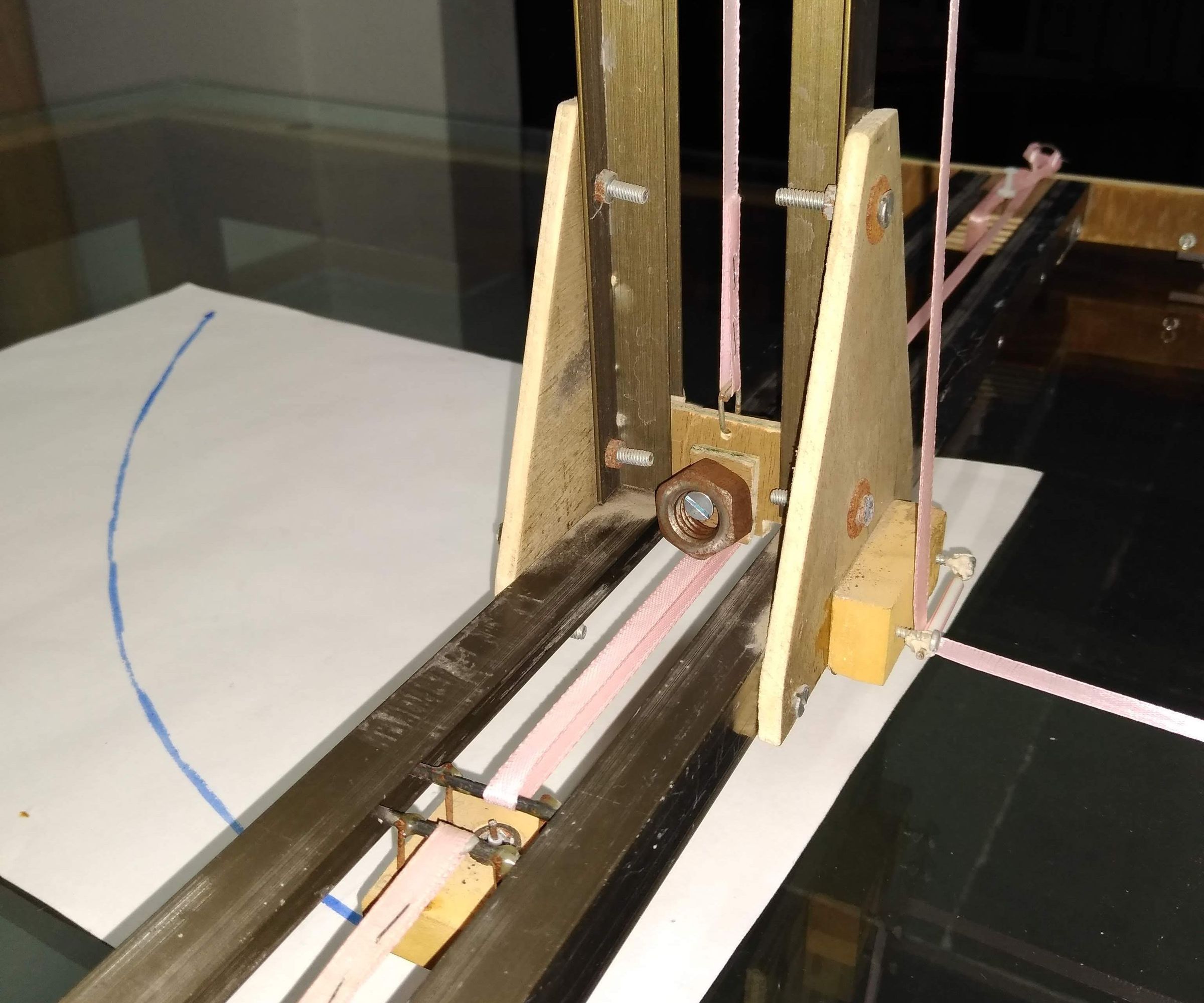

Step 12: Magnetic Steel Ball and O-Ring Joint :- Measurement of Magnetic Force (Step 2 of 3)
Measurement of magnetic force between magnet and steel ball with respect to their separation.
This measurement of the force vs separation is a one time measurement for a particular combination of magnet sizes, magnet strengths (magnet strength is given by grade like N-52, N-42 etc) and steel ball size. But once you have done this measurement for a particular combination, the readings and results can be reused for the same combination. For example in our case we will have to do the force measurements for two combinations- one for the shoulder joint and the other for the hip joint, since we are using different diameter magnets but same sized steel balls.
Things required:
- Two strong magnets called primary and secondary magnets.
- Steel ball of appropriate size (steel ball size and magnet size are given in the next step- 3 of 3)
- M.S nut
- Cord
- A plastic pouch that can hold about 1 L water, or if you prefer- Various Gram Weights generally available in a school or college lab (multiples of 10 gm going up to little more than 1/2 kg).
- Micrometer screw gauge.
- Measuring cylinder or measuring cup with volume markings.
- Paper or rigid plastic sheet pieces.
- Araldite.
- Any steel framework - for instance a M.S rack, iron pan etc.
- A large vessel like a saucepan or a tub.
Procedure:
- Please refer to the first diagram for the terminology used, and the video will give a quick overview.
- For the force measurement setup, refer to the second diagram.
- Stick the steel ball to the secondary magnet by Araldite.
- Magnetically stick the secondary magnet to a steel plate, for instance the bottom surface of a mild steel rack as shown in photo #3.
- Sandwich a few pieces of paper or card sheet between the steel ball and the primary magnet. These sheets determine the separation between the two. You may use a micrometer screw gauge to measure the combined thickness of the sheets. Note down this separation.This should be about a few 100 microns. Any thickness from 200 to 500 microns is good.
- Magnetically stick an MS nut at the free end of the primary magnet. Loop a cord through the hole of the nut for attaching weights, as shown in the second and third photo.
- Secure a pouch at the other end of the cord as shown in photo #4.
- Gradually pour water from a measuring cylinder/ cup into the pouch using a funnel (photo #5 and #6) till a point when the magnetic joint between the primary magnet and the steel ball will give way, and the primary magnet will fall.
- Make sure there is a vessel kept just below the pouch to capture the falling magnet, nut and pouch containing water. Ensure that no water gets spilled from the pouch when it lands in the vessel, by selecting a suitable small mouth pouch and by placing the vessel just below the pouch.
- Note down how much water was poured. This should be recorded corresponding to the separation reading that was done in a previous step.
- Restore the setup, but with one sheet of paper/plastic removed from between the primary magnet and steel ball. Measure the new total thickness and note it down. Data could be tabulated as shown in photo #7.
- Repeat the steps from 8 to 11 to get various readings of force vs separation. Finally include a reading with no sheets placed between the primary magnet and steel ball, corresponding to zero separation.
- Plot the force vs. separation graph which will look as shown in part (b) of second diagram.
- From the plot, determine the attractive force between the magnet and ball corresponding to a separation of about 50 to 60 micron.
- This value of the force will be required in the next step (step 3/3). Call this force or weight 'R'.
- For the shoulder joint the 'R' that I have obtained from the measurement is 470 gm weight, and for the hip joint I obtained an 'R' of 500 gm weight. The measurement data I got and the sizes of the primary and secondary magnets and the steel ball are given in photo # 7 and also in next section titled 'Step 3/3: Joining the parts'. In photo #7 the data is marked red. It is possible that you may get either the same 'R' or different, depending on the grade of the magnet you use.
At the end of this procedure you may realise that since we only need one reading of the magnetic force corresponding to a single separation of about 50 - 60 micron, so you may ask why do we need to measure for other separations. The answer is that the slope of this graph is also important. For stable equilibrium condition, this slope of the magnetic strength graph (its magnitude) should be less than the slope of the O-Ring compression graph.

Step 15: Joint Tightness Measurement
The strength of the various large joints was characterised by how tight these were in resisting an applied moment or torque. The moment is measured in units of gm cm instead of N m (which is the SI unit) only for convenience. For measuring the maximum moment, a weight was suspended on the lever arm of the joint at some distance from the axis and the point where the lever arm just gives way to the applied load was noted (Refer to the Photograph). Moment = force x lever arm. As a thumb rule- larger the ball, proportionally more is the resisting moment (or torque) it can exert, for the same frictional force. These are the typical values of the maximum resisting moment for the various joints.
- Magnetic Ball and O-Ring joint (MBOR):- 140 gm cm (for hip joint), and 60 gm cm (for shoulder)
- Knee joint (O-Ring and Bead joint):- 300 gm cm
- Ankle joint (V cut PU tube)- 220 gm cm
- Waist joint (V-cut PU tube)- 550 gm cm
- Wrist joint (V-cut PU tube)- 70 gm cm . This is shown in the first photo. The nuts have a total mass of 20 gm and their collective center is 3.5 cm from the bead's center. Hence 3.5 cm is the lever arm.
The second photo shows how the masses of small objects were measured. It is a well known pan balance technique. The coins are used as reference masses and the unknown mass is found using principle of moments-
m1 x d1 = m2 x d2
