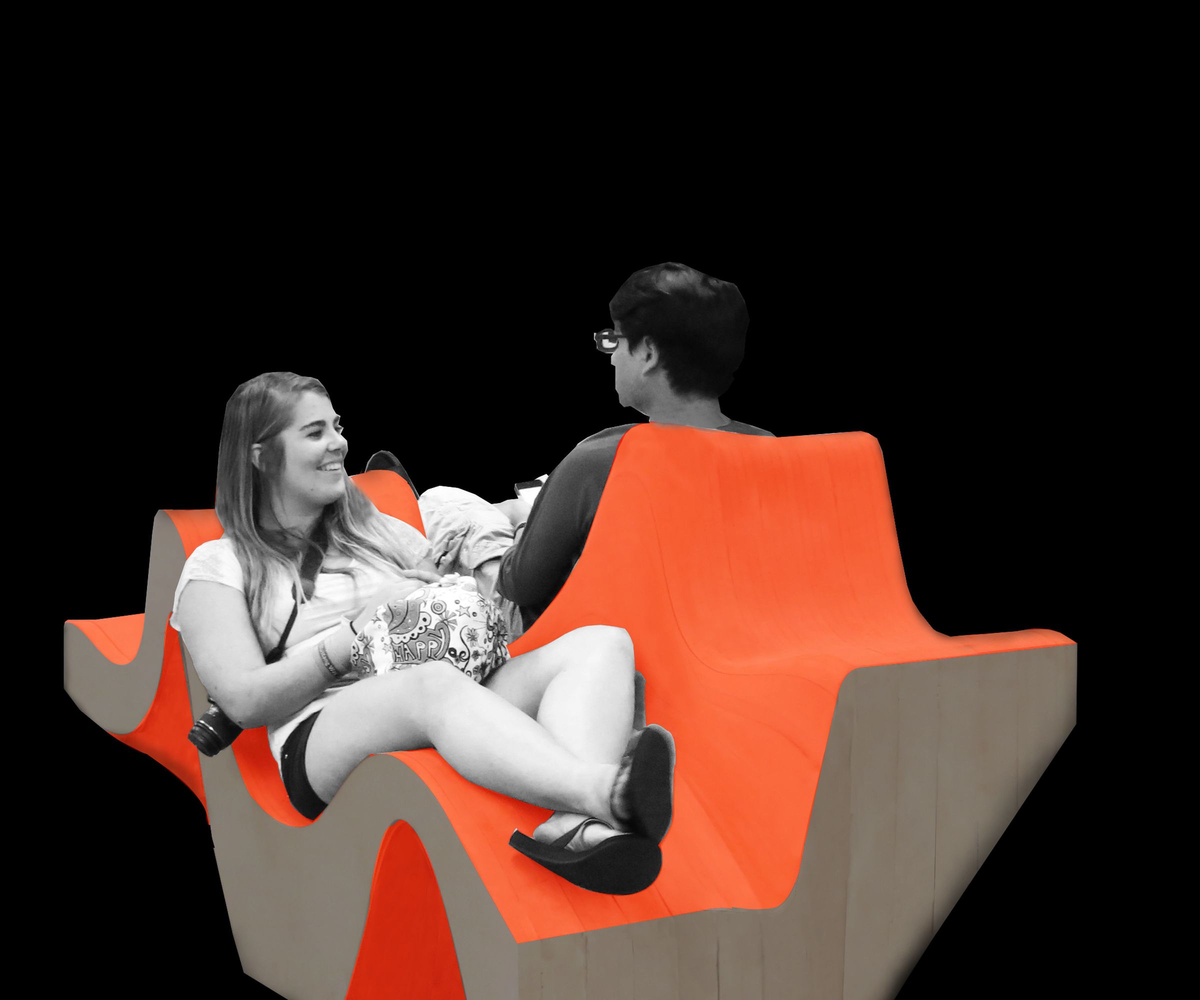

Introduction: PULSE - Social Seating Structure - Market Street Prototyping Festival 2016
Amidst the vast sea of stimuli that surrounds us, Pulse sets a stage for spontaneous social interaction. Each new encounter provides us the opportunity to interpret the world through fresh perspectives, and gain newfound personal clarity. Inspired by the curves of the human body and the steady flow of the city, the close proximity of each seat erodes at personal spheres - welcoming a new, more socially connected outlook; Pulse aims to reunite community.

Step 1: Modeling and Slicing
The seats follow the curves of the human body and accommodate a large range of body types and sizes. The four spots are offset and placed at different heights to give the illusion of totally separate spaces, however by closely unifying them strangers voluntarily enter one another's personal space. Each spot's comfort puts users in an open and vulnerable position; prime for a deep and meaningful conversation. The lounge seats are distanced at the optimal range for gazing and fully seeing their counterpart.
I sliced the 3D model at one inch increments including 1" holes for dowels for alignment. I also included 1/8" plywood panels on all flat surfaces (sides and bottoms) and two more in the middle for reinforcement. In the future I might recommend going to a 1/4" thickness on these components. I wanted to keep the weight down so I went with a thinner plywood, and hollowed out the two middle plywood pieces. The final weight was roughly 300 lb.

The piece was a great success on Market Street and truly did foster interactions between strangers!
