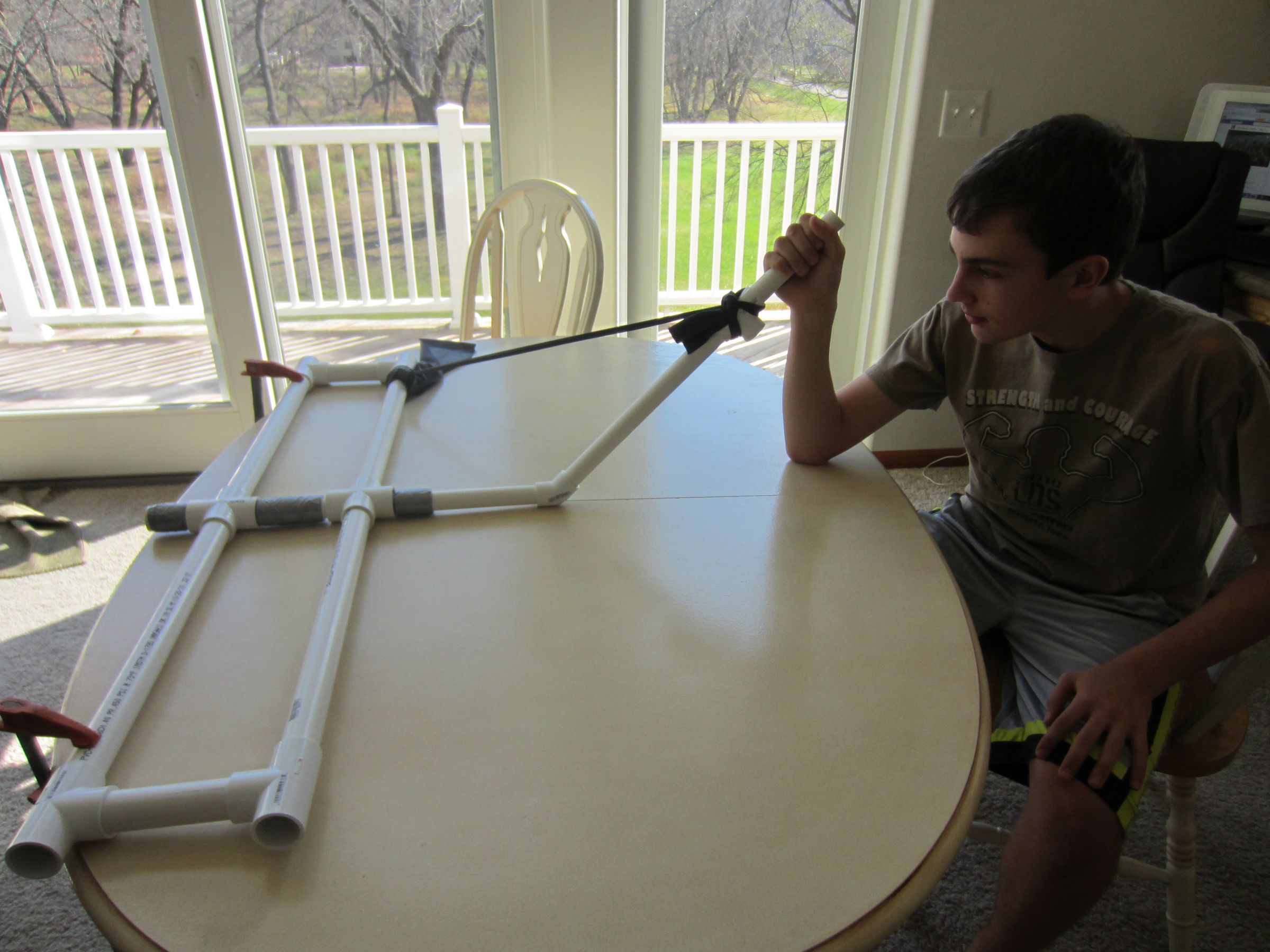

Step 1: Making the Frame
Using your PVC cutters, cut about 4'' off two of the four PVC pipes and then connect the two 9'8'' with two elbow connectors. Do the same with two of the 10' long pipes (you may want to duct tape the elbow connectors to the pipes so they won't slip). Attach the two pieces together by taping their points to each other. This will make the kayak curve up which is good.
Cut two 8'' pipes out of the 10' pipe. Put them at about the center of the kayak at opposite sides and then connect them to the rest of the frame with two T connectors each. Out of the 8'8'' pipe cut two 2' pipes and use four T connectors to put them at about equal distances from the 8'' pieces on the the bottom part of the kayak (the part that curves up). From the 4'8'' cut two 1'6'' pieces. Use T connectors to put them on opposite ends of the kayak at points where they fit snugly.
Tips: When using the T connectors you will need to cut the pipe and you may want to tape the connectors to the pipes so it won't slip. Also it would be a great idea to look at the picture so you can see where things fit.
