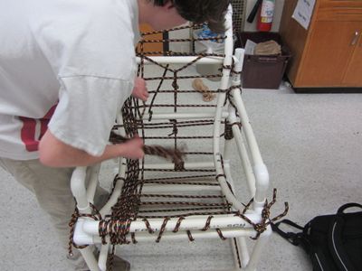

Step 4: How to Physically Put Chair Together
The first sub assembly was the bottom structure with the foot rest. We started building the chair with square that connects to the bottom of the foot rest. The picture that shows the foot structure on corner has dimensions of two 4 inches on the top and bottom. The top 4 inch piece connects to a cross side outlet and 90 side outlet. The bottom 4 inch piece connects to a 90 side outlet and a T side outlet.
The rest of the bottom structure sub assembly is composed of 22 inch pieces and 8 inch pieces.
The first level of the structure is composed of 22 inches. The big square is the foundation of the whole chair. There are 5x22 inch pieces on the bottom. To complete the structure on the bottom there is the square structure that was previously explained.
The long pieces on the second level where there are 5 pieces of PVC pipe are all 22 inches in length. They get connected with T outlets, T side outlets, cross side outlets, and the 90 side outlets from the square in the footrest.
The second sub assembly is a lot simpler than the first. The pieces are made up of pieces that are a foot long in height. This may not seem like a lot but attaching these pieces to the first sub assembly that includes the bottom structure then it makes a total height of 21 inches. This 21 inches includes the pvc connector pieces. The 3rd and 4th picture illustrate this fully.
The 12 inch pieces connect to another square that sets up the opening for the seat. These 12 inch pieces get connected with T side outlets for the back 12 inch pieces and 90 side outlets for the front. See the 5th picture
the rope shown is for the seat where the butt goes.
Since there are arm rests in the chair the square that connects to the 12 inch pieces has different measurements on the sides than it does for the front and back. The front and back pieces of the square are 22 inches. The side pieces of the square are 20.5 inches. These 20.5 inch pieces get connected with 2 inch pieces on the side. These 20 inch pieces get connected to the 2 inch pieces with T side outlets. The 2 inch pieces get connected to the 12 inch pieces with 90 side outlets. See the 6th picture.
The arm rests and pipe that'll let the back structure pipes rest on. The arm rests are 20.5 inches in length and have an elbow piece in the front and a T outlet in the back. The T outlet in the back is made up of 2x4.5 inch pieces. The top 4.5 inch piece has a T outlet that has a 22 inch piece jetting into it. This 22 supports the back structure bent PVC pieces. The final four pictures illustrate this.
