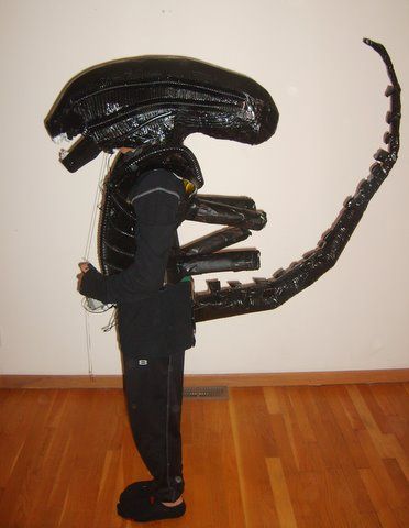

Here's a handy trick I used in this years Halloween costume. I needed to attach items (and detach) items to PVC tubes (schedule 40). Gluing was not an option.
It's a little difficult to describe but easy to see. Portions of the Halloween costume below where foam-core meets PVC on the chest harness were attached using this homemade clip. This costume build and some other PVC mechanisms including a rotating hinge and linear joint is described in creatrope.com's general grievous costume.
To make a clip you need you the thin-wall version of the PVC tube. There's a thick-wall and thin-wall version - the thick will is usually my base for 'structural' elements, but the thin-wall makes a nice clip and is lighter.
